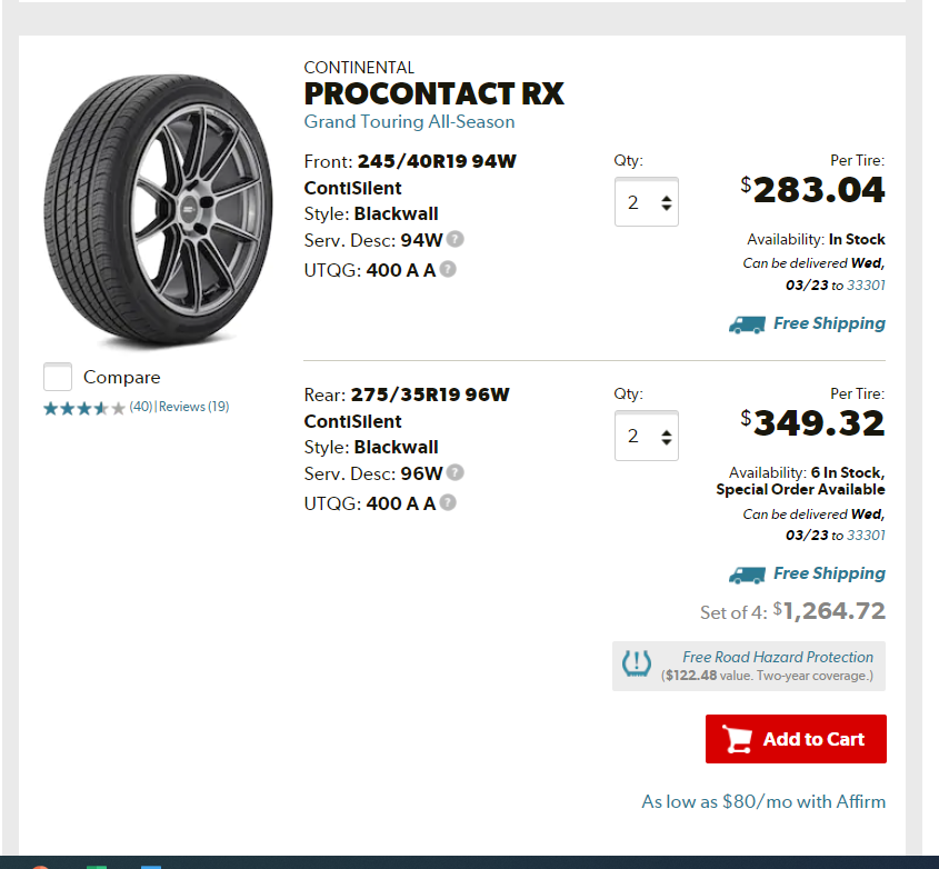

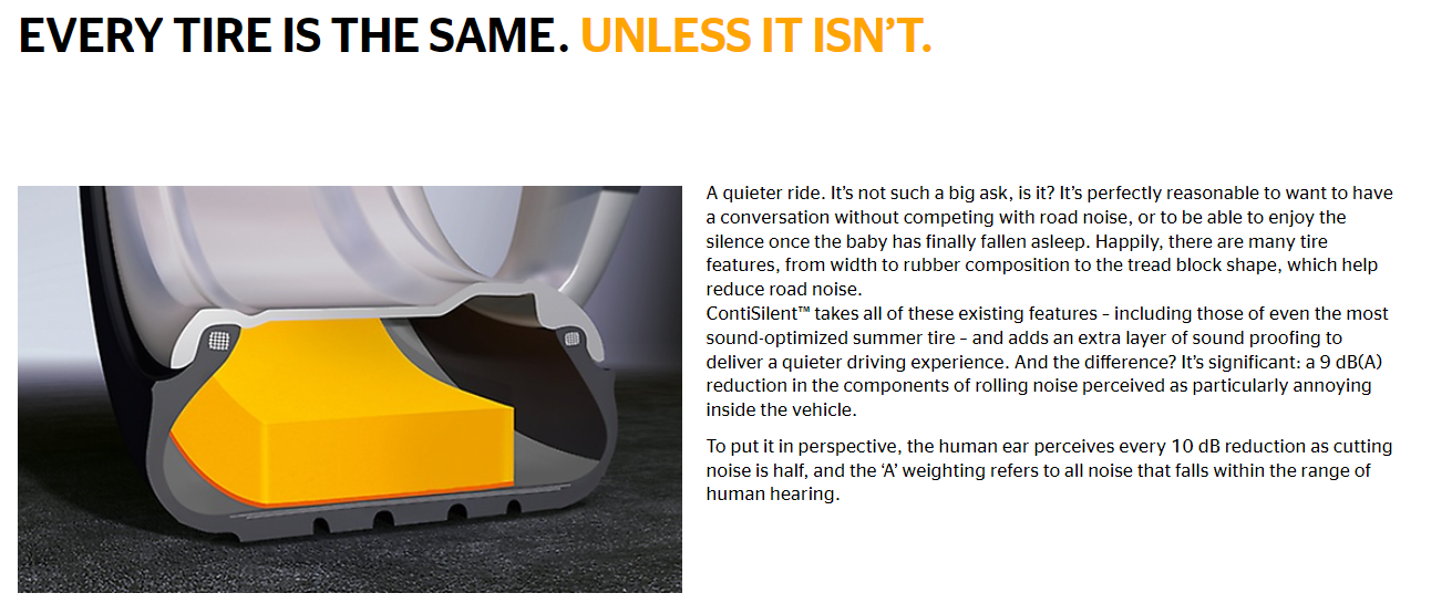

This type may be only new to me, but with the XK's tendency for road noise, it may be an interesting buy.
It's called ContiSilent, and claims to drop road noise by 9dB, which, if you remember your physics class, is almost reducing generated tire noise by half.
About a 8% premium over a non-Contisilent comparative by the same manufacturer.
Has anyone tried them? Know anyonw who has?
Thanks

If you compare the tires on Tire Rack to the other Continental tires, the DWS06+ seems to be higher rated in almost every category, and is currently cheaper. The load/speed rating is higher on the DWS tires which interesting. I have the old DWS06 tires, and the noise is much better than the Bridgestone tires I replaced.

Ugh... these look like runflat tires as well (much less likely to be repairable if punctured) :
https://continentaltire.com/tires/procontact-rx
Even the ratings on the Continental site are pretty bad.

My Buick TourX came with the Conti-Silents.... In Jan at 42k I had to replace them as a chunk of foam dislodged and the tire wobbled like it had thrown all of its balancing weights. Scary at speed.
I replaced the TourX's with Conti's ProContacts... In the two months of ownership and a roundtrip to Florida, I don't notice any difference in sound. Zero.

Checked with Tirerack because neither page said runflat. They said neither the RX or TX in my size are runflats. Directed to the Conti URL you posted, the rep said some sizes are runflat, but not the sizes XKs use.
But between the apparent fragility of these in Tirerack reviews, and Scott's review of problems as well as no audible difference in noise plus foam delamination, above, I've got a good enough answer to pass on them.
I'll stick to the Extreme Contact 6 when reshoeing comes around.
