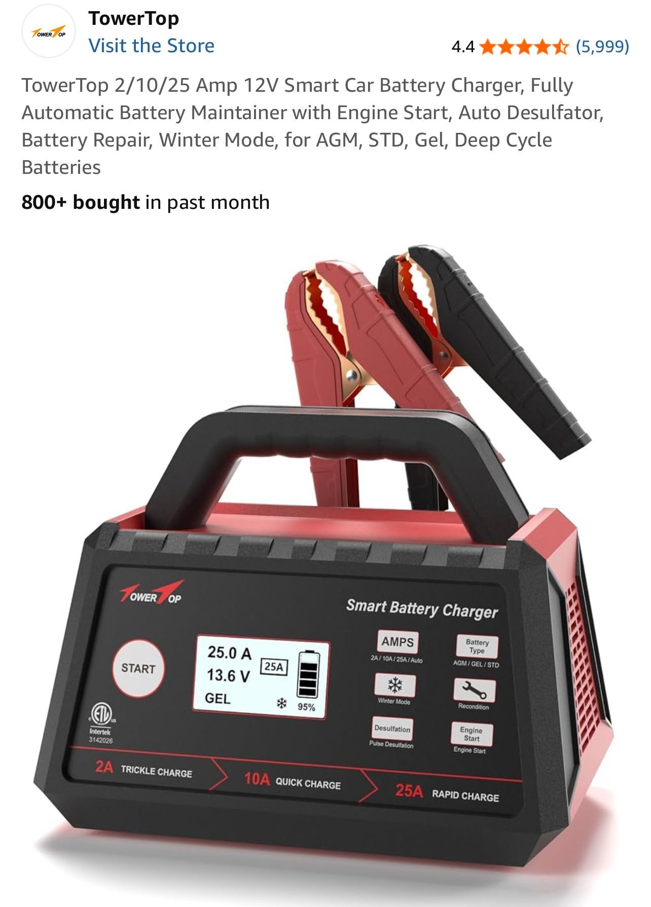

Originally Posted by TraxtarXKR
I'm having this same issue in my 2012 XKR... I noticed my android phone suddenly didn't pair, and when I went to the phone screen from the main menu, it says ""would you like to search for a new phone now?" And a single button that says "YES", but selecting it does nothing............ Maybe I should search for something else?
Before anything else, check your battery voltage after sitting for several hours. It HAS to be 12.6 volts or more. If not, you can try to charge it with an actual CHARGER of 10 amps or so until it finishes. Trickle chargers or maintainers won't cut it.
Also, doing a Hard Reset sometimes fixes a lot of electrical issues.

Originally Posted by Cee Jay
...you can try to charge it with an actual CHARGER of 10 amps or so until it finishes. Trickle chargers or maintainers won't cut it.
I have a NOCO G7200 charger... Are you saying that's not a recommended product?

If I end up getting the car I’m looking at getting this one.
https://www.crutchfield.com/S-OxdZbl...OCO-G7200.html
For using as a maintainer that one is great. To do the heavy lifting when a battery is quite flat it isn't ideal since the maintainer types lower the output by a lot for the top whatever percent of charge. They just aren't made to CHARGE a battery, just do the last bit safely and reliably.
