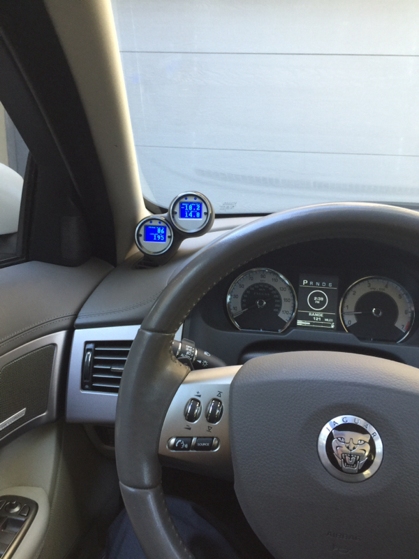

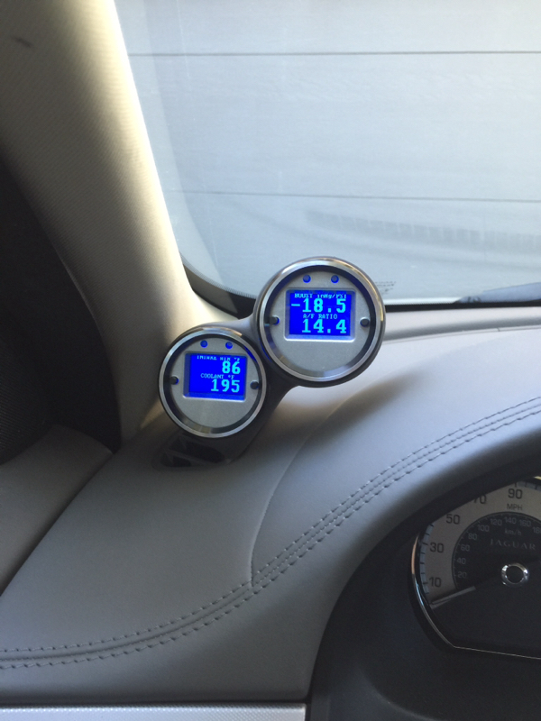

Here are mine. I started a thread in the XF side. By buddy makes the pods and I used the Aeroforce gauges. They read 30 different perimeters. I have them set up to read two per gauge. Boost, AFR, Coolant, and Intake temp.

Thanks chXFS. I went to the other post There's some pics of the single pod, no double pod as you have above and no mention in those posts of the cost of the dual pods. The gauges are pricey, but there are several options there. I prefer the glowshift as the color scheme is more in line with Jaguar instruments (green light on Black) in the case of my car.
What does your friend charge for the vent mount dual pods?

Hi chXFS, are your gauges obdii or 'mechanically' driven? Any issues with running the wiring? I would love to see the backside of the gauges to get a sense of the over all look of the pods. Seems like a nice set up.

I know the gauges are pricy but they read 30 perimeters and you can scan your car for codes and clear them as well. I noticed you mentioned you want to match your green interior lights. They do offer my gauge in green. A single pod will cost you $85.

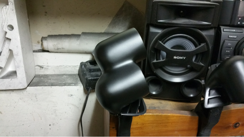

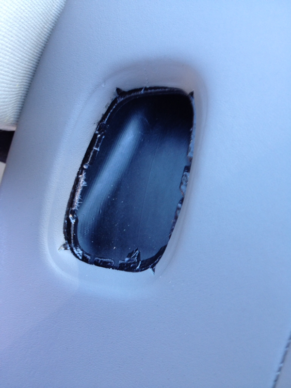

My gauges are OBD2. No issues running the cables. Remember, you would have to send him your vent and he will mold the pod to it. So all you do is run the cables down the hole were the vent was and plug the vent back in with pod attached and your done. Now all pods come back black. So to give you an idea my dash is Oyster, so I ordered Oyster leather dye and took to Lowes and had them make into a paint. Then I used a aresol kit to spray the pod the color of my dash. It came out OEM. Here are a few pics so you get the idea.

Thanks for your quick response chXFS. I have my car up on my storage lift with the bumper off as I'm waiting for an updated front grille. Over the next few days when I have some time I will set it down and poke around the interior of the car. I would still like the gauges on my A pillar but need to determine how the cable routing will work for the pillar. I went to the XF site and noticed that there is an email add for the fella who does the pods. I think I will send him a note to see if he may be interested in moulding the pods into my spare A Pillar. Good to know if I may have a choice between vent and pillar. Thanks for the pics.
