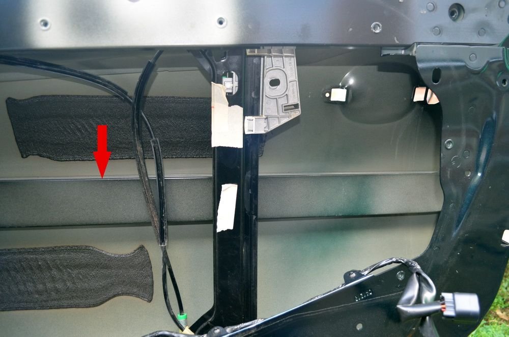

I went to see my vehicle in the bodyshop but unfortunately it was already primed when I arrived. I'd like to have seen the bare metal.
When I had the driver's door panel off to repair the door handle, I wasn't too impressed with the surface protection on the inside The horizontal edge of the reinforcement was bare metal and the remainder of the coating not very thick.
