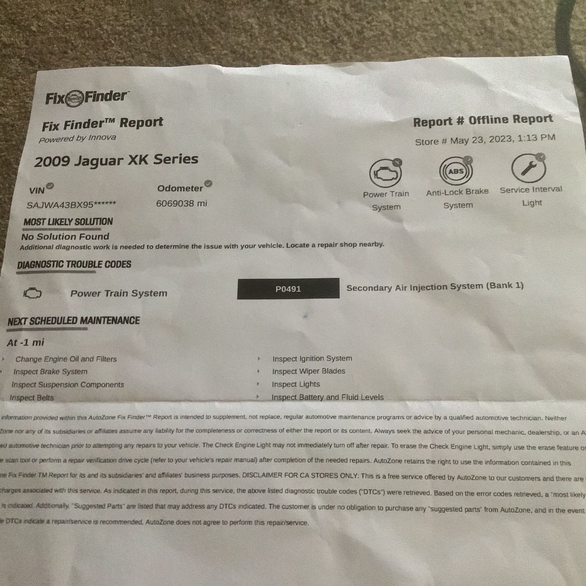

I went to a local parts house, Advanced Auto, and they plugged their code reader into the OBDII port.. it reads:
”PO491- Secondary Air Injection System ( bank 2)”

Old Jun 28, 2023 | 03:27 PM

Old Jun 28, 2023 | 05:24 PM
NBCat's Avatar
Posts: 6,068
Likes: 2,983
The DTC is P0491, not PO491.
Not sure about the accuracy of that paper as it also shows the vehicle mileage as 6069038.

There is no doubt you had a code that triggered the MIL but I question the compatabilty of their code reader with the X150 and consequently the accuracy of the reported code. Clearing codes is the nuclear option for turning off the MIL. If it doesn't come back on (normally after 2 "trips" if the underlying fault has not been rectified) then no need to be concerned. If it does come on, you need to consider a Jaguar diagnostics (SDD) session or re-check with a known compatible reader.
