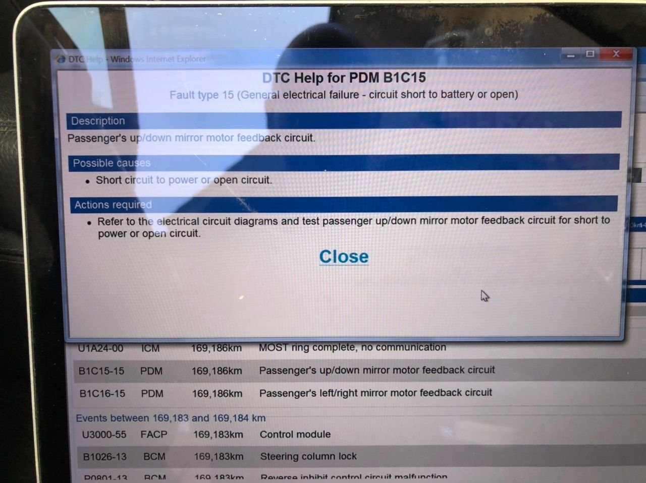

Powerfold mirrors and SDD?Hi just a little update on trying to fix this niggle, no reverse passenger mirror tilt and passenger mirror not staying in memory, yes i know i should just leave it alone 😂 reflashed door module with SDD and that didnt fix it, error codes in pic below.Tthink i need to get me meter out and test the continuity of all the wires, says short circuit, which would make sense with powerfold mirrors goin in and out all the time flexing the wires? Anyway a while back i see a secondhand mirror and asked breaker if its a powerfold? Asked if they could just pop off the mirror send me a pic and its easy to tell internally. They were too afraid to break mirror 🙄 and sent me vehicle VIN to look up and find out?? Just tried it in SDD and it comes up with the usual build specifications, but even with my VIN which i do obviously have powerfold mirrors it doesnt say in specs list, lists many other options etc like heated screen, TPMS, accessory module etc but no powerfold mirror option which i thought was an option on early cars??? Any of you guys know if i can see this anywhere else in SDD or it is only by internal view of mirror. Are there differences in how many wires/plugs ?? As wasnt electrochromatic mirrors an option aswell?? (I have them aswell) I know i can find all this out wen i open up the door card to go probing wiv me meter, but any advice welcome beforehand thankyou
