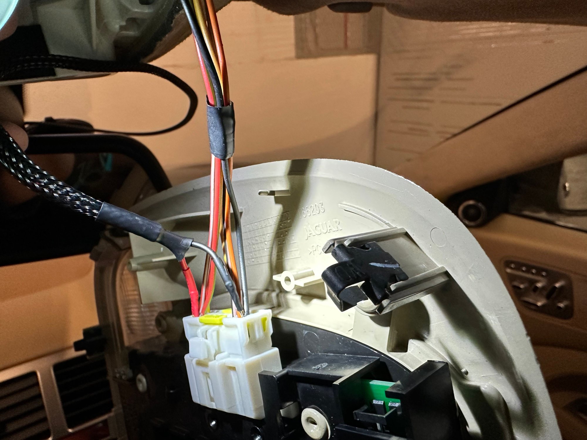

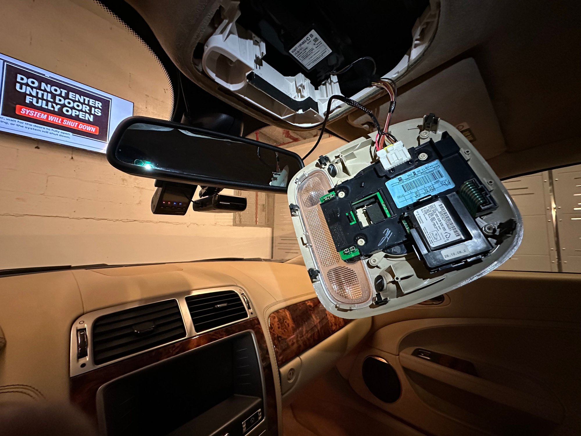

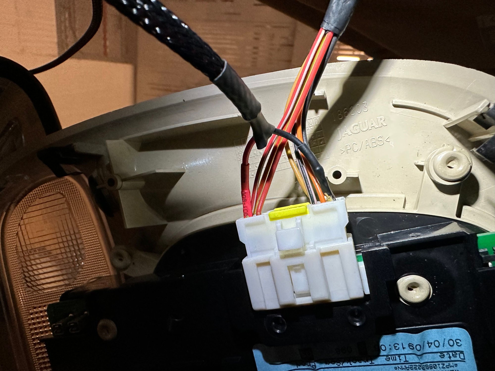

Just hardwired a radar detector so thought I would share some pictures
first buy a rj11 radar detector hardwire kit. I bought this one on Amazon: https://a.co/d/5u6niYY
I have a Uniden r3
next, use a interior pry tool on the dome light assembly starting from the part closest to you. Pull down. It’s just held on by pressure clips.
next, draw power / stick into the red and white wire all the way to the left and ground on the black wire all the way to the right. You want to very carefully stick in the metal prongs into the receptacle of the wires. It should fit nice and snug. Dont force it. It should feel kind of like a fuse going into place but with 1/4 of the pressure.
This is ignition powered so it automatically turns on and off when you turn on off the ignition
I use small zip ties to make sure the wires don’t move
push the dome light assembly back in place
Done!
one thing to note, the dome light assembly is grounded to the chassis, so it has to be put back into place before power will be sent to the radar detector. So if you are testing, make sure to put it back into its spot before doing so

I’ve noticed something strange after the install, the power wire is actually tied to the lights. So if you have the headlights off, then it won’t send power to the wire. I am unable to find a wire that is purely connected to the ignition. So now I am just using the light switch on the stalk as an on off switch.
I hardwired my radar detector to the rain sensor which is behind the mirror. The black cover is easy to prior open (start at the bottom closet to the windscreen). The rain sensor connector is a 3 wire connector. On my car ground was black, and the switched live was green and white wire. The wires you need are the 2 wires at the opposite ends of the connector.
