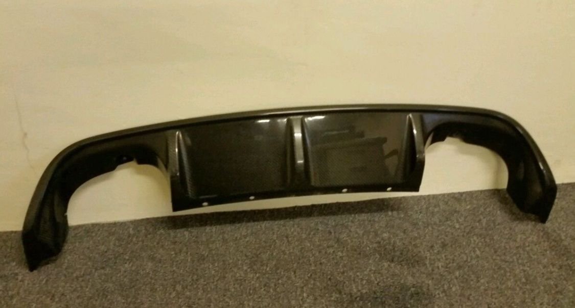

Next project… I bought a carbon fiber rear diffuser from Chris at Mina about 6 years back. I’m just getting around to finally mounting it. The factory diffuser has tabs on the back side that slide into the rear bumper which has corresponding slits/cut outs. Mine does NOT have these attachment tabs. Chris initially suggested using 3M double sided automotive tape. This does not seem sturdy nor permanent. Any collective ideas on how to get this accomplished?

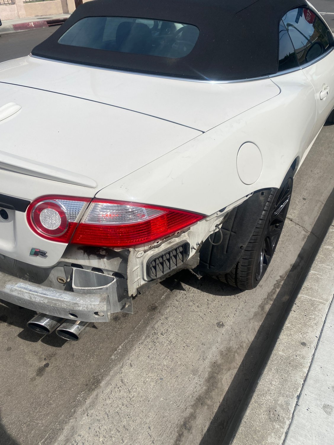

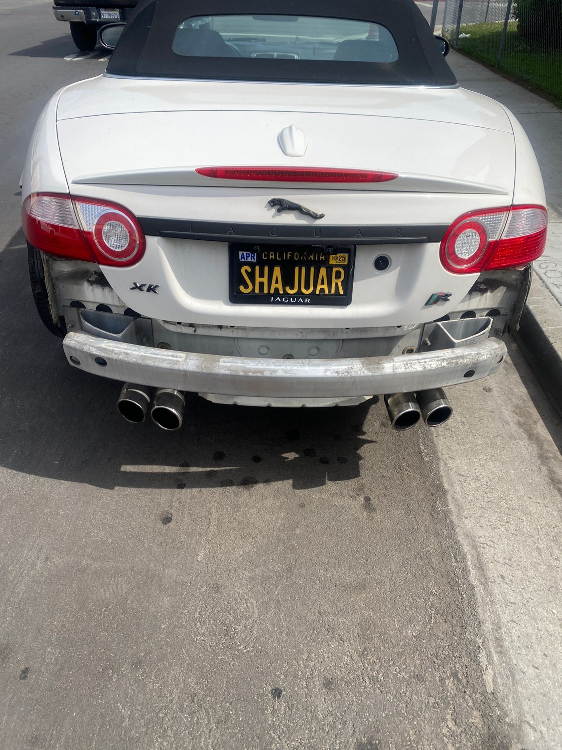

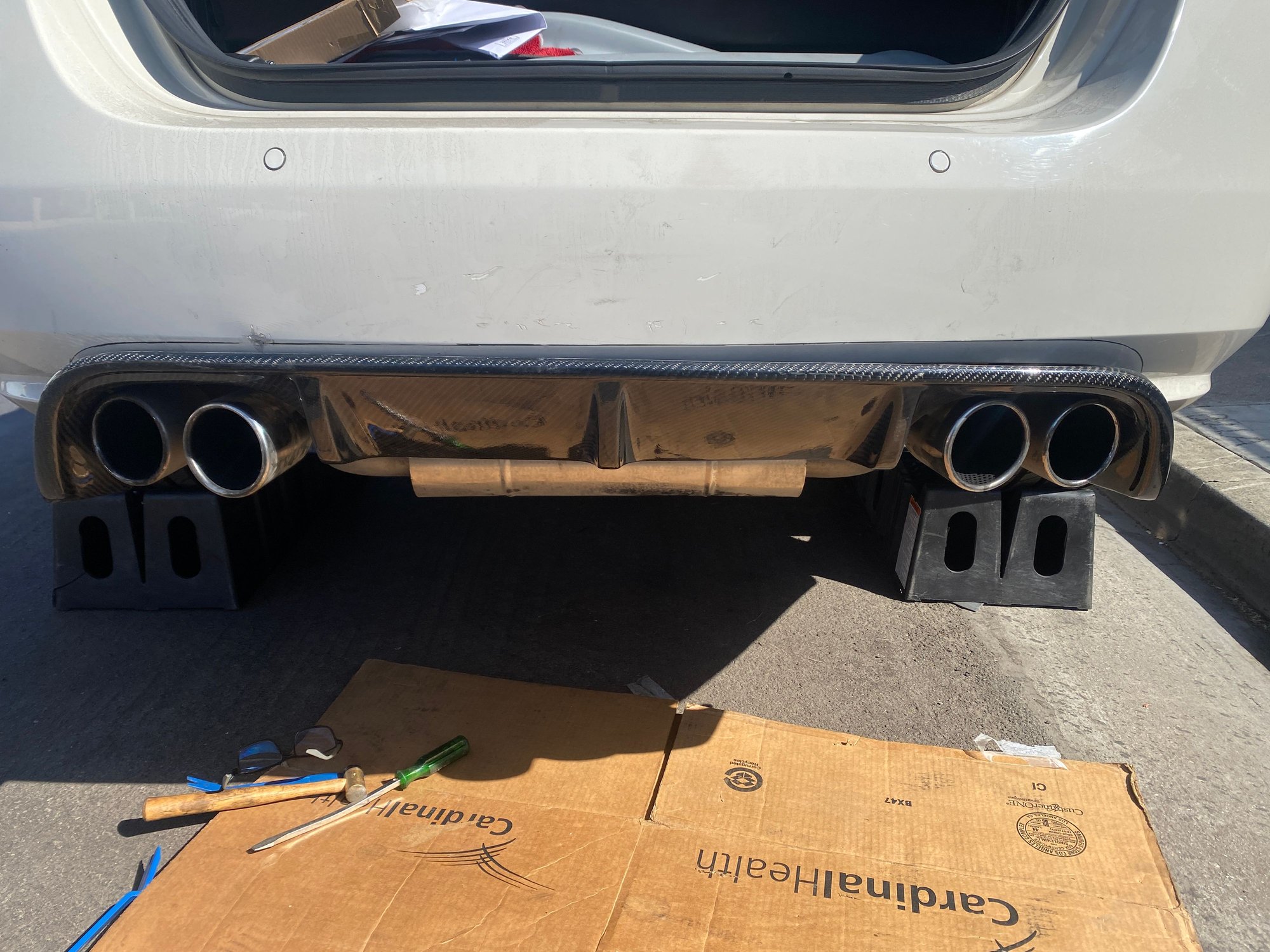

It has begun…
Old Feb 28, 2025 | 03:59 PM
badicedog's Avatar
Joined: Mar 2019
Posts: 479
Likes: 143
Old Feb 28, 2025 | 04:00 PM
badicedog's Avatar
Joined: Mar 2019
Posts: 479
Likes: 143
Although not factory part, all the mounting points line up. Minor fitting is needed

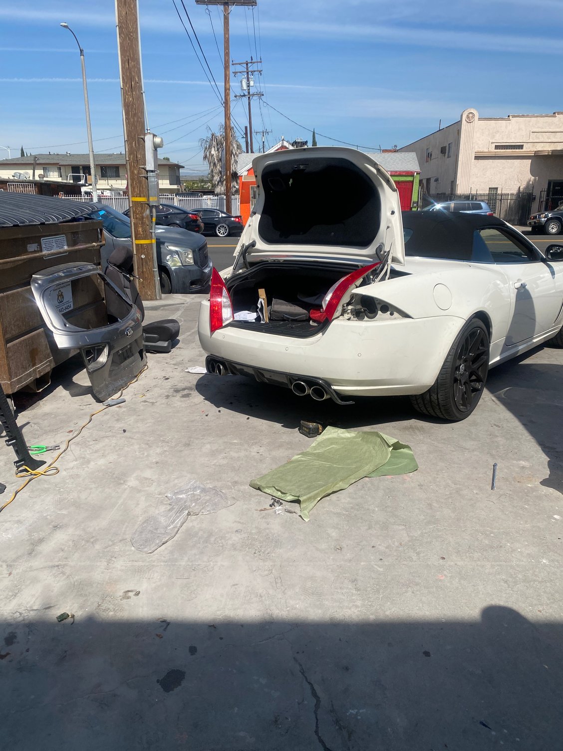

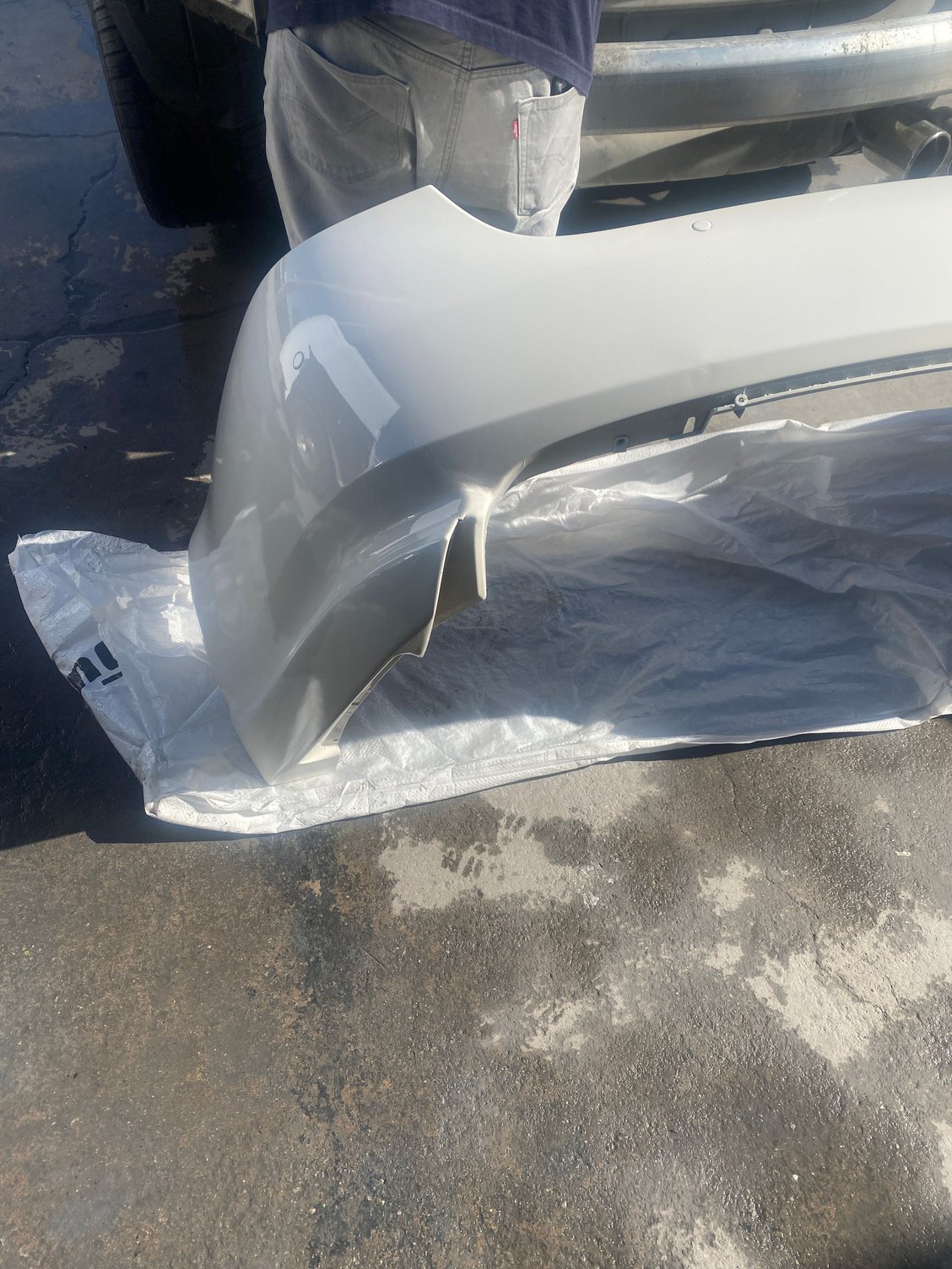

Bumper cover off and off to figment and paint of rear ground effects end pieces and complete bumper
Bumper cover off and off to fitment and paint of rear ground effects end pieces and complete bumper

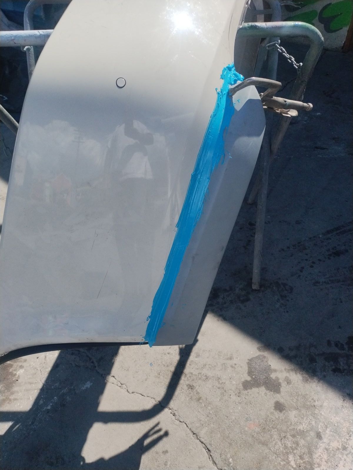

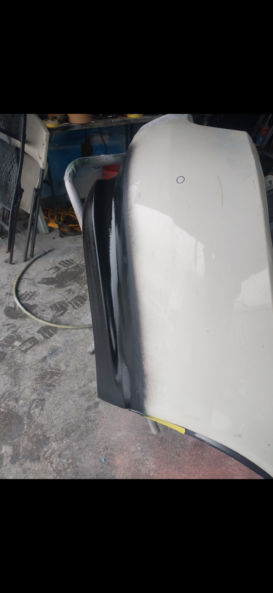

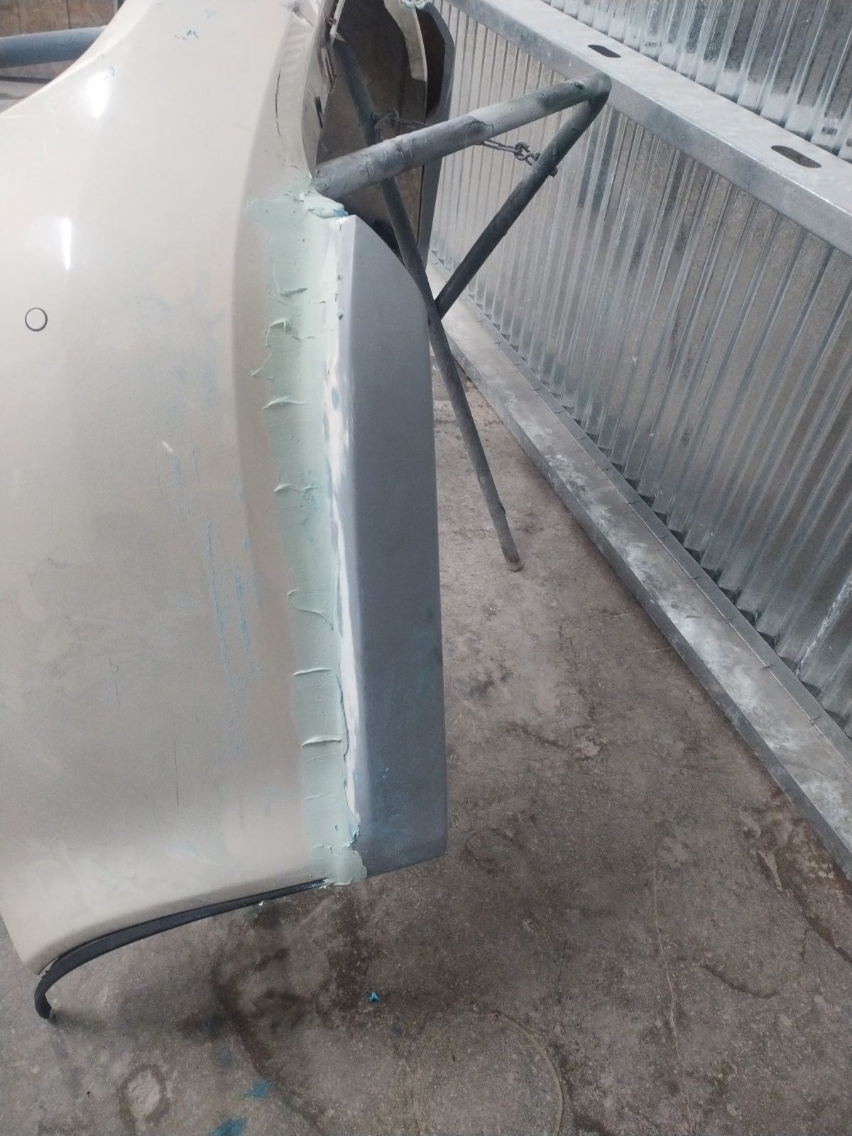

Slow progress… used panel bond to attach end pieces to rear bumper.
Old Mar 13, 2025 | 05:03 PM
badicedog's Avatar
Joined: Mar 2019
Posts: 479
Likes: 143
Takes 48 hrs for the panel bond to cure. Then prep for paint and re install bumper

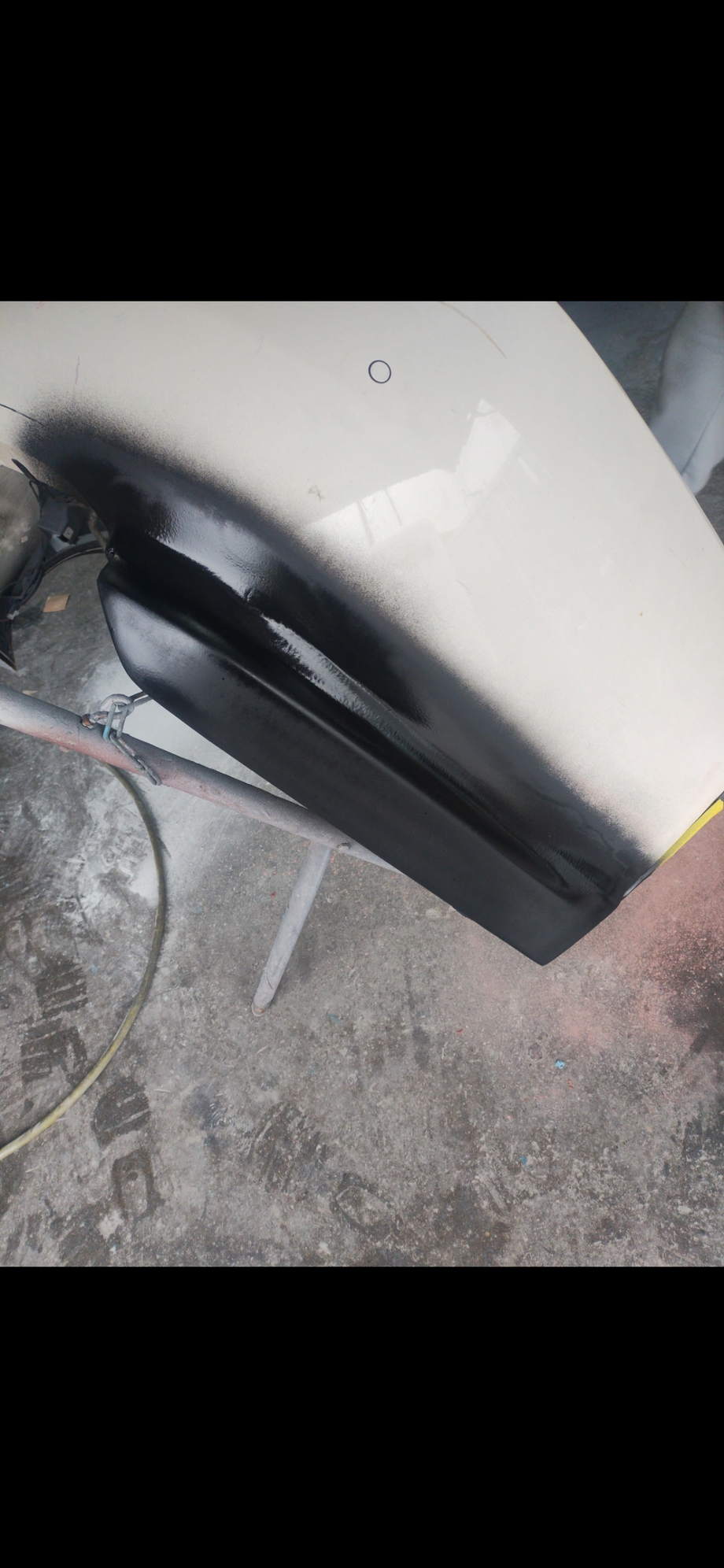

Sanding and primer done

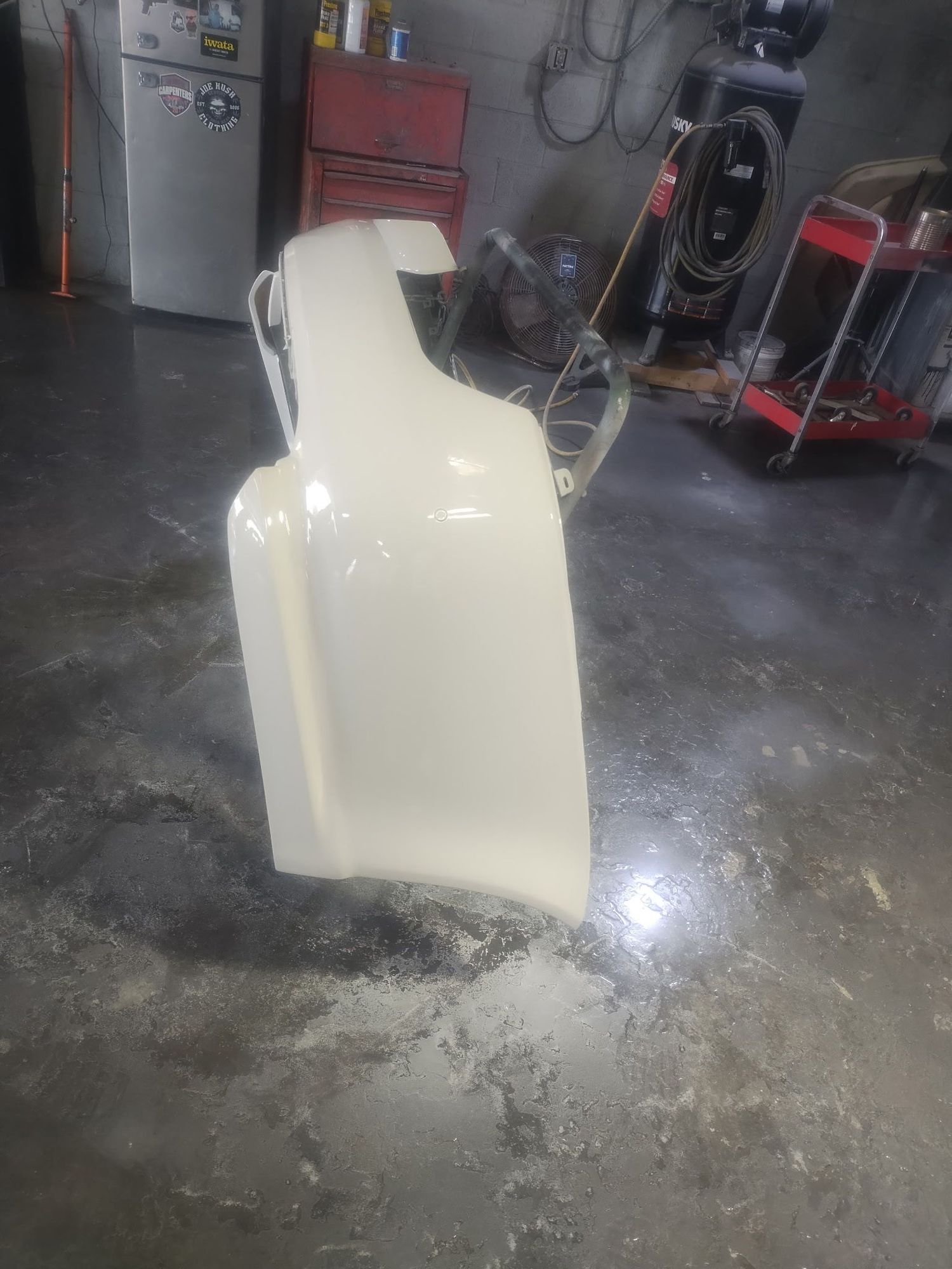

Prep for painting done.  Will spray on Monday and reassemble Tuesday if all goes as planned

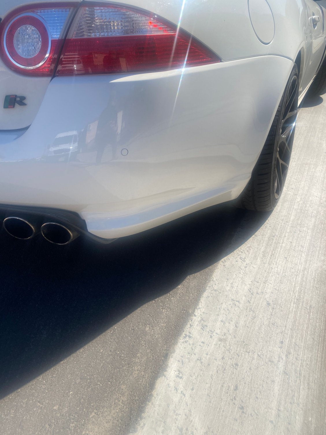

badicedog's Avatar
Joined: Mar 2019
Posts: 479
Likes: 143

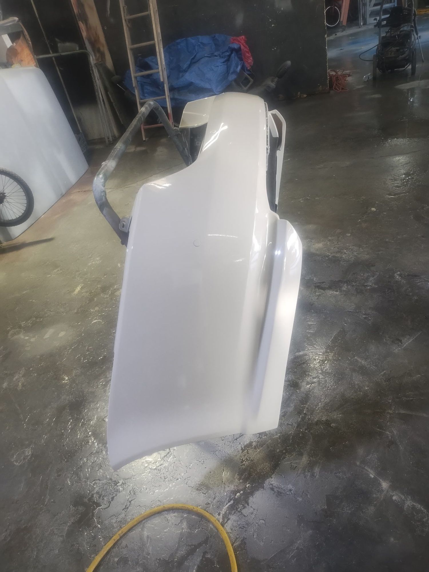

Pretty good if I do say so myself…

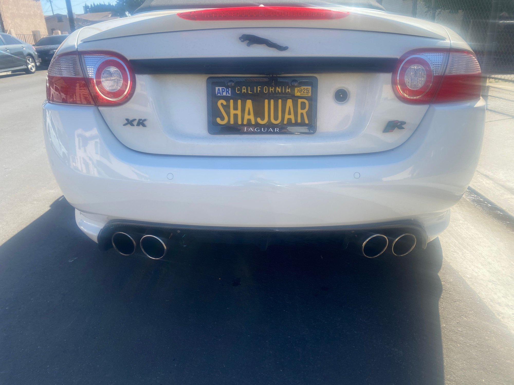

Old Mar 18, 2025 | 12:18 PM
badicedog's Avatar
Joined: Mar 2019
Posts: 479
Likes: 143
Ready to re install bumper

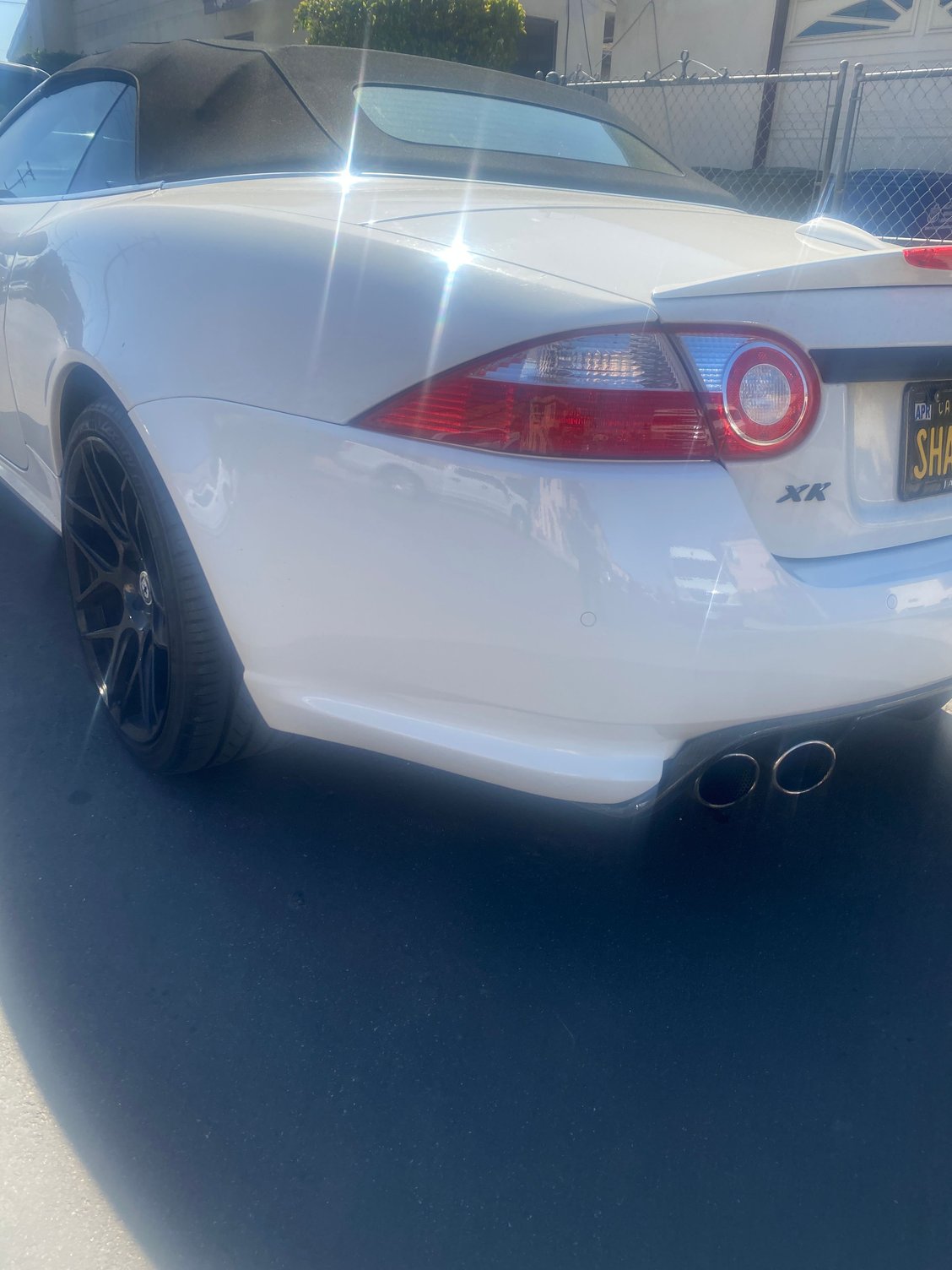

All done, now to wash her up and detail…what an experience
