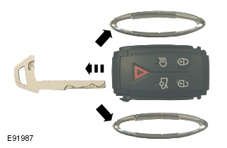

A message came up stating that the battery strength in the smart key was low.
I changed the battery but the message remains. Any help appreciated

Try another one, could be a bad replacement battery.

Yep, definitely check the battery - don't know how long its been sitting on shelf.
Have you looked at the circuit board - is there any corrosion, oil, etc found on it? If so may need to clean and retry.
Also, keep the bulletin below in mind ...

The lower housing of the smart key has 3 pegs which support the internal circuit board. A concern with the manufacturing process has led to one of the support pegs being too short thus allowing the circuit board to flex when the function buttons are pressed.Suggested Customer Concern Code - L20.
Action:
Should a customer express concern, install a new smart key lower housing and battery. Follow the Service Instruction outlined below.

SERVICE INSTRUCTION:
  1. Remove the Smart key blade by pressing the clip (see E91986).
  2. Remove both side chrome rings (one at a time), by inserting a small, flat-blade screwdriver between the cover and the body, and lightly twisting the screwdriver (see E91987).
  3. CAUTION:
    Do NOT touch the green printed circuit board, battery, or the battery contacts (arrowed in E91988). Oil or any other contamination on either component can affect the Smart key performance.
    Pull apart the Smart key and discard the lower housing and battery.
  4. Re-assemble the Smart key by reversing the procedure above, using the new lower housing and battery.

When installing a new CR2032 battery, check the metal prongs and make sure they make good contact with that battery.
