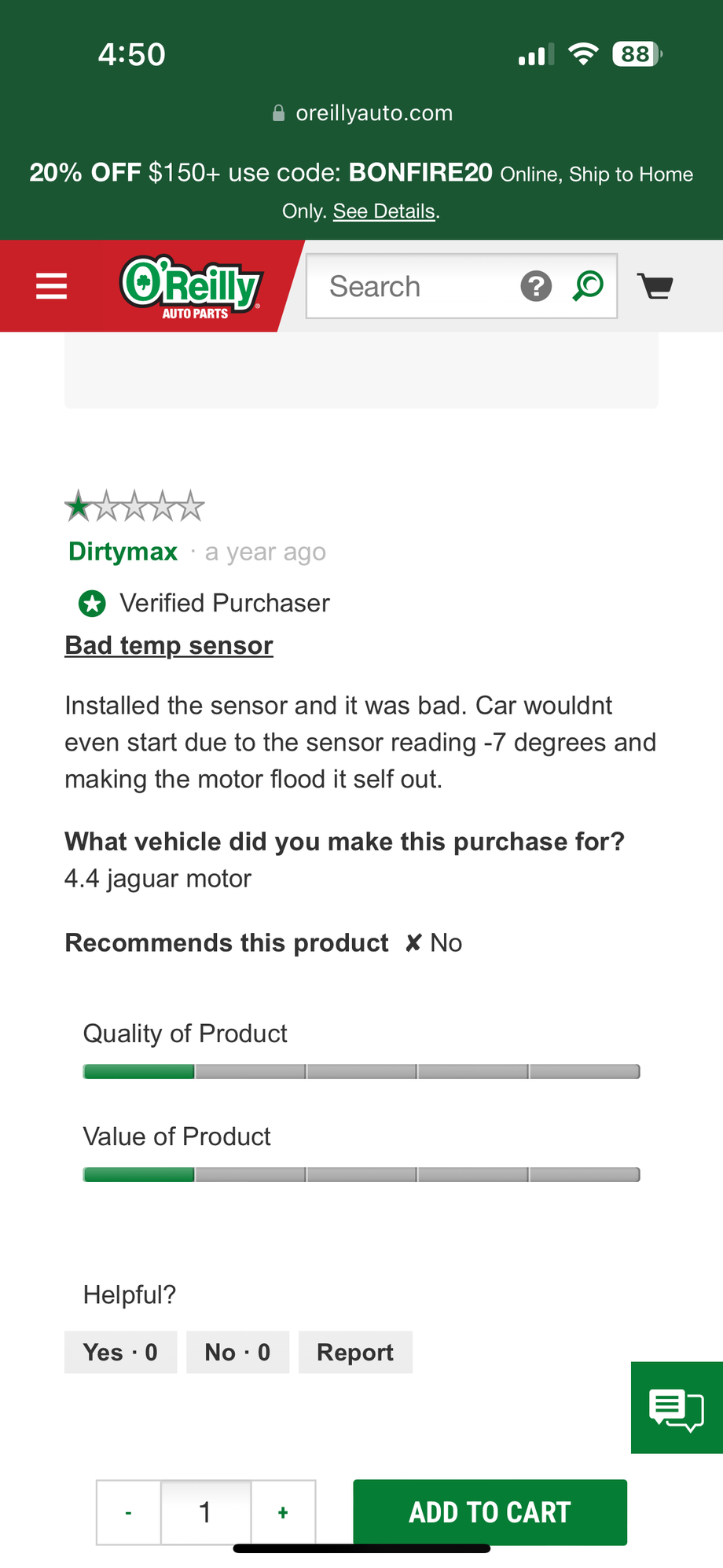

New sensor could be bad. Did you read the 1-star reviews on that site?

Maybe. I got one from O'Reilly's and one from Monument Auto Parts. I was thinking the odds of getting two bad sensors was probably small.

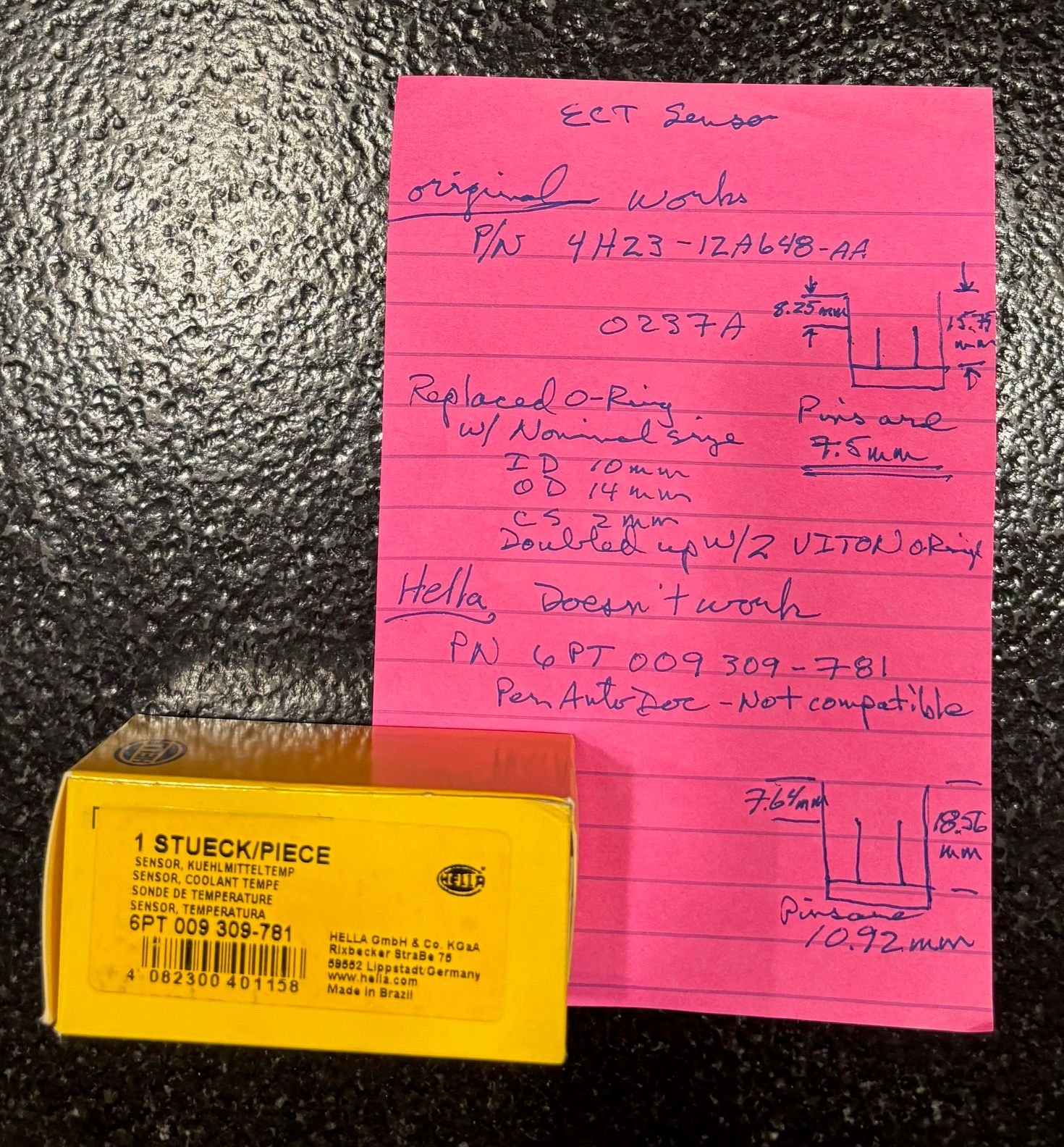

I know this thread is a couple years old, but I ran into this same issue with the ECT sensor replacement this Summer on my 2008 XKR. Thank goodness for the sharing of repair sagas by this forum's members.
I replaced most of the accessible coolant hoses (not the valley hoses) as they were 17 years old now. The ECT sensor ,although functional, was a bit of a loose fit in the thermostat housing manifold so replaced it to avoid a potential leak source. My local foreign car parts guy provided a Hella part number 6PT 009 309-781 which appeared identical to the old OEM part.
Good brand right?, so shouldn't be a problem.... WRONG! Engine would crank but not start. So now I'm chasing a some connection or wire that I broke or failed to connect during the cooling hose replacements. No obvious issue found, so looked to the forum for potential causes.
Hat's off to Biff Baxter's thread regarding the replacement ECT sensor problems. Put the original ECT sensor (with new Viton o-rings installed so now a snug fit in the thermostat manifold). Car started right up!!!
As Biff had mentioned a possible issue with the sensor electrical pin lengths not mating with the wire harness connector receptacles, I took a few measurements on the working original sensor and the non-working Hella part. See the attached picture with scribbled sketches. I did not measure the wire harness connector ,but a replacement sensor with connector measures similar to the original part might well work and be substantially cheaper than a Jaguar replacement sensor ($60 or so!). My original part part number in the picture is taken from the part and not the Jaguar P/N mentioned above..
Thanks again, Biff!
