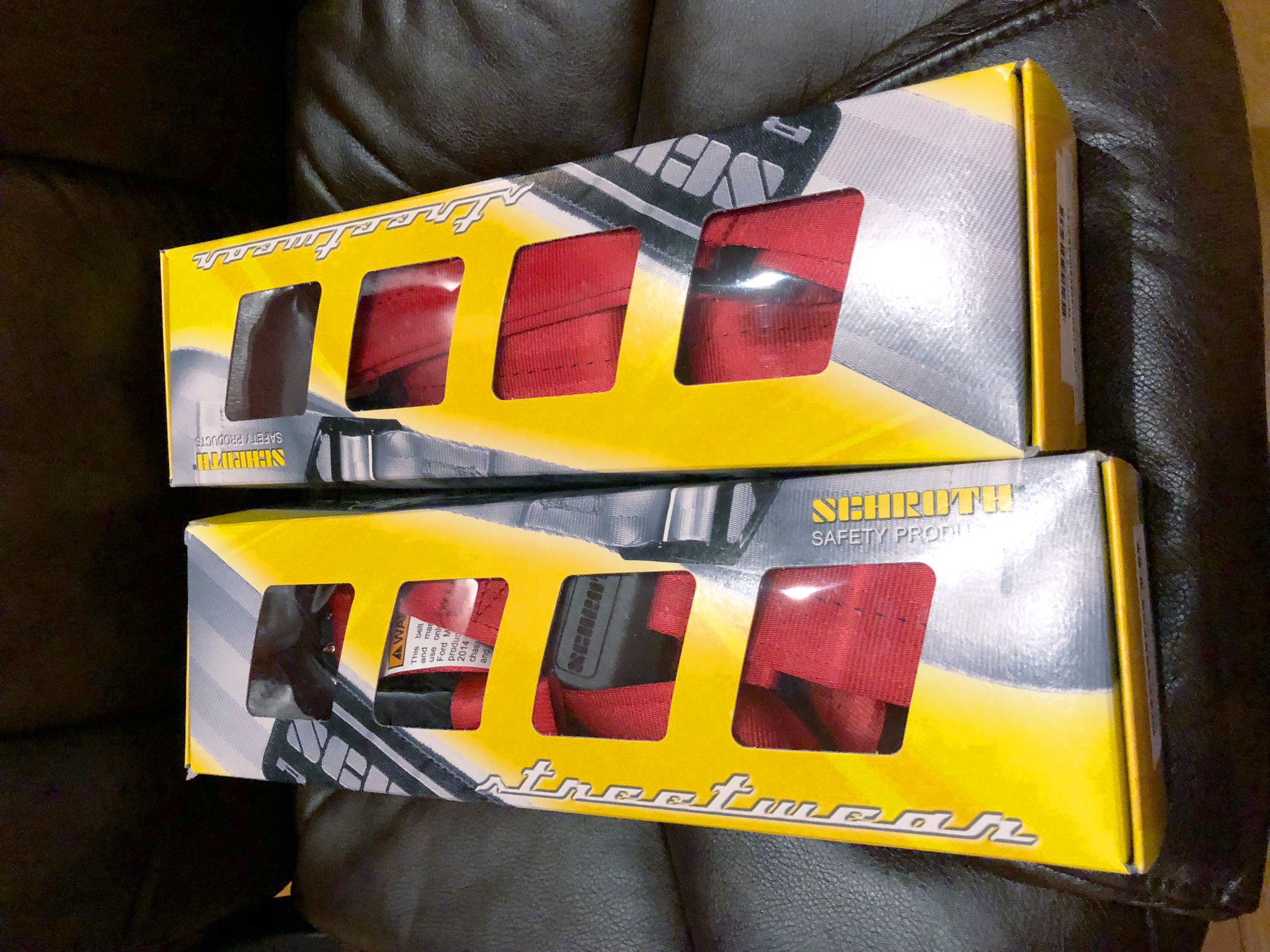

These arrived today and in the process of getting them fitted now. They are the only harness that works with the OEM buckles and support OEM or race seats and HANS devices. Going to give them a try with the stock seats before I do full race seats.

Where do you plan to anchor the shoulder straps?

That’s the beauty of this harness, it attaches to the rear seat belt anchor points. You lose use of the rear seat belts but it is reversible. I did have to non-permanently modify the rear buckle receiver as Jag uses an odd shaped tongue using Ford receivers.
