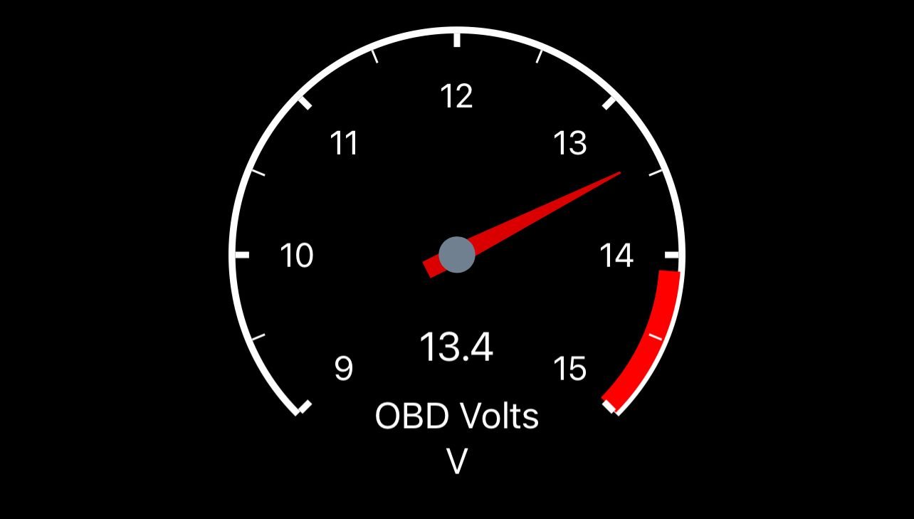

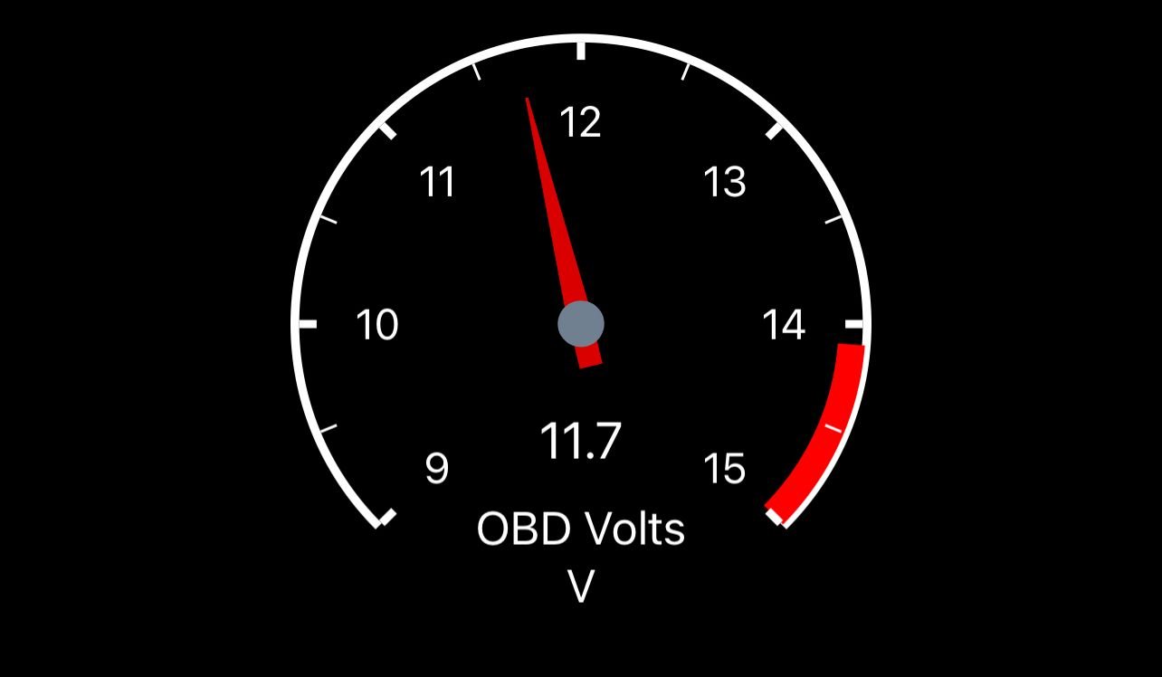

Originally Posted by guy
Sorry to be the bearer of bad news. I HIGHLY doubt your battery's resting voltage is 13.4v.
Well put me in a dress and call me Sally.
Yeah. I only look while she is running.
Using my OBD app:
👇 Engine running:
👇 Start button no brake:
She starts with zero hesitation, but I’m gonna guess it is time to grab that CTek.
Then if she doesn’t recondition, replace the battery before gremlins start popping up.
