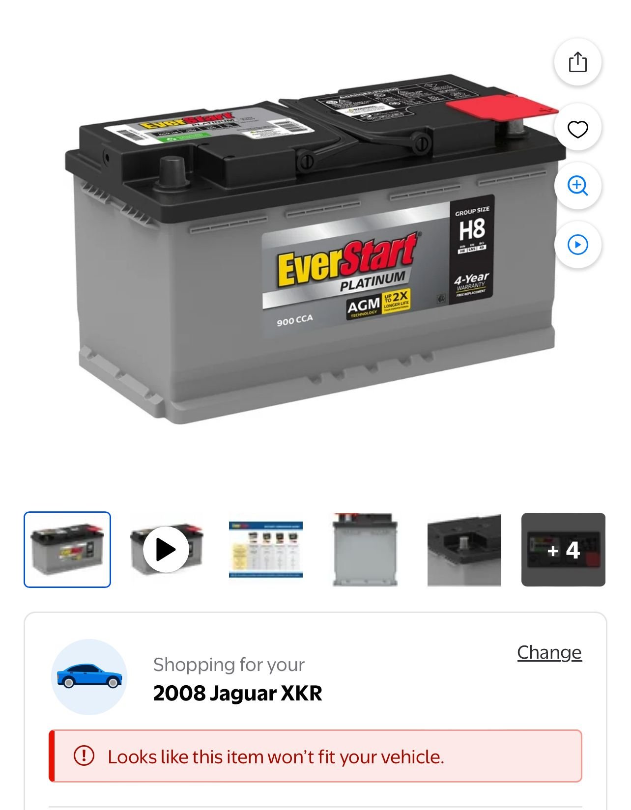

Have Walmart+ for free, so was going to have the one below delivered tomorrow.
But then, somehow I ended up on the gremlins thread and saw this:
Originally Posted by NBCat
The age of a battery is immaterial. Use a voltmeter to read the available voltage across the battery terminals with the ignition in the OFF position for at least 30 minutes.
The voltmeter should indicate a minimum of 12.6 volts available. If the voltmeter shows less than 12.6 volts, charge the battery for five hours at 2 to 5 amps and retest.
Tells me I’m better off just going to Wally World so I can see the manuf date and test the battery off the shelf.
Can someone share what they mean by “keep the old battery vents”? Not a clue what those are or what they look like.
Ironically, Walmart site says not compatible.
They say that because your car didn’t come equipped with an AGM battery. Overly cautious on their part, no imagination.

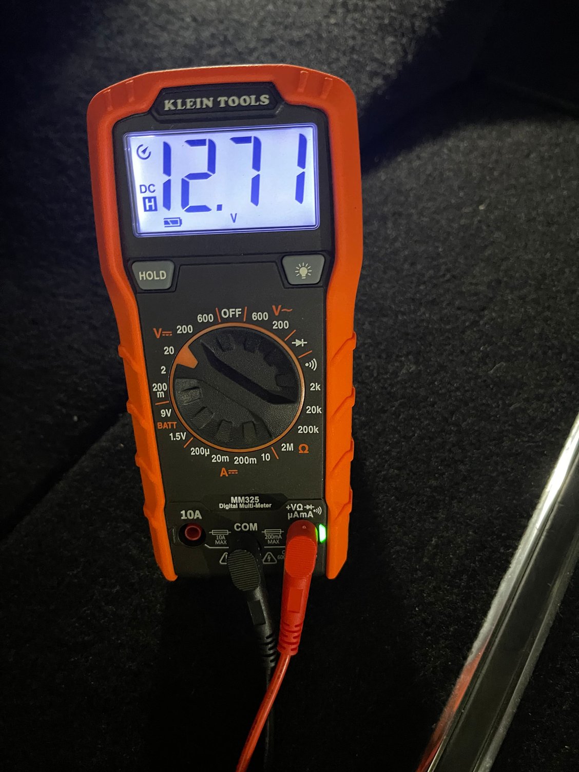

So continuing the experiment and saga, I left the Ctek connected overnight on charge instead of condition.
After about 10 hours, I opened the boot and tested the voltage with the Ctek on. 12.75v as to be expected.
Then I disconnected the Ctek and waited a few minutes. Measured voltage again. 12.71v.
Keep in mind I’m doing this across the connections in the boot.
So now, I wait. Will measure every hour or two for another 3 hours until the wife and I leave for the pub for cocktail hour and some college football.
I will measure again when I get home, while monitoring the voltage as I drive each way via OBD.
Then again in the morning, you get the point.
To help explain my obsession with these things, I was a nuclear engineer in the Navy and college was nuclear physics. (Technically P-Chem, but same same) with a focus on data, which is what I do now but in Marketing.
Therefore more data points over time with a controlled environment provides more accurate analysis and experience.

Starting post-charge - 12.71v
2 hrs sitting - 12.44v (2:34pm EST)
Drive to pub, sit 3h and drive home - 12.43v
Well THAT'S quite telling, isn't it.
Is your battery completely disconnected from the car?
