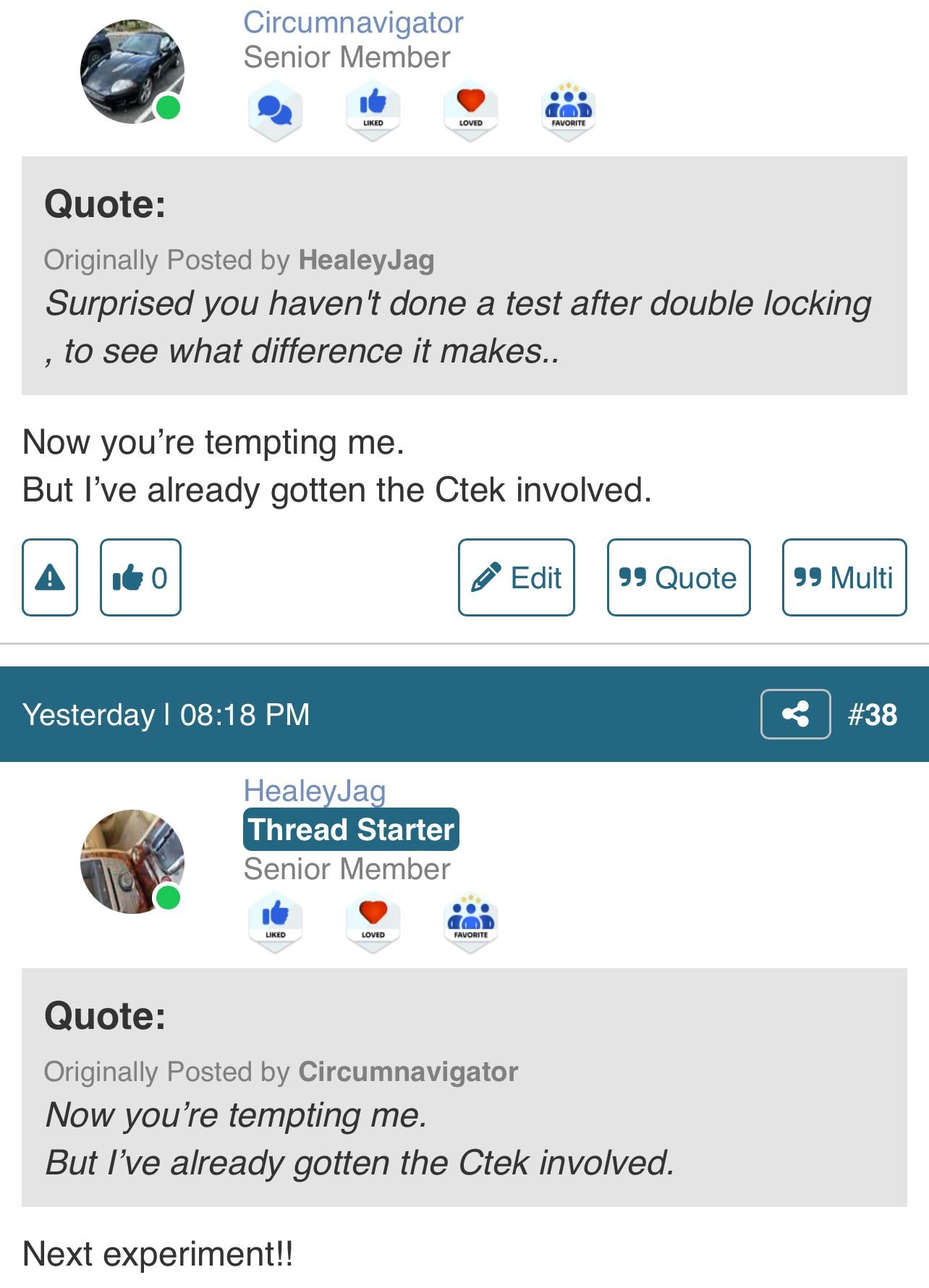

Whelp, thanks to @HealeyJag i have a new experiment.
Using this reply as the record, so will edit as long as it lets me before adding a reply.
Fresh start.
Overnight Ctek, disconnected: 10/23 11am - 12.97v
** Trunk latch popped, car locked **
10/23 12:30pm - 12.83v
10/23 7:15pm - 12.77v
Old Oct 23, 2025 | 11:58 AM
  #75
Sean W's Avatar
Joined: Jun 2013
Posts: 8,937
Likes: 4,745
From: USA
Have you replaced the battery yet? That was the issue identified 60 posts ago. Any testing you do for any reason will be invalidated if you start with a defective battery. Quiescent drain testing is most effective with a new battery as well. Pull the workshop manual and follow the guide to test for a quiescent drain.
Not sure what @HealeyJag suggestion you're referencing, but if was the double lock scenario, as @Stuart S indicated, double lock is not a thing in the US and even if you are chasing that, his thread is appropriate to continue your experiments on to prevent you from moving off topic and help future users in the search for solutions to their problems. I wish you the best of luck in any event. Cheers.
