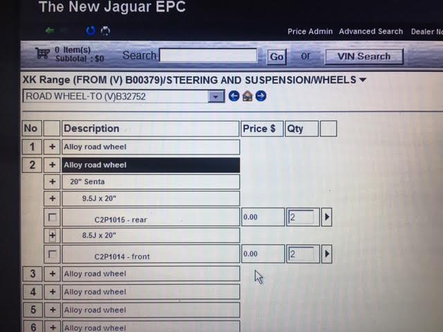

That's not what I'm seeing in the attached. The OP doesn't list his vehicle so we can't answer for certain but also I don't see the fronts ever being 8.5"
07 - are 8" both front and rear.
The 08 and 09 show 9" front and 9.5" rear

Seen that listing before, lots of errors. Need to look at official Jaguar stuff, like Cambo did.

I replaced my sentas on my 2007 xkr, they were f/8.5x20, r/9.5x20 the et f/49, r/26

I bought a set on ebay last year for my US 2007 XK, which came from a US 2008 XKR, and they are the same sizes as what powerhouse posted above.

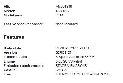

Model year. For example, the first production year X150 is 2006 even if that vehicle sat in the dealer's showroom in London and wasn't registered until 2007 it's still a 2006 model.
I am not convinced this is true, well not according to Topix anyway unless the factory MY and the US sales MY are two different things.
B00379 is supposedly the first 'production' XK and that is a UK model but Topix still lists it as a 2007MY. Even B00001 is listed as a 2007MY car.
When cars are coming down the line in the factory they are all the same model year spec regardless of destination.
All of the first 5.0L cars seem to be listed as 2010MY regardless of market as well.
B31936 is an ex UK 5.0L XKR that is kicking around NZ somewhere that has a VIN before the official start of the face lift cars and that is listed as a 2010 MY even though it was registered in 2008.
B34253 is a 2010 US car currently on EBAY and that is also listed in Topix as a 2010MY car.
Attached Thumbnails Senta Wheels - are front and back the same?-b00379.jpg   Senta Wheels - are front and back the same?-b31936.jpg   Senta Wheels - are front and back the same?-b34253.jpg   Senta Wheels - are front and back the same?-b00001.jpg
