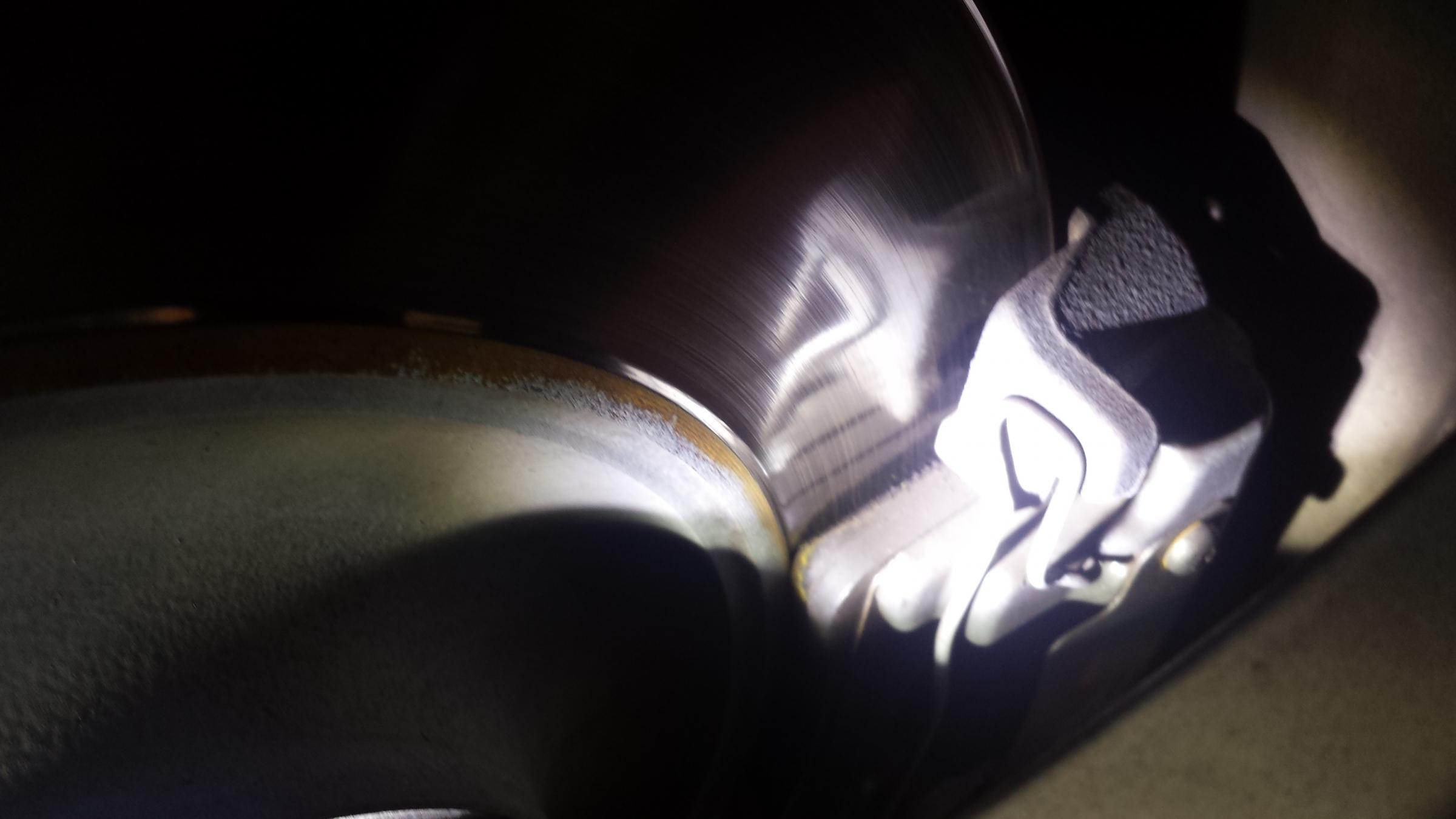

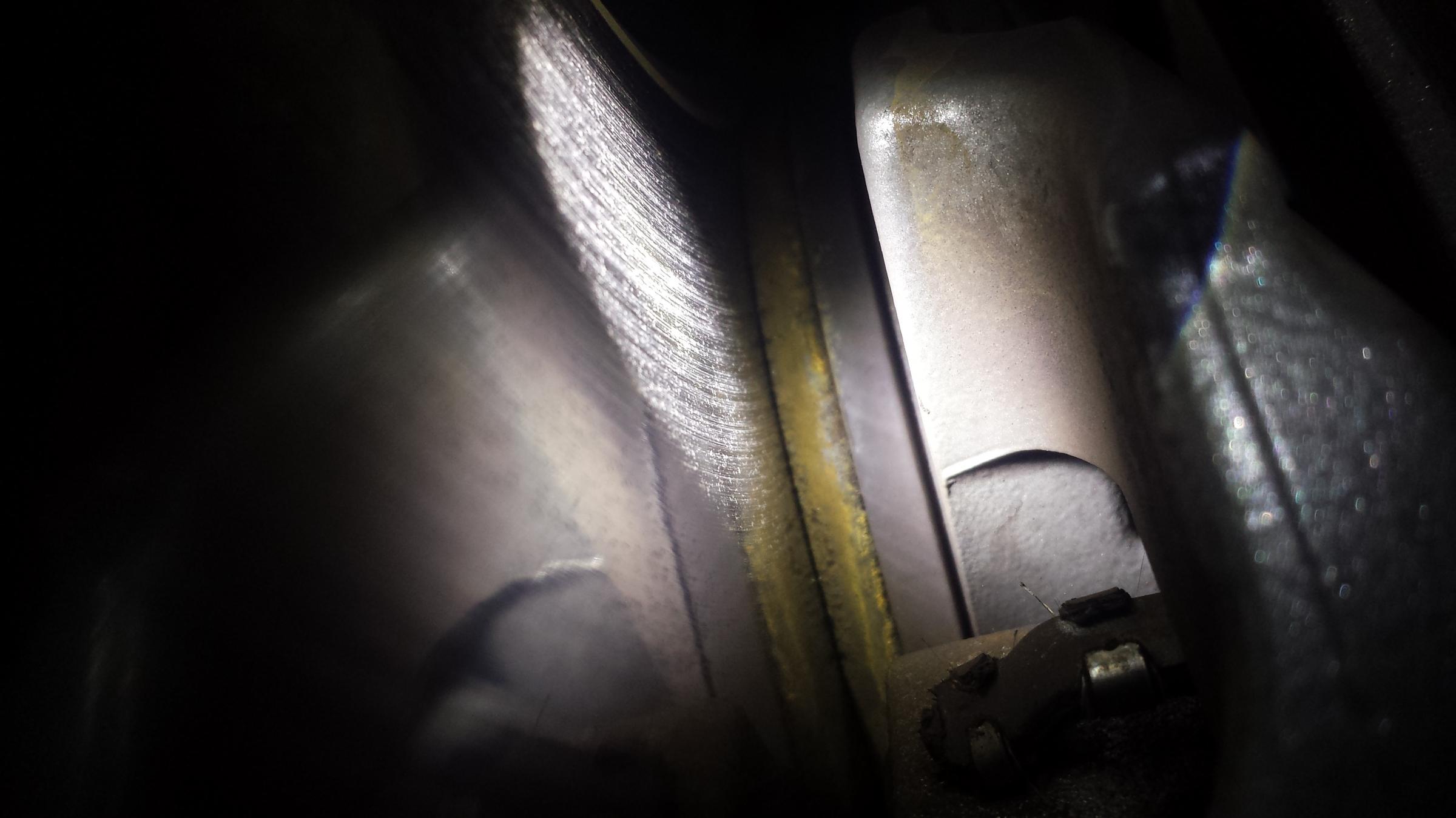

Hiya,
Quick sanity check (..yeah, yeah, please read on before answering!)
Had the car serviced, followed by the brake pad wear warning coming on after a month - guess about 1,500km. I wasn't best pleased, as to me, the cost in travel/time back to the garage exceeds the benefit of squeezing a few weeks out of the pads.
When I called to discuss with the service manager, he told me that they always waited for the light to come on before changing the pads, as the warning came on with 20-25% of the pads left.
After about another 500km, I'd guess that there is about 5mm left all around.
Do you:
1. Subscribe to the theory 'only change when the warning light comes on'
2. Think that 5-7mm on the pads = 20-25% left?
Many thanks,
Rob
Attached Thumbnails Service question-20150106_131341.jpg   Service question-20150106_131244.jpg

New pads are generally around 12mm so 3 mm would be 25%. I normally change my pads at around the 3 mm mark irrespective of the dealers wanting to change them at 50%.
I check the thickness of mine on a regular basis and once they reach 50% I will buy a new set. They will then be changed as they near the 3 mm mark.

If you wait for the warning light to come on you have to replace the wear sensor as well. I just check the pads and when it gets close to touching the sensor I swap them out. It's actually a pretty straight forward job on the XK.

Back in the day when I was in the business I had a shop policy that customers were notified at 50% pad thickness. Notified, not 'upsold'. Once in awhile we'd get someone who wanted 'em replaced at that point purely out of convenience. Not often.
At 25% we would recommend replacement but not as a 'must do today' thing. Most customers said yes at 25%.
At 10% we would *urgently* recommend replacement. On most pads that's just 1 mm. Damn little.
