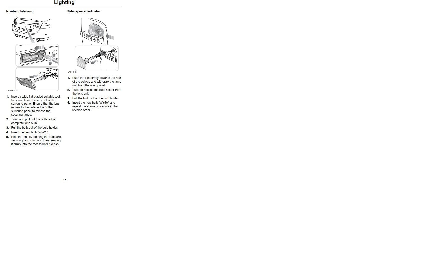

Hi all does anyone know how to get the side indicator lens off on a XKR as I need to change the bulb

I took mine out to replace it. I don't remember exactly how it came out, but I did use a screwdriver to pry it, which slipped and I seriously scratched my paint. So make sure you don't do that. I believe instructions are in the owners manual if I remember correctly.
