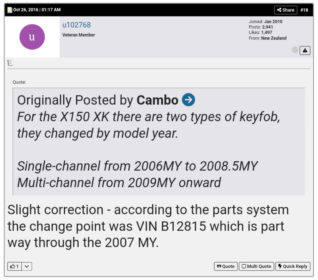

Your Public Profile shows that you have a 2007 XK Convertible. Note that early 2007 X150 models used a single-channel Smartkey and later models all used multi-channel Smartkeys. They're not interchangeable. See
https://www.jaguarforums.com/forum/x...ispreloading=1
Make sure to get the correct key for your car. Buyer Beware if you're buying a used SmartKey - it might not be able to be reprogrammed.

Programming the X150 Smartkey to work remotely and programming it to work with the dock are two different procedures. Also, the cheap Chinese clones on eBay and AliExpress are not exactly the same size as the OEM Smartkey shell (with the Leaper logo on the back) and might not fit properly in the dock. Read this thread from 2020:
