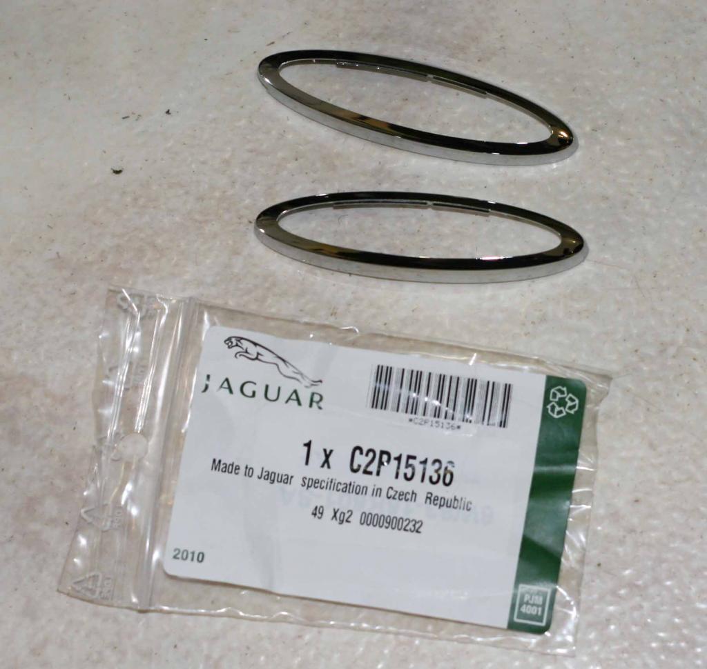

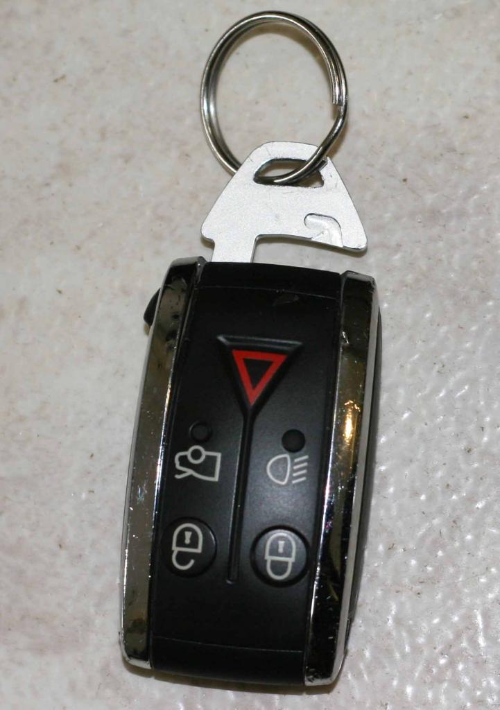

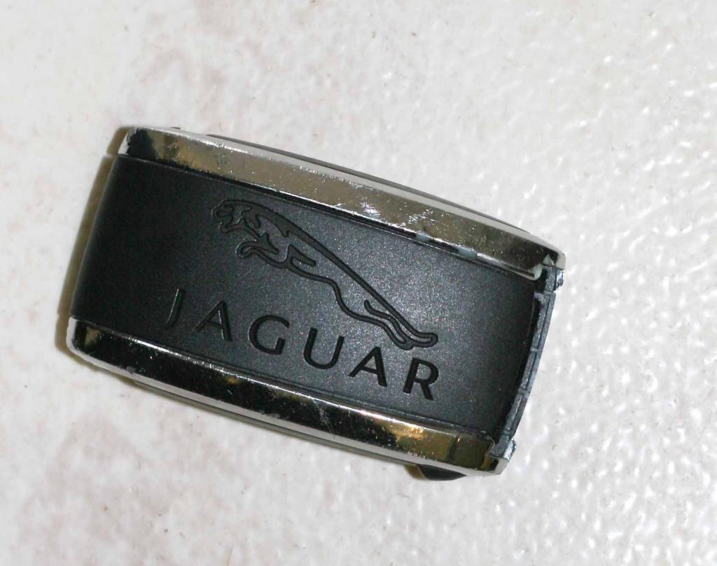

The Smartkey that came with my 2007 XK had seen better days. The latch that holds the mechanical key in the fob was broken, and the chrome was peeling and marred.
I figured I would have to replace it, but much to my delight I found that Jaguar parts carries all the little bits to repair it. You can purchase the spring and latch, the chrome end pieces, the keypad and the back all separately, and all for relative pocket change.

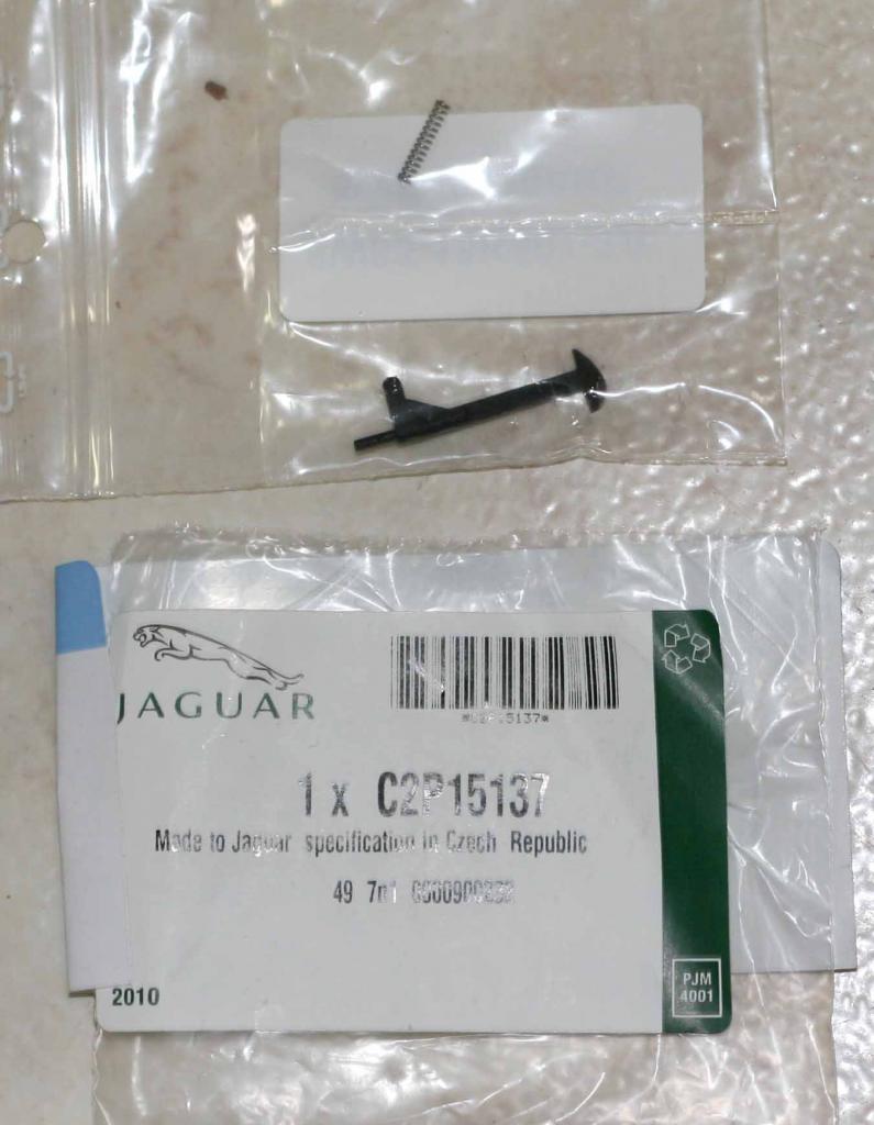

So I went about purchasing a new spring and latch ($2.05 at Gaudin) and and new chrome end pieces ($8.10 at Gaudin).

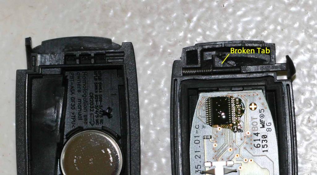

To perform the repair simply pry off the chrome end pieces.
Then the broken latch tab is revealed.

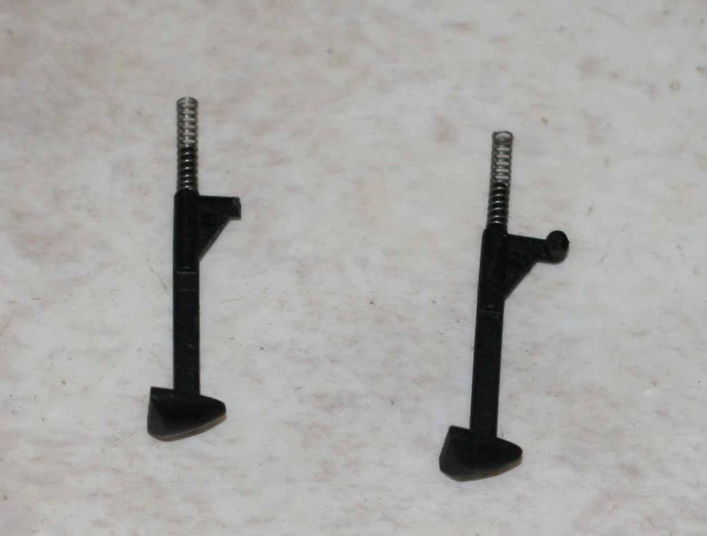

Slide the spring on the new part. Here you can see the old broken part next to the new one:

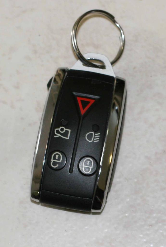

Then compress the spring an snap the lever back in place. Squeeze the shell back together and snap on the new end caps. As good as new for about 10 bucks:
Here are the part numbers:
C2P15136 - Chrome end piece set
C2P15137 - Latch and spring
C2P17158 - Back with new battery
C2P15134 - Keypad (VIN # to B12814)
C2P15135 - Keypad (VIN # from B12815)
