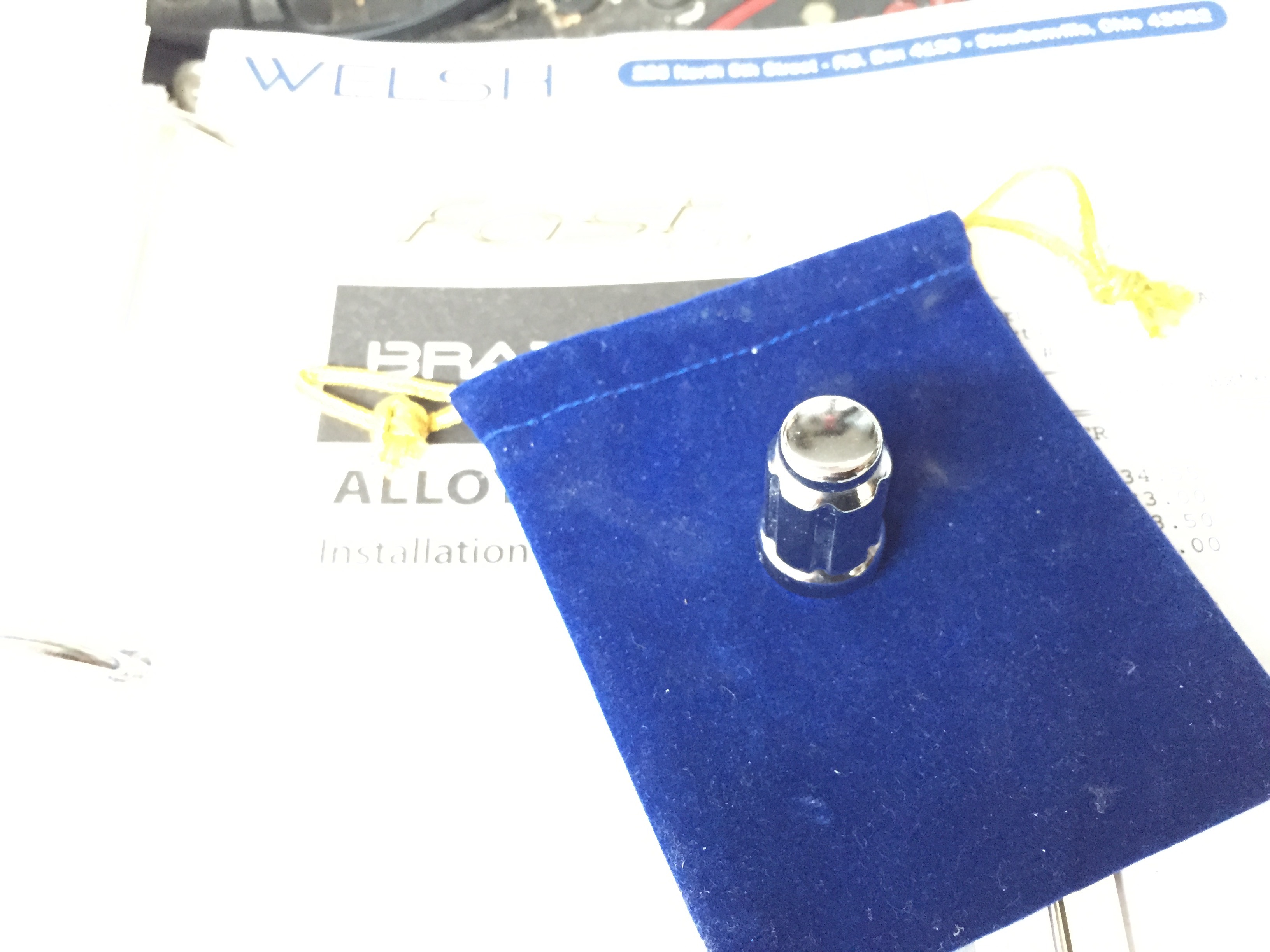

Happy 4th All,
So, being a rainy 4th here, I was going to pull a couple wheels and prep the rotors for paint. However, looking at the lug nuts, I don't have a socket type for these "Tuner splined" lug nuts. Anyone know the size?
BTW, They were required for the Bralin wheels

Looks very similar to the nuts that came with the Mille Miglia wheels I bought from TireRack.com ~10 years ago for my Lexus. They came with a special socket, that fit those grooves.

Same lugs you can buy at Pep Boys/Autozone/Advance/ORielly's type auto parts stores. It's a tuner spline drive lug socket. I have three of them. You can get them there. They are standard and all the same.
http://www.ebay.com/itm/BLACK-7-SIDE...-/121376944419
http://shop.advanceautoparts.com/p/d...-+custom+wheel
I have them on my Senta wheels. Same size as a 1990 Toyota Celica.

Ken:
Here's the socket I use to remove the spline lug nuts on the Braelin wheels.
This is what I have to remove them:
MCGARD 8 SPLINE DRIVE SOCKET FOR TUNER STYLE LUG NUTS
Available at Amazon.....
Amazon.com: McGard 65300 SplineDrive Installation Tool - 13/16" Hex Size: Automotive Amazon.com: McGard 65300 SplineDrive Installation Tool - 13/16" Hex Size: Automotive
Hope this helps.
