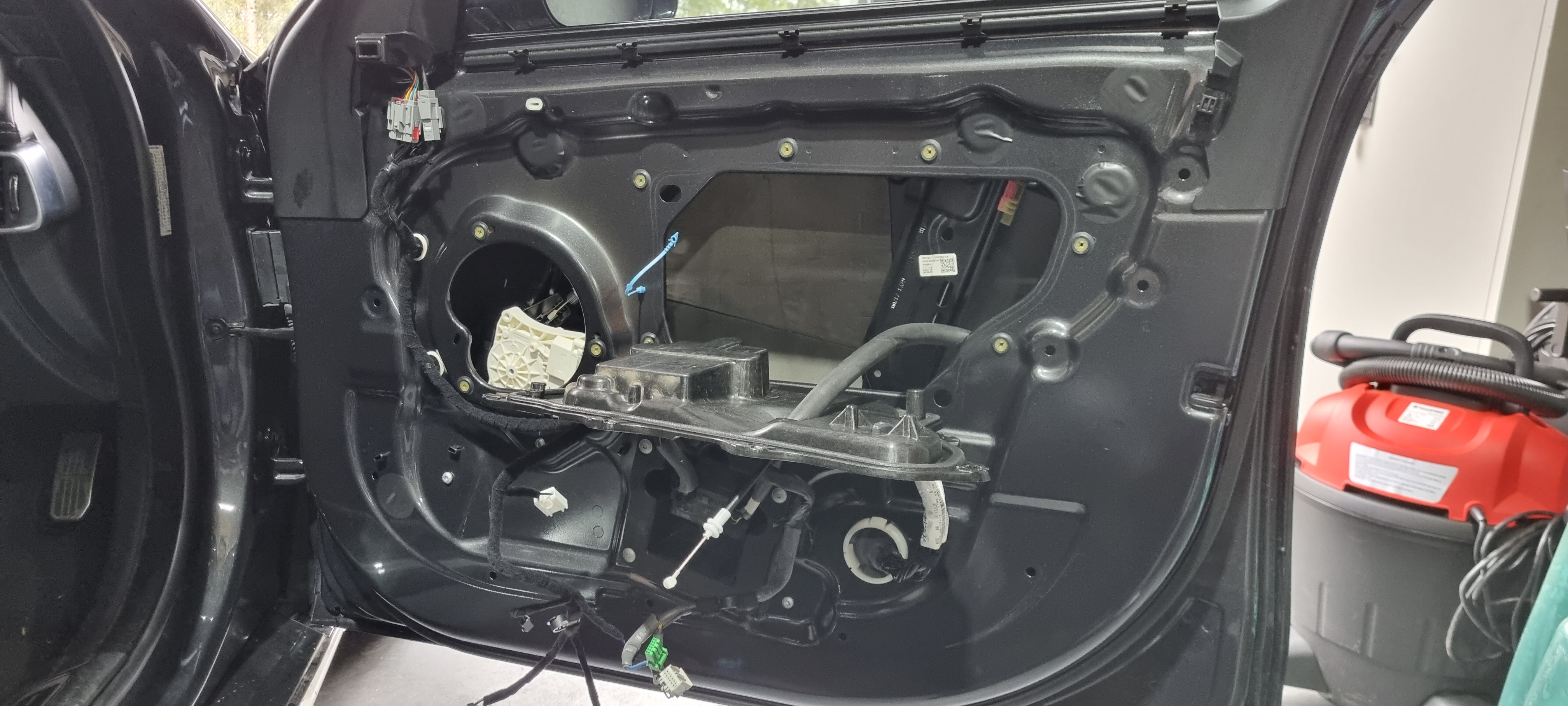

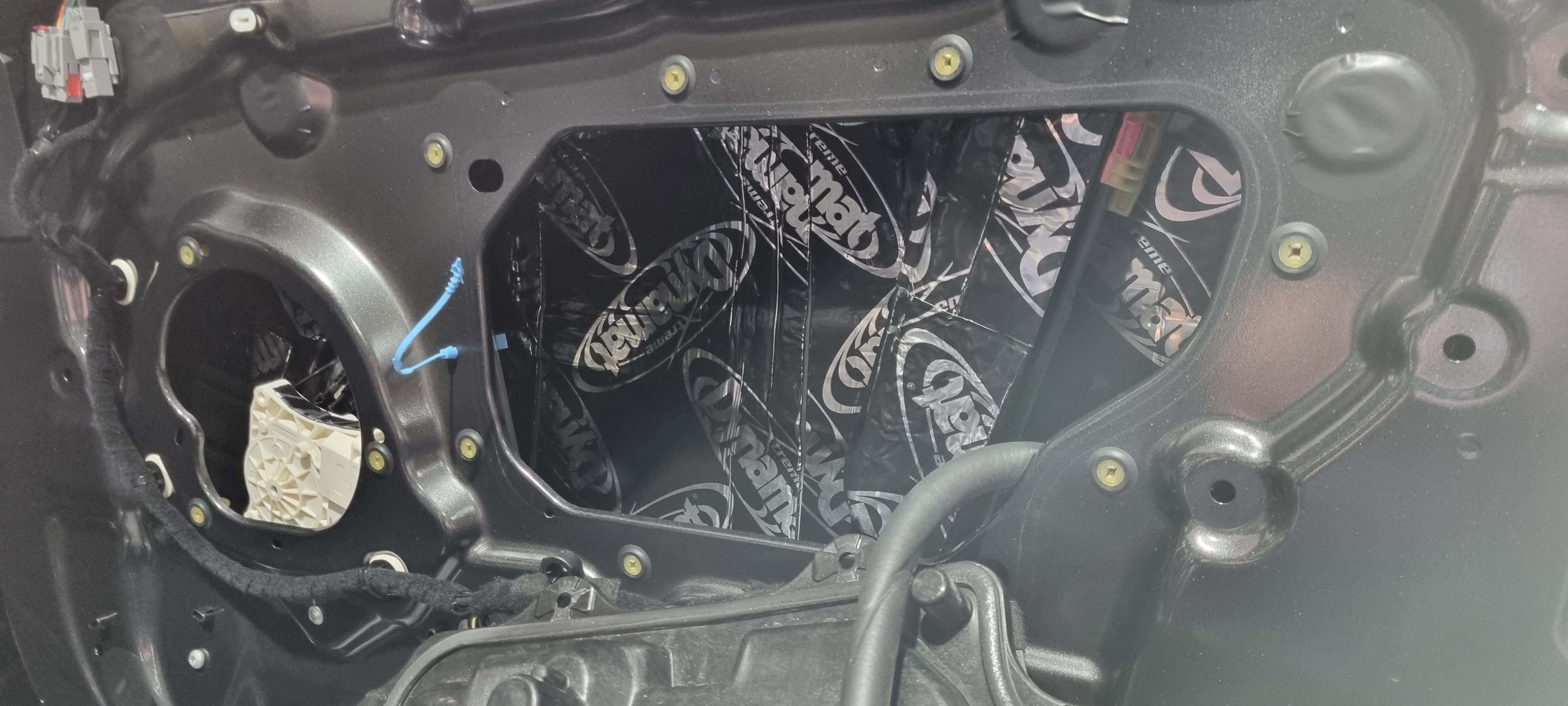

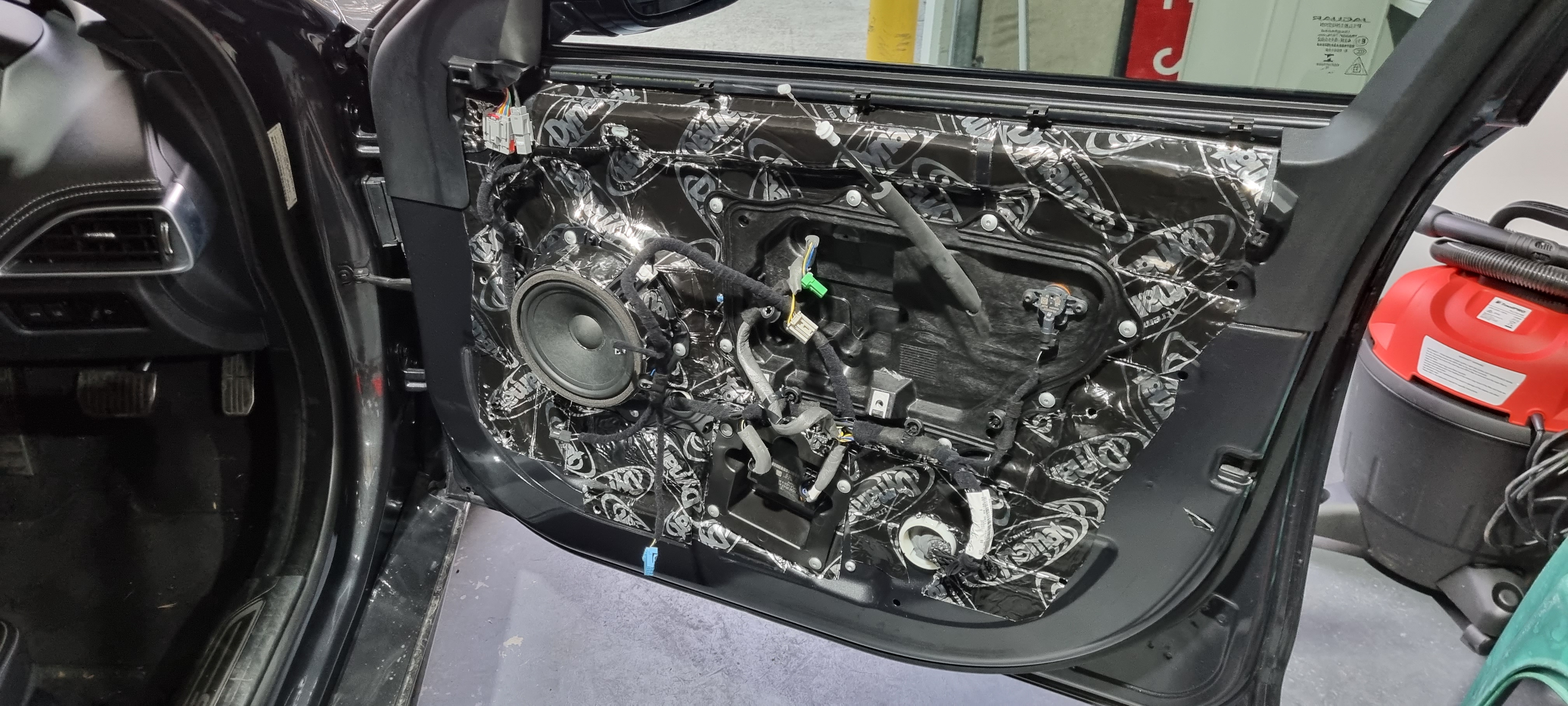

The sound difference is hard to capture, I tried...
...in these I had only done the driver's door, so I'm just fading between left and right and chose songs that would hopefully show the difference. Listening to these through headphones will make the difference a bit clearer. It's by far the best bang-for-buck audio upgrade you can do in a car as the door is the speakers' 'enclosure...' when you buy a home theatre system the speakers come in a (usually) wooden box, and you'll notice that the box gets heavier and stiffer as the quality and price of the system increases. Upgrading speakers without upgrading the enclosure only works when your enclosure is already good, which car doors definitely are not. Putting quality speakers into a low quality enclosure is a little bit like putting a massive turbo on a small engine that's not tuned for it, you might see small gains but the overall performance won't improve a lot and sometime it'll even get worse.
It requires more time than anything else.. this project took me about 20 hours all up; the first door took me a full day as I worked very slowly, the other three doors took a few hours each. I wrote a complete how-to guide that I'll post here soon, maybe even today
You really only need to remove the door cards which you'll probably have to remove to install speakers anyway, and there might be some electricals that you can just unscrew and pull out of the way. I attached photos of my XE's driver's door disassembled, with the outer skin done, and with the inner skin finished. Make sure you have a set of proper plastic trim puller tools (very cheap) and a handful of replacement white trim clips from Jag... I bought enough to replace all of them, but they're about 3 or 4 dollars each and you don't really need to do that. I managed to remove the cards without breaking any, but I'd definitely recommend having four or five on hand just in case you break one.
