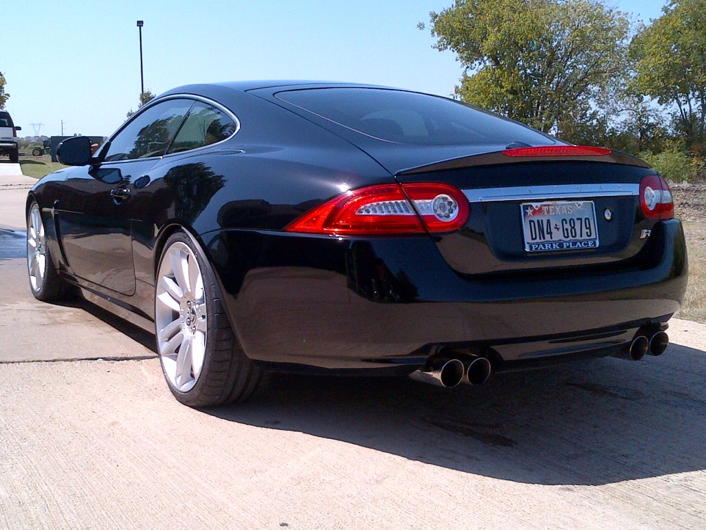

The spacers where quite easy to install. Just slip them on and bolt them down with the lugs that come with them.
Regarding before and after...
BEFORE:
AFTER
Attached Thumbnails Spacers Finally Installed!-plano-20120609-00129.jpg   Spacers Finally Installed!-northeast-20120606-00111.jpg   Spacers Finally Installed!-colony-20121001-00319.jpg   Spacers Finally Installed!-colony-20121001-00327.jpg   Spacers Finally Installed!-myxkr4_zpsa17ebfda.jpg

Guys, NO cutting is required with the Nevis wheels. I know Foggy as he lives 2 miles from me. When I got my spacers I went to his house to put them on and low and behold NO cutting needed. The Nevis wheels have the indentions whereas the 175 wheels did not.
Regarding the front yes they could come out more. But I am ordering a set of custom wheels so won't jack with it.
rscultho, I believe the rears start at +31 not 46. So the spacers bring it down to 16. As a matter of fact, I think it was one of YOUR posts that confirmed the 31 rear offset ;-)
