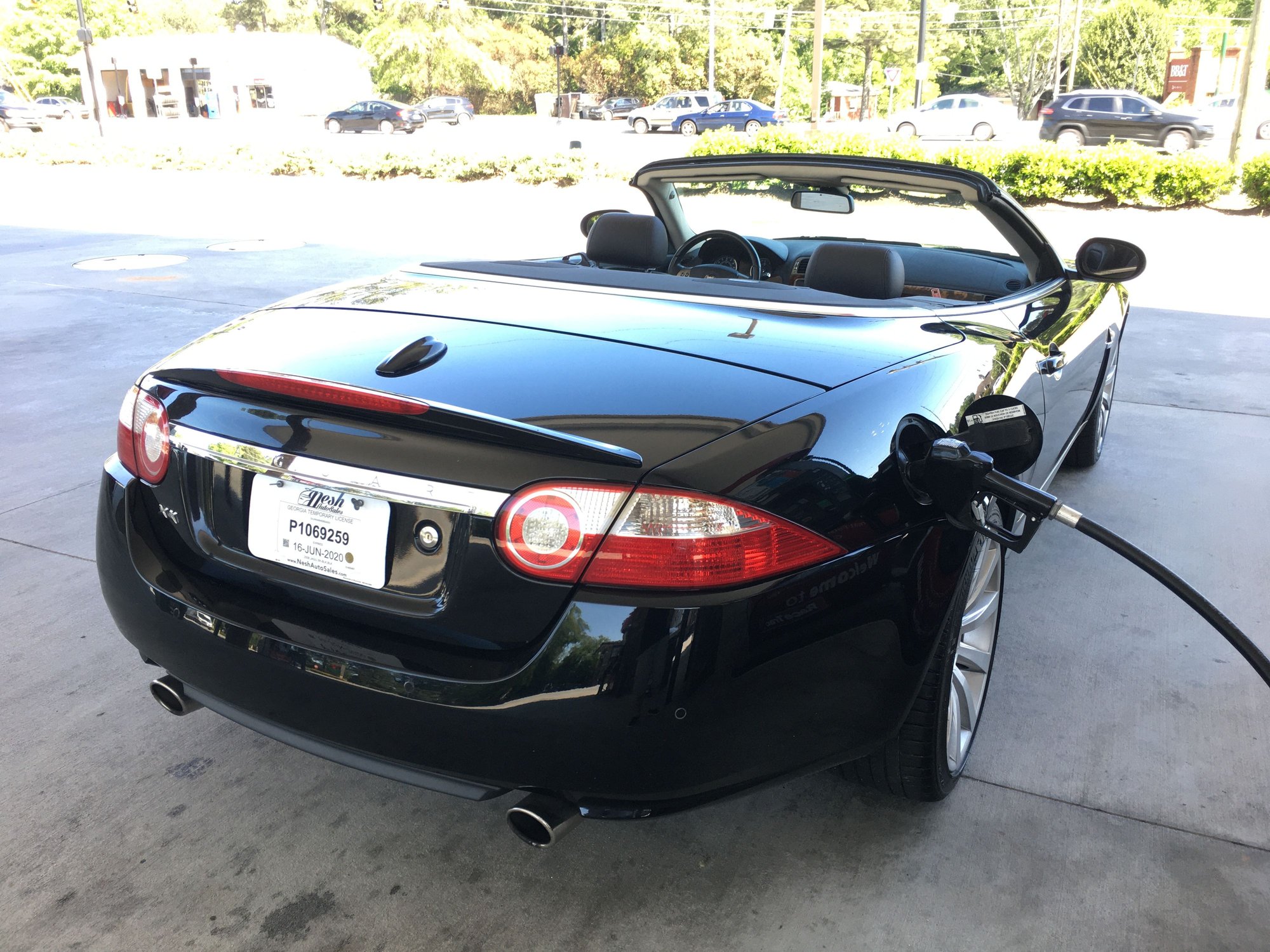

Hi all,
This is a photo of my new baby, Genevieve... 2008, 98,000 miles, almost perfect... BUT, her brakes squeal!!?
Over the past couple of weekends, I have whipped all wheels off and greased all the appropriate connection points @ the calipers and pads, but, although it is better than it was, I still have the squeal.
The squealing is @ low speed, light brake application, and intermittent, only when coming to a full stop??
Any ideas on what to do next? The pads that are on her are proper Jaguar pads, with tons of meat left on them (well over 1/2")... b ut I am a bit stuck now as I think I have done the obvious stuff??? (maybe?)
Cheers in advance for any advice y'all might have.
Best regards, Ian in Atlanta (although originally Dundee, Scotland)
my new baby... 2008, 98000 miles, not a mark on her... (hers names Genevieve)...
