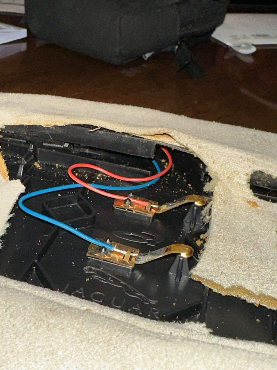

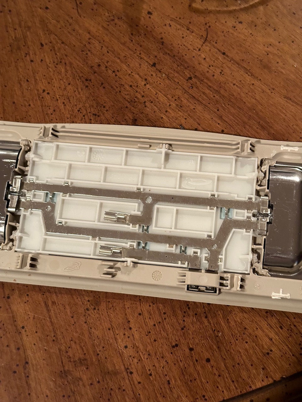

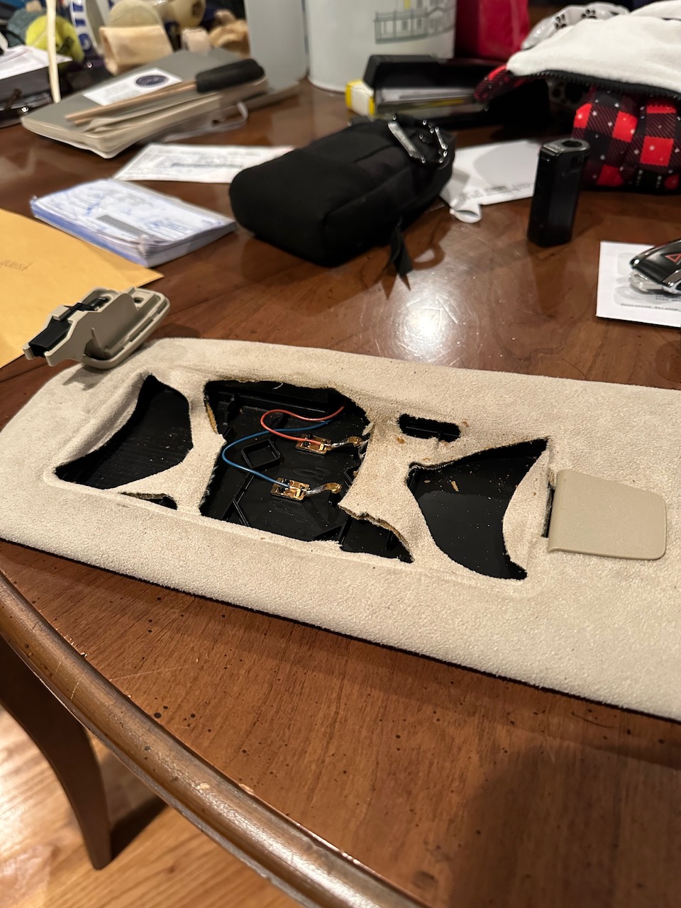

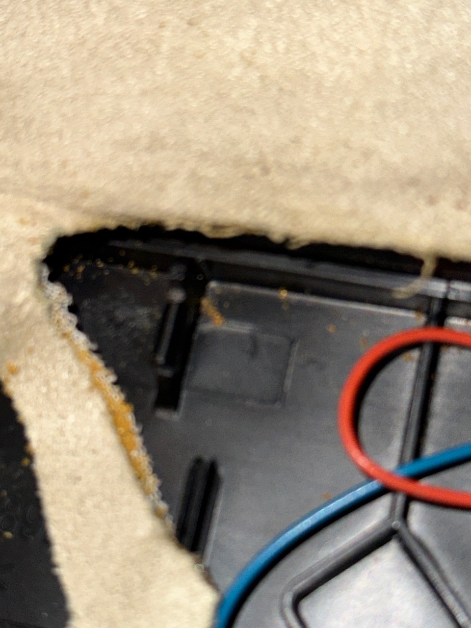

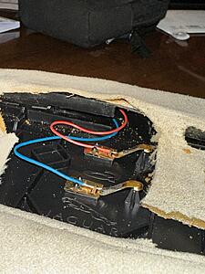

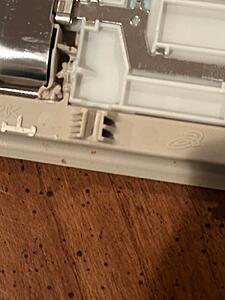

Hello all,
My driver's sun visor does the dreaded "pop and sag." From reading previous posts on the matter, I thought some pictures of the procedure might be warranted.
First, remove the sunvisor: it's easy: just pop the plastic cover away and there is one #15 torx screw. Remove it, unclip the wire and it's much easier to work with out of the car.
Second, remove the mirror assembly. There are 4 clips... shown in pictures.
Third, clamp the clamshell together. There is a lot of force to overcome.
Fourth: plastic weld the clam shell. I have not yet done this. I'm thinking of using a stainless steel mesh to put across the span, then melting it into the plastic to strengthen the bond. I will use the flat end of the tip on my soldering iron to press into the mesh/plastic.
Any other ideas are welcome.
First pic: close-up of clamshell.. you can see the gap and the red and blue wires snaking in, second is close-up of the flat tab that the rounded clip from mirror snaps onto, third is close-up of the aforementioned clip and the final pic is the sun visor on the table for perspective.
Attached Thumbnails Sunvisor-img_4537.jpeg   Sunvisor-img_4540.jpeg   Sunvisor-img_4539.jpeg   Sunvisor-img_4538.jpeg   Sunvisor-img_4536.jpeg

Well, I must say the combination of JB Weld plastic epoxy and plastic welding did not hold. Putting a screw in is difficult without removing the fabric. I may need a professional trimmer to get it sorted properly. I noticed the fabric on the A pillars is sagging anyway….
