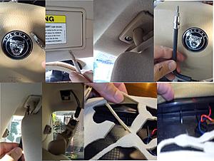

Hey Jagsters,
My drivers side sun visor was hanging down about an inch from the roof, in addition whenever I folded it down and then put it back up it made a loud snap sound. Very unbecoming a Jaguar. Something had to be done. Searching on the web showed new ones at about $300.00 bucks - ouch! And finding a used one in my color, on the drivers side and not broken was proving to be challenging as well. So it was time to try to fix it myself.
And I am happy to report it took all of ten minutes and the fix is perfect and permanent. Steps to follow:
1.Get a flat screwdriver and pry mirror out. Just put in under the mirror around the four corners and it pops right out. (There are no wires behind the mirror, just contacts.
2. Pop off the cover holding the sun visor to the roof and get a torx bit ready to unscrew the bolt. You will need a bit of an extension because the space is tight (see what I fabricated in my pic)
3. Once the screw is out, pull out the whole thing from the roof and disconnect the wire.
4. Pull back the fabric and you will see the problem. The clam shell plastic housing is separated and needs to be tightly held together. I simply put in a one inch flat head dry wall screw to bring it back together tightly. (Maybe Gorilla glue would have worked as well?). Once I drilled it though the plastic I then removed the screw and used a Dremel to shave off the excess and then put it back in. It does not pierce the fabric on the other side. Put a little red X in the last pic, this is where the screw needs to be.
5. Put it all back together and you will see the sun visor now closes right up to the roof - nice and snug.
6.If the light on the mirror does not go on, press all four corners of the mirror down again, I guarantee the top part was not snapped back all the way in. The light will now work.
10 minutes of work and no cost!

Good on you Michael for sharing. Don't you just love home brew fixes.

I've lived with a floppy left side visor for a while. The problem is apparent when you remove the mirror and see that the plastic clamshell seam is separated.
I first tried super glue on the plastic seam but it wouldn't hold. I held my breath and drilled a hole and tapered the hole so the screw would be flush. I used a 3/4" screw and needed to shorten it slightly. 5/8" should be about right.
Looks like the problem is solved. Thanks for the simple and effective solution.
This reinforces my belief that no engineering time was expended on the interior.

↑ I am not so sure that 'no engineering time was spent on the interior'. I have 110,000 miles and this is the only issue my car ever had regarding the interior. Everything else is perfect. That says a lot about the build quality.

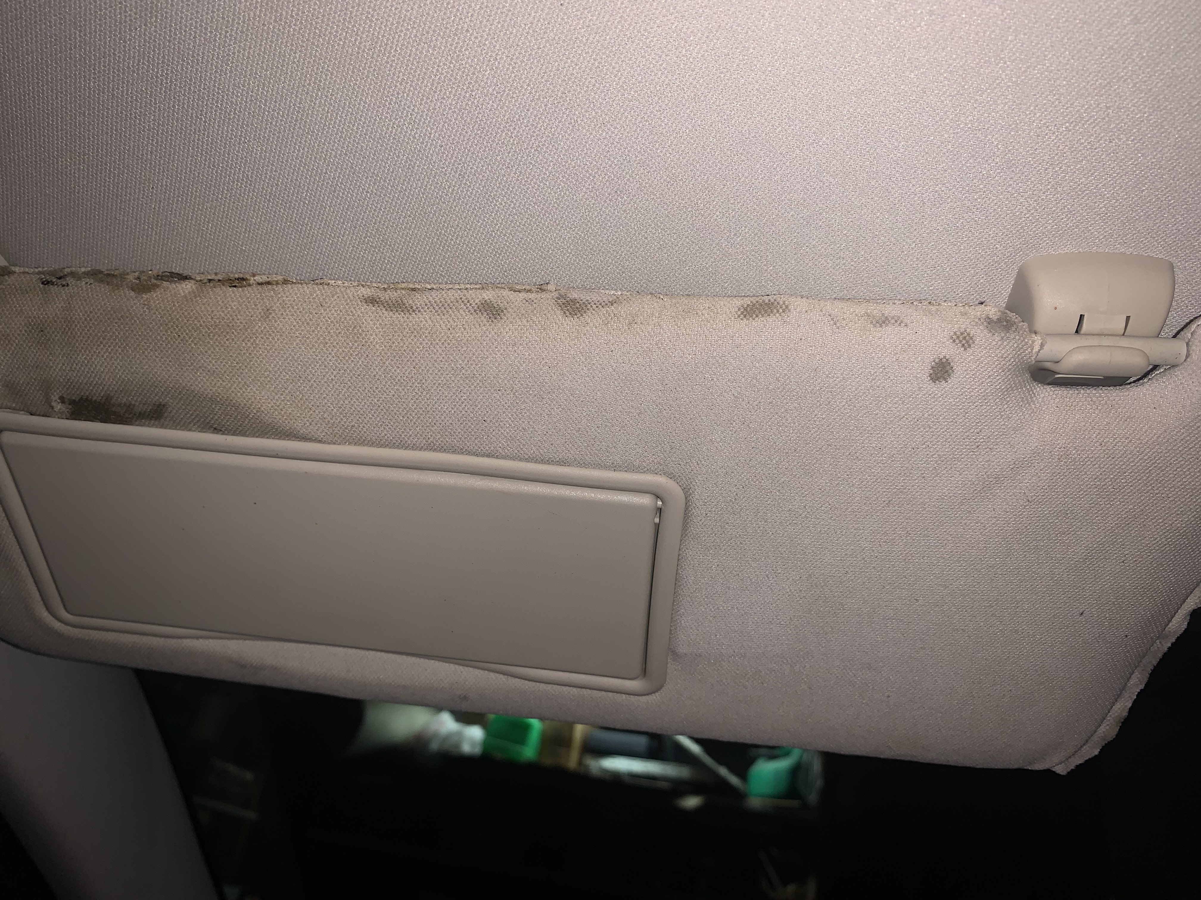

I had gone through my own “I can do routine” before seeing the posts here which are superior to my solution particularly the riveting option which I think will be much neater.
I had to return the bulging piece to its resting position inside the clam shell first then holding the shells together tightly I tried welding the plastic where torn even reinforcing with melted hard plastic and copper wire. This didn’t hold as not strong enough. Then I had to apply black gorilla utility tape strategically but generously to give strength to the closure of the clam shell. Voila that held firm enough for the movements. Anyone with ideas for fixing the cloth problem. It’s the Morzine Cloth Canvas. I will be making this site my first port of call when next I have a problem with my car(XJ Rsport 2015)
With visor in full open position. Bad sealing of the cloth looks unsightly and make the effort at the major problem less appreciated. Actual Sun visor function seem perfect.
Sun visor in partial open position. Holds perfectly!
Sun visor in full closed position. Also perfect hold. It’s a Jaguar therefore this fix is temporary as I have to figure how to get a more befitting cloth cover or may have to ultimately buy replacement when I have loose cash or win the lottery. 🤣🤣🤣

An interior retrimmer would sort that out for you for a very low cost. I think it's a good idea to do both sides at the same time so they match, but that's up to you 🤷
Well done on the fix

Thanks, I’d probably just live with it for now to see if the fix lasts and if the passenger side goes too. I’ll have to take focus off the visor and think less of it and enjoy the car with the visor in closed position not looking too bad and the use in open position is for brief periods. Just glad I got the function back with little ingenuity
