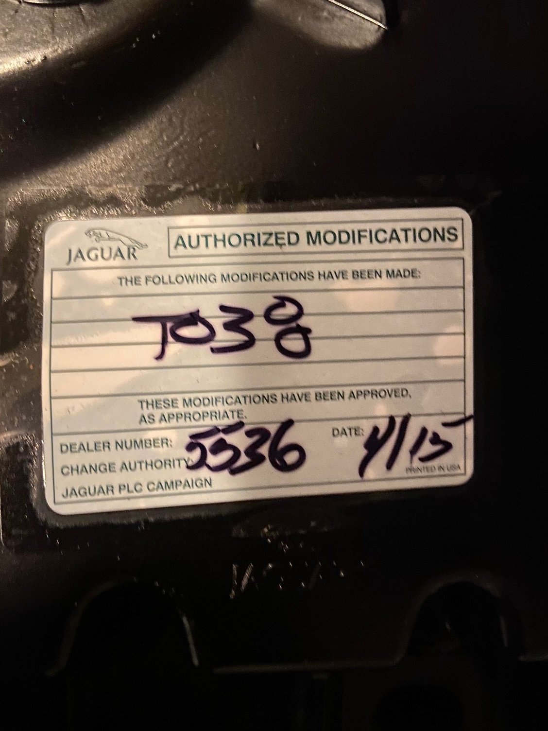

Bought a 2010 Jag XKR a few weeks ago, and this sticker was inside the engine compartment......modification T038. It was done in April 2015. Does anyone know what this could have been for? I thought I was able to Google it before, but cannot find anything now. Thanks in advance.

Try J038
May well be https://f01.justanswer.com/MyMastrMe...aa25eb_Jag.pdf

That’s it!! Thank you!

An issue has been identified on a limited number of 2010-2012 model year XF (X250) and XJ (X351) vehicles and 2010-2014 model year XK (X150) vehicles fitted with the 5.0L V8 engine (naturally aspirated and supercharged) within the listed VIN ranges. The condition may cause the engine Malfunction Indicator Lamp (MIL) to illuminate with Diagnostic Trouble Code (DTC) P0316 in addition to one or more of the P0301-P0308 codes stored in the Engine Control Module (ECM). This condition will have no effect on the vehicle’s performance, but may reduce the vehicle’s ability to control tailpipe emissions.
AFFECTED VEHICLES
The VIN ranges of affected vehicles are:
• XF (X250) ............................R47154-S61361
• XJ (X351) ............................V00001-V39426
• XK (X150) ............................B32753-B54400

What's the fix for this? My VIN is in that range, I don't have any sticker, and I don't have any MIL with misfires. I'd just like to know!

It's your choice. Take it in for the change (at this date they may charge you) or not.
