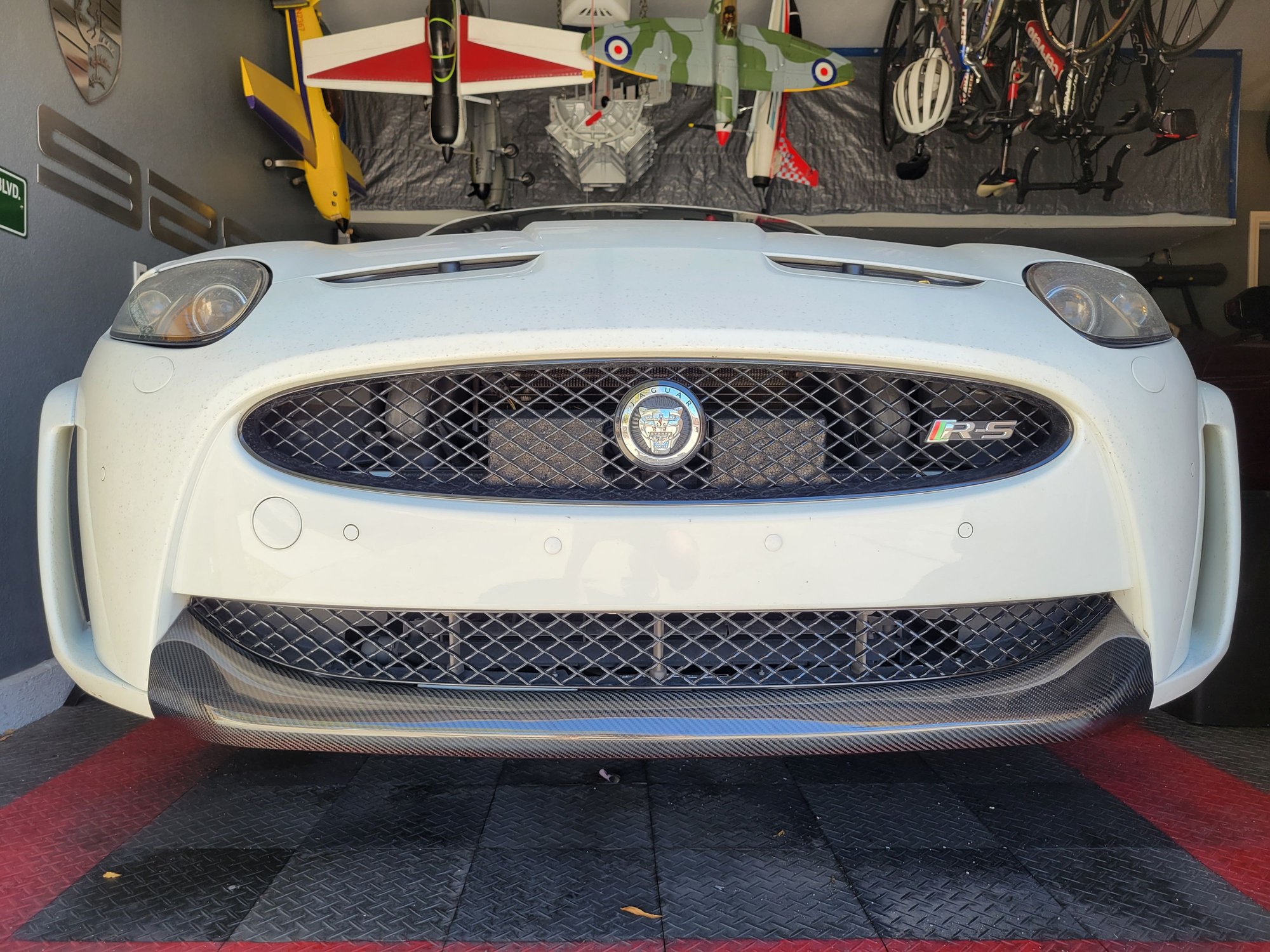

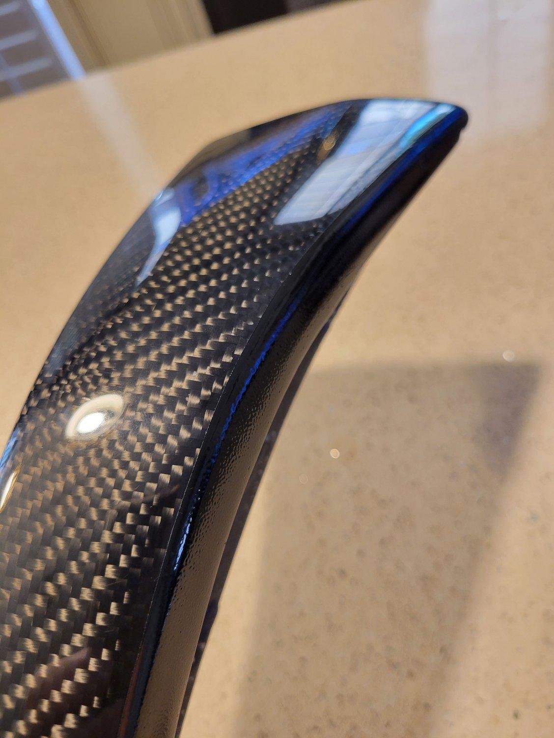

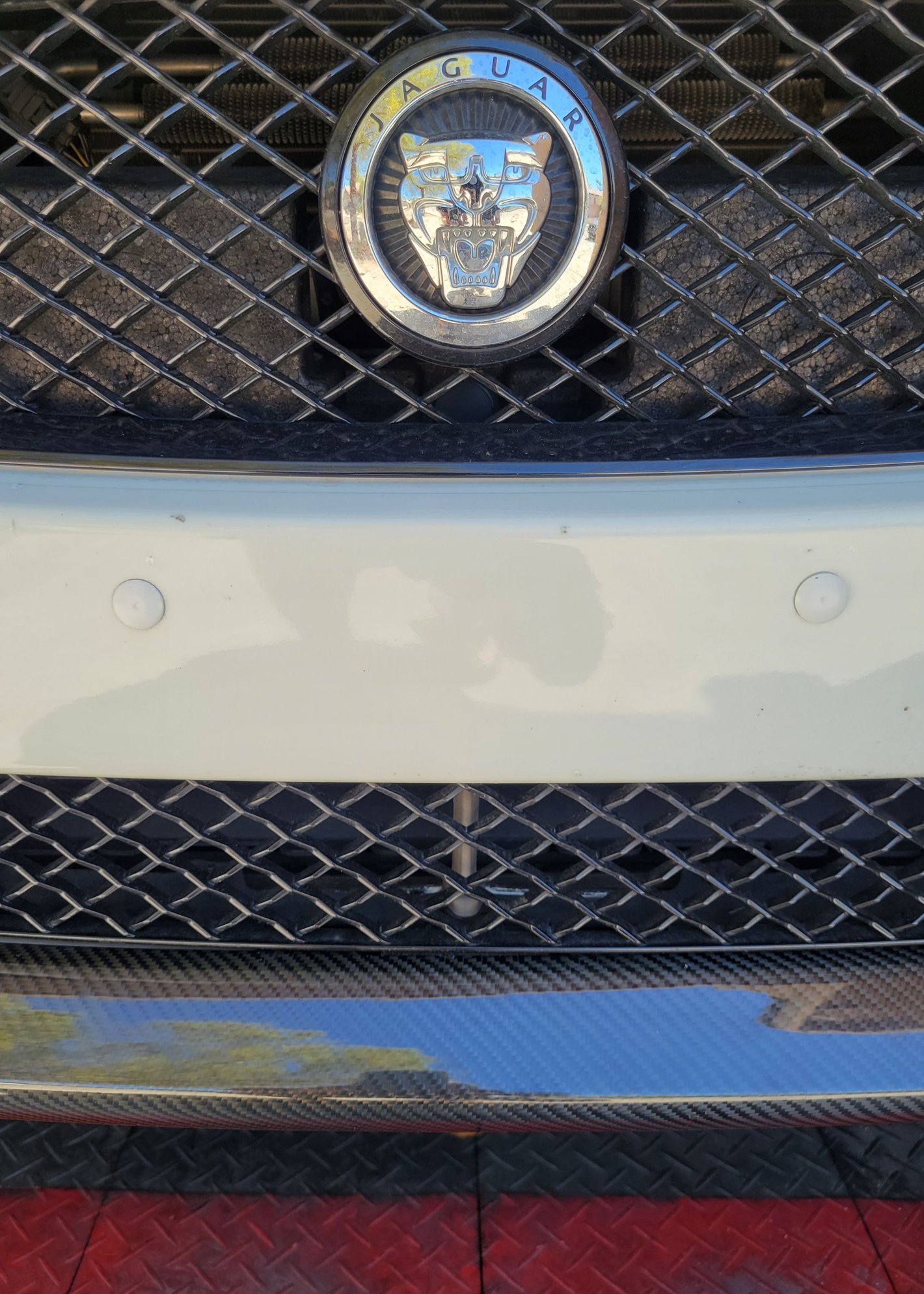

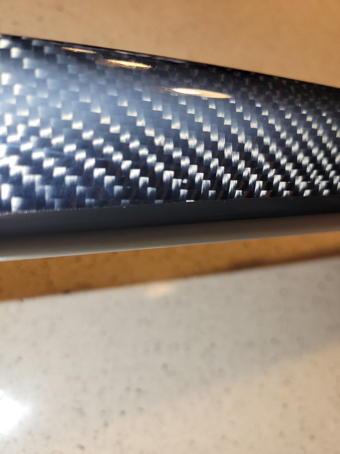

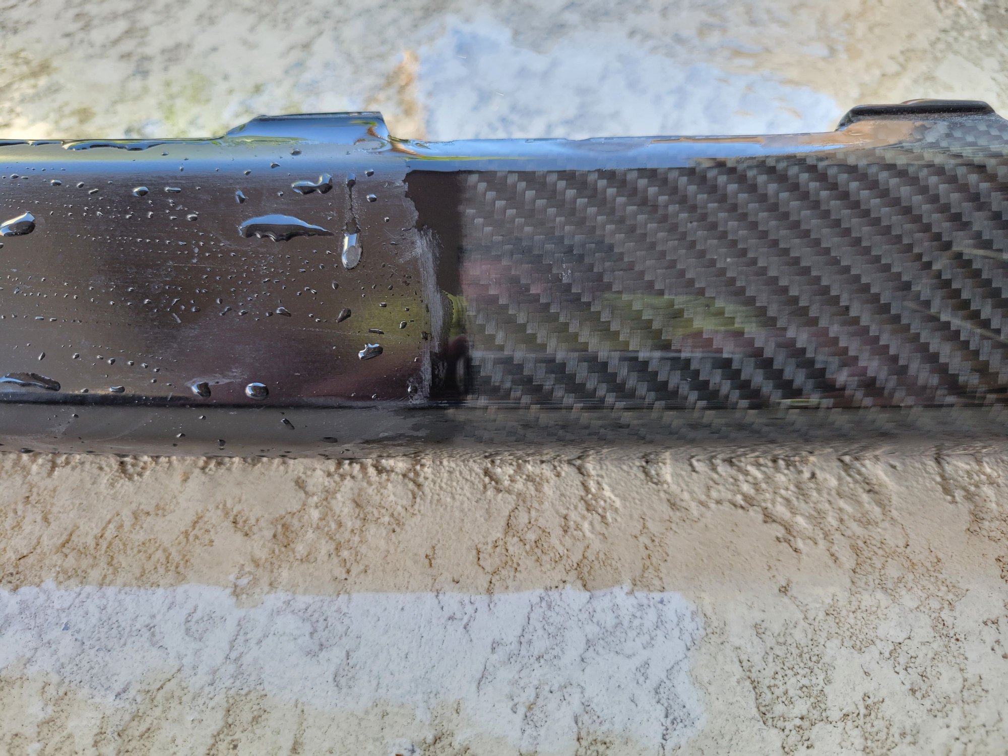

finished my front splitter refurbishment. No, it isnt perfect but it is a far cray from the flat black paint and chipped mess it was.
I removed all the loose resin around the chips and with a brush and some diluted resin i managed to get good penetration under the pealing and flaking areas sealing and bonding them again.. I built the chips up with resin and then sanded them. Once happy i sanded and polished it all again. The underside was pretty beat up but actually cleaned up well. I decided to mask off the splitter and used a gloss black along the lower edge where it is most likely to scrape on my driveway etc. I figure this will be easier to touch up in the future. I guess I could just get a new mina replacement but i had never worked with carbon fiber and the resins before so it was a good learning project. Im happy enough, way better than it was.
added bonus. Powder coater called. Pick up my wheels tomorrow(gloss black)!
Before
Before
After
After

@VegasFPace Really neat work! It really makes the car looks higher level.
You used Polyester or Epoxy resin for the touch ups and final coat?

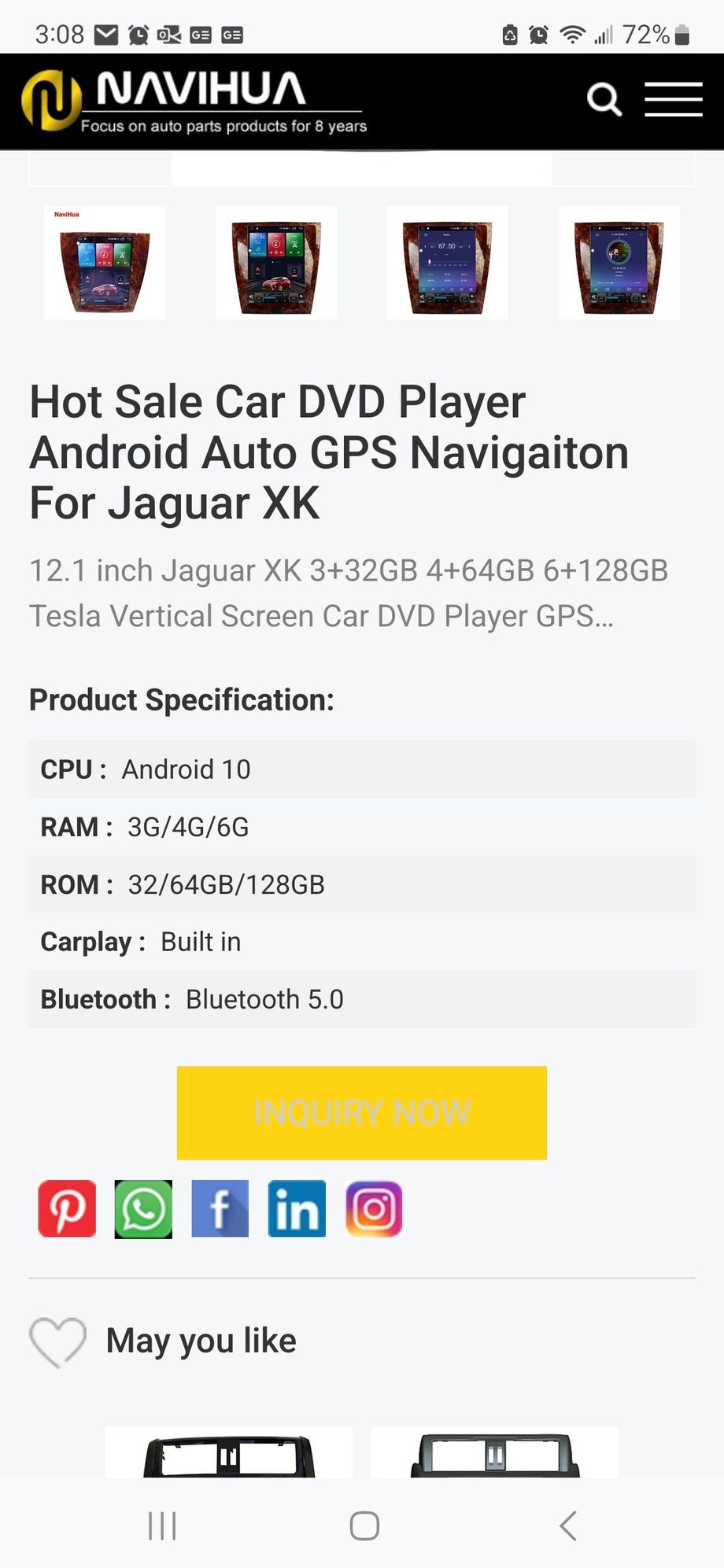

There is an eq system. I guess I was premature in my recommendation of Navihua, the seller of my radio. As described in an earlier post, the hazard/pass seat belt switch doesn’t work. After much back and forth, sending video of a switch not working and testing the wires, they have stopped responding. I have no hazards and the airbag light is on. I’m posting this in the hopes that someone here knows how I can fashion a new switch or buy one somewhere…frustrating…
