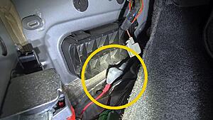

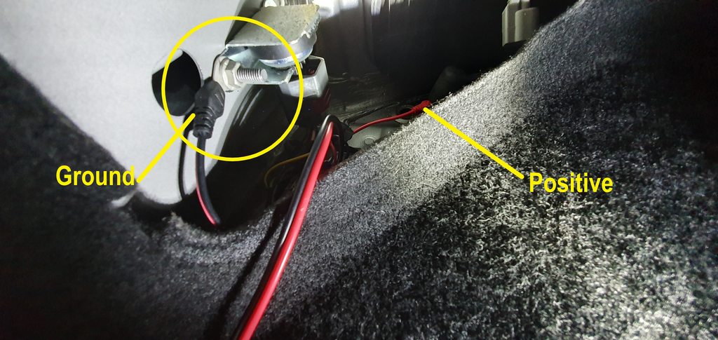

Second was 'permanently' installing my new CTEK charger. As you can see, I hooked it up to the jump start positive terminal behind the small access panel in the rear left of the boot/trunk. I connected the ground to a handy bolt close by. As I have the CTEK connector with the small LEDs which monitor the state of the battery charge with a 'traffic light' system, I chose to leave the lead visible in the boot/trunk. If I had the regular lead, I'd probably leave it hidden behind the small access hatch. Either way, it's a neat job and it makes it real easy to hook the CTEK unit up when I am not using the car regularly over winter.

The positive cable connected to the jump start connector:
The negative/ground cable connected to a handy bolt.
