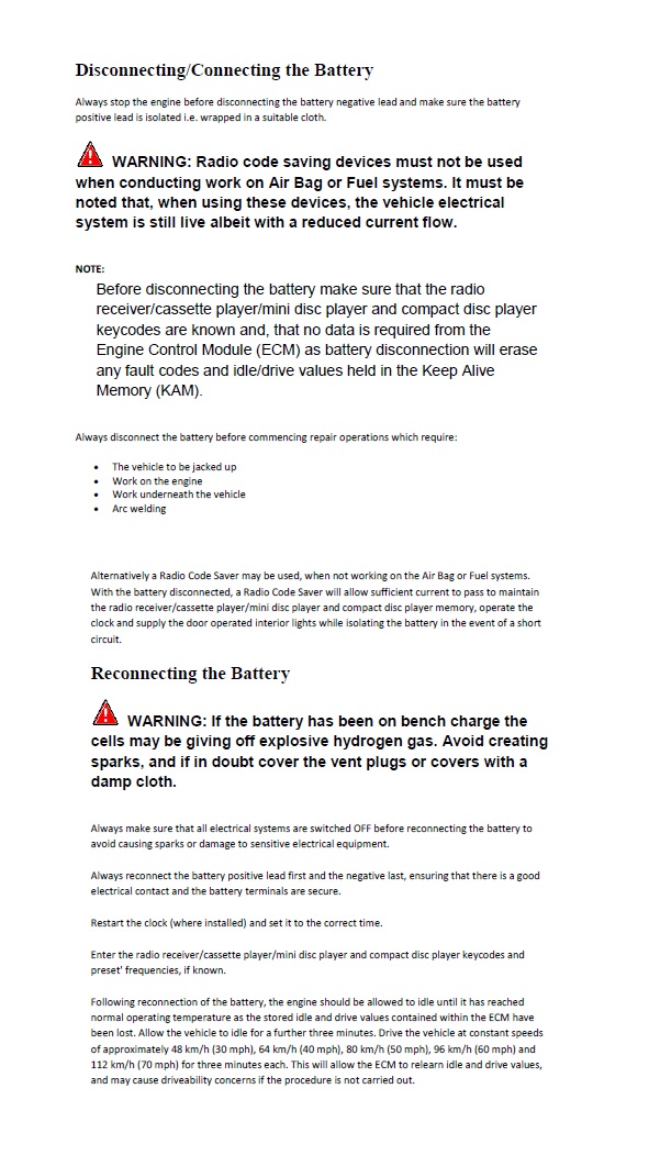

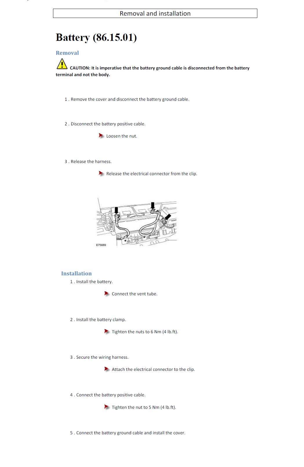

Here's the relevant section on battery disconnect/reconnect from the Workshop Manual:
( click on the images to enlarge them )
I'm surprised there are no further procedures detailed in the XK/XKR Manual as earlier Jaguar models have a number of 'learned' pre-sets to be reset following a battery disconnect.

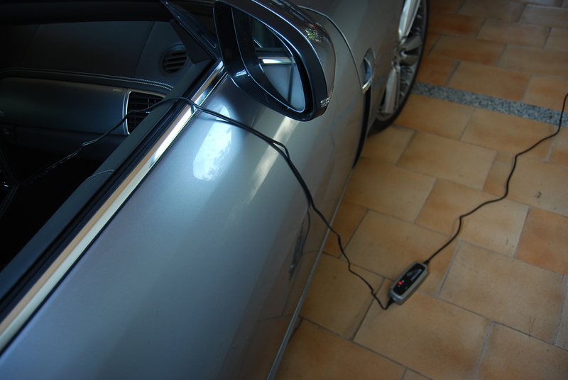

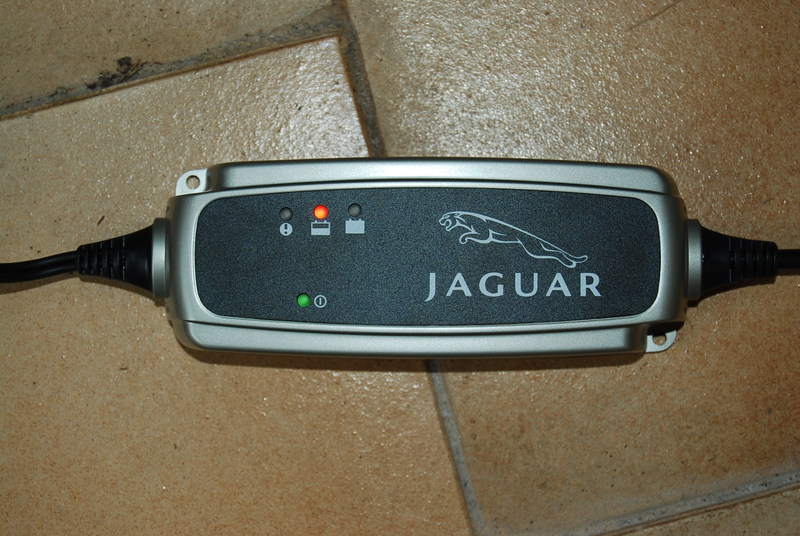

Here is the battery charger price was indeed 156 euros I did not understood well, well I got 15% off from them. I recommend it cause its small and simple to use.

[QUOTE=jagxk2008;786537 Here is the battery charger price was indeed 156 euros I did not understood well, well I got 15% off from them. I recommend it cause its small and simple to use.[/QUOTE]
This battery charger is made by CTEK, and just has the Jaguar logo on it, just as Porsche and BMW does and they sell it for a big price.
You can buy this charger on Amazon for $52.00 and it's actually better with more functions than this charger shown above. I use it on my 2009 XKR, and always have a fully charged battery, never a failure. It's a trickle charger that adjusts the voltage flow. Easy install....2 to 3 minutes.
Amazon.com: CTEK Multi US 3300 12-Volt Smart Battery Charger: Automotive Amazon.com: CTEK Multi US 3300 12-Volt Smart Battery Charger: Automotive
I have suggested this charger several times in this forum. Those who have made the purchase seem well pleased with the suggestion.

Where does that one plug in? The cigarette lighter?
Old Aug 9, 2013 | 05:20 AM
jagxk2008's Avatar
Joined: Nov 2012
Posts: 1,037
Likes: 85
From: Espana
to any holes, 12 volts plugs, either the cigarette lighter, inside glothes box, or better in the rear trunk, i did not have enough lenght to do so. But not to the battery.
