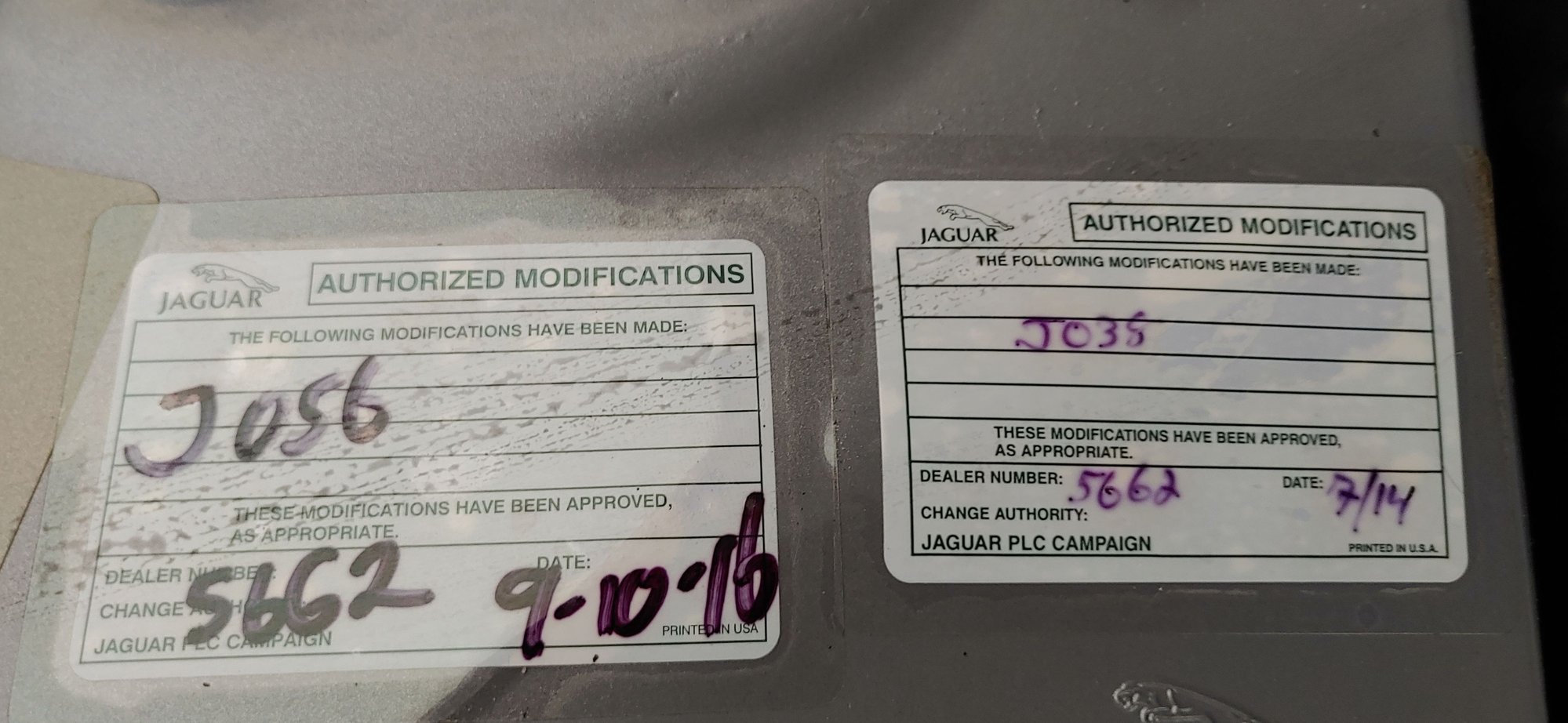

can't find info on this, maybe I didn't look hard enough. I'm guessing recall repair? Does anyone know the meaning of the "JO56" and "JO35"

Recall stickers, showing the work was done...

Thanks! I guess "authorized modifications" sounds cooler than "recall modification"

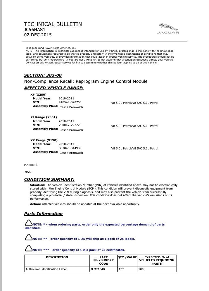

Here's the J056.

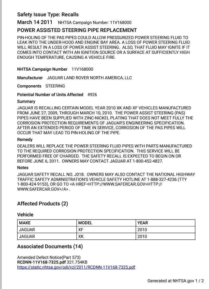

I think this is the J035:
