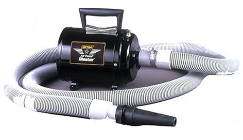

One point on the window peeling away from the canvas top.
When I wash my 2009 XKR, I make sure that all water is removed from the lower window seem.
I use an Air Force Master Blaster to dry all my premium sports cars. The Air Force Master Blaster quickly removes water residue from all open areas that normal hand drying with a microfiber towel can not get. This is a great detailing tool to have. It blasts the water out of all seems around headlights, trunk seems, door jams, and the rear window on the Jag.
You need to make sure the lower rear window seem is dried well. This is the spot that most people see the window pulling away from the top.

... I use an Air Force Master Blaster to dry all my premium sports cars. ...
No need for me to buy a specialized blower. I just use the Toro Ultra blower vac that I bought years ago for my yard. Adjustable speed, works great. Just follow up with a microfiber towel to finish the job.
