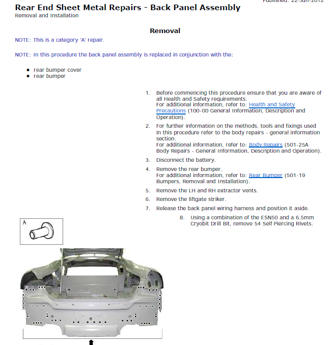

Originally Posted by gjjaguar
Great job getting it running!!!! Congratulations!!! I would still like to know what manual you are using for all this?
For like $10 you can purchase the workshop repair manual from Jagdocs.
It details the necessary repair tools and methods as well as rivet part numbers and their respective grip ranges. It details the process steps involved in disassembly and reassembly of practically the entire car
Here is a screen shot of the cover and an example of the first few steps of one of the rear end repairs
Attached Thumbnails Winter Project:  Salvaged 2008 XKR-manual.png   Winter Project:  Salvaged 2008 XKR-rear-panel.png
