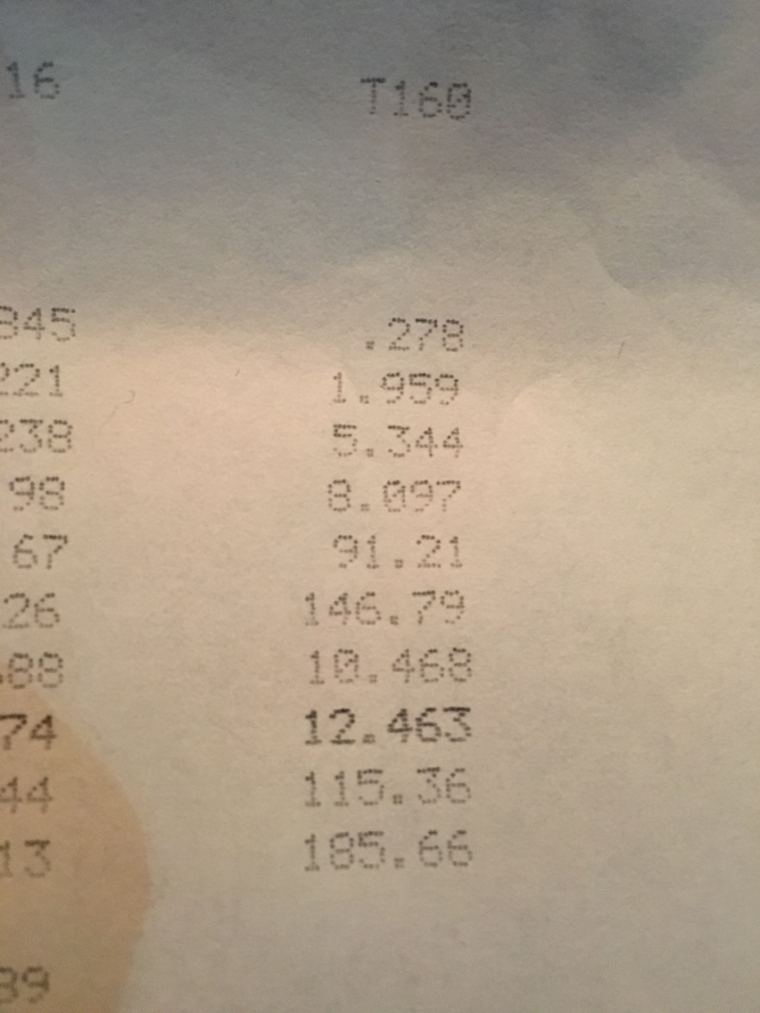

Default World's quickest/fastest 4.2L XKR... again.
World's quickest/fastest 4.2L XKR... again.-photo434.jpg
World's quickest/fastest 4.2L XKR... again.-photo58.jpg
Yes, yes, yes.

Well done!
That is very close to the terminal speed of my 5 litre XKR when it was stock (115.73) and also better than my best standing quarter with the XKR-S tune (12.521).
Now I have sticky tyres though I hope to get much closer to 12 secs when I try again at the end of September.

definitely fix the blower wine , thats priority . and worth a few side affect HP TOO.
or is the stock duel intake on these quite efficient to the point it only aids sound un like the old single ones ?
i'm guessing your tune will be delaying any timing retard regardless ?. and by the look of your trap speed it did not retard due to IAT2 Anyhow ..
but one thing i have learned with the STR , is increased liquid capacity in the intercooler set up is a great work around .
and a very cheep mod . may be give that a go if you are looking for charge temp aid , before any high end pricy mods .
that 60ft is golden mate , keep that up .

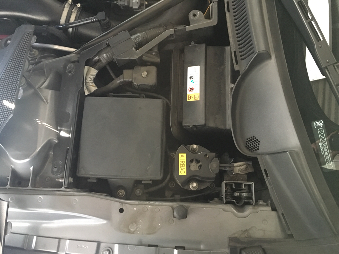

There is very little free space under the bonnet in the XKR, there is a spot where a 2-3 litre tank could fit, but it would have to be custom fabricated to fit, which would be quite expensive to produce unless you're a fabrication guru who can cut, shape & weld aluminium yourself. Which i'm not....

FYI I have a 3 litre tank fitted perfectly in the empty space in front of the cabin air filter housing.

No such space on a RHD car unfortunately...
World's quickest/fastest 4.2L XKR... again.-photo975.jpg
