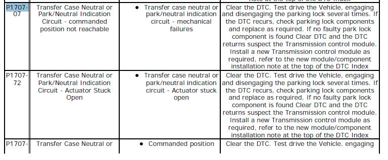

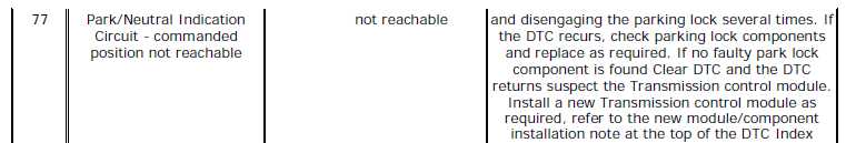

Originally Posted by andres_g_d
In my jagua XK 2011 has the faliure code P1707 in the transmission
See attachments - try repeatedly engaging and disengaging the transmission parking lock.
