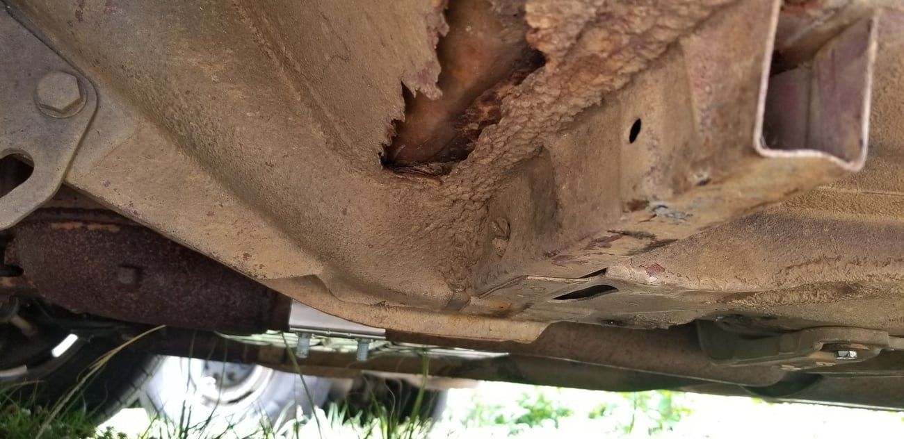

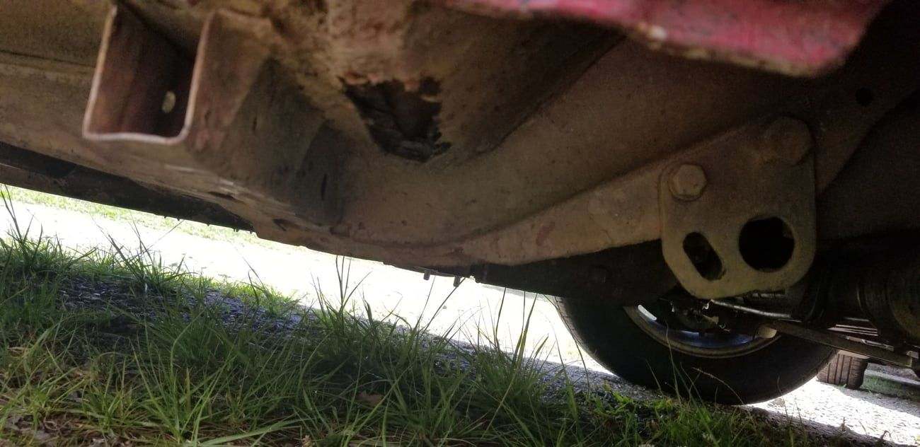

Thanks to all for the advice. Those items are thick steel. Would take a lot of rust to rise to a level of structural integrity. I have a lift so treating and/or replaceing doable. Looked and those parts are on eBay for not much. Read stories of 308s going into a shop and they won't put it up on the lift because lift points could collapse. Below pictures are what I feared. If bid, amount will be not more than I could get from a part out. For my XJ8 LS swap bought a 2002 XJ8 with a bad tranny and clean title and a front crunched but drivable 2001 XJR with a salvage title. Bought the XJR for the asteroid wheels and a near perfect interior that went into the XJ8. Sold engines and many other parts for about $2000 more than I paid for both cars.

Those pics you posted are not an XK right?
I was wondering the same thing. Couldn’t figure out what I was looking at.

Correct. That’s a 308.

You won't see that kind of issue so typical of the steel bodied models on an X150.
