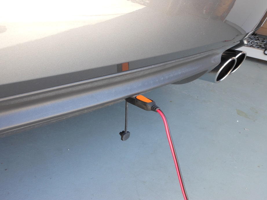

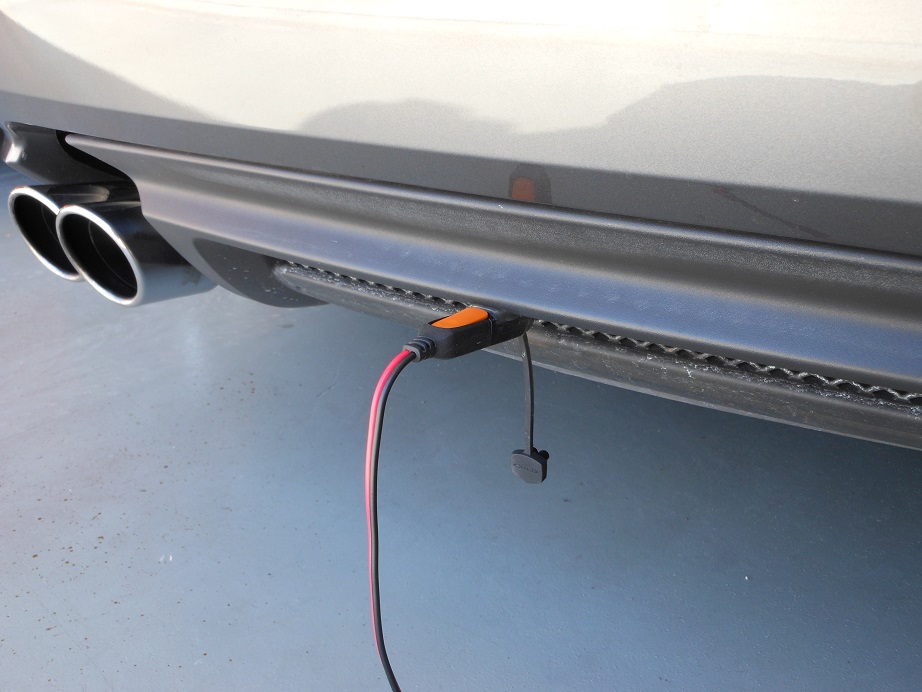

Order the CTEK MUS 4.3 Multi Step Charger from Amazon. The price is great @ $63.12. The kit has everything you need to keep your XK fully charged all the time. I own a 2009 XKR, and the car is ALWAYS connected to the CTEK when not driven, whether it's one day of rest or 3 weeks of rest. The CTEK MUS 4.3 multi charger is an 8 step charger that can be connected directly to the battery. You might want to consider the CTEK Comfort Extension which provides an additional 8' feet of cord.
Amazon.com: CTEK (56-864) MUS 4.3 12 Volt Fully Automatic 8 Step Battery Charger: Automotive Amazon.com: CTEK (56-864) MUS 4.3 12 Volt Fully Automatic 8 Step Battery Charger: Automotive
Amazon.com: CTEK (56-304) Comfort Connect Extension Cable: Automotive Amazon.com: CTEK (56-304) Comfort Connect Extension Cable: Automotive
This will help keep your battery 100%
Connecting the CTEK the way I have the plug in the images below, you never have to open the trunk lid to make a connection.
Click on the image once to expand then click again for full screen image.
Attached Thumbnails XK won't start-dscn0877.jpg   XK won't start-dscn0878.jpg   XK won't start-dscn0879.jpg   XK won't start-dscn0880.jpg
