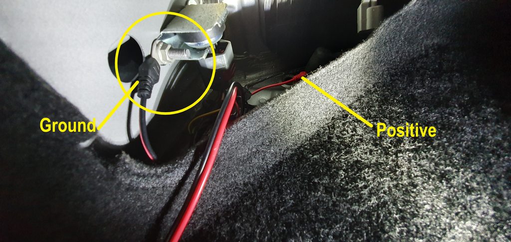

Here's how I installed mine:
This pic shows the positive terminal behind the cover in the trunk. The rubber cap is in the way in the photo - the CTEK fly-lead connector is attached by removing the nut, placing the fly-lead connector and replacing the nut.
This shows where I made the ground connection.
This is all you see in the trunk after installation.
