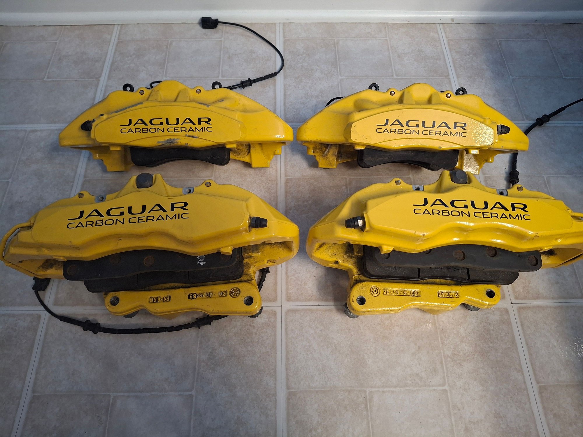

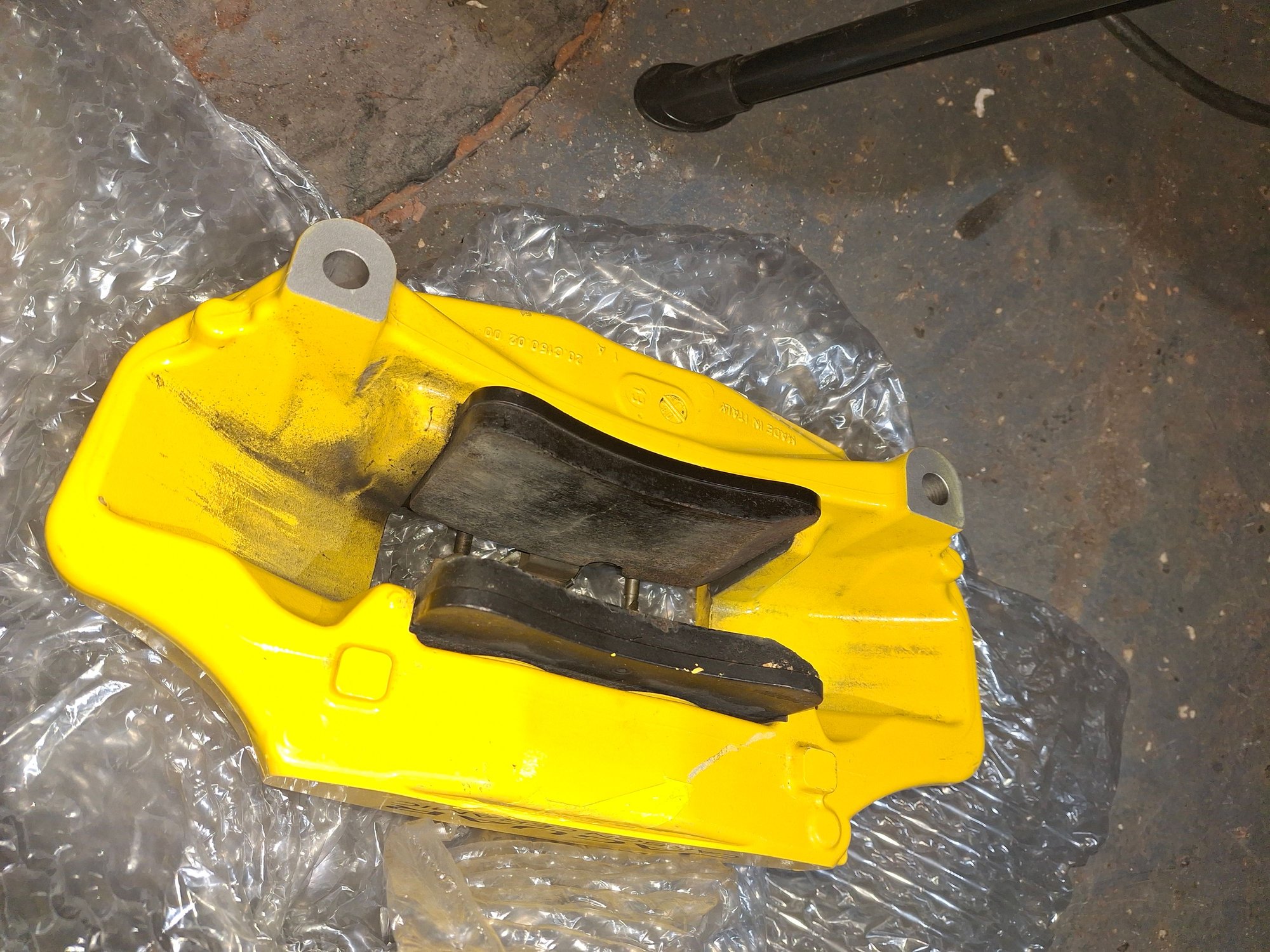

Hello everyone, I have a question about brake calipers for a 2013 XKR. Is it possible to install yellow carbon ceramic calipers by replacing certain suspension elements or installing a conversion kit?

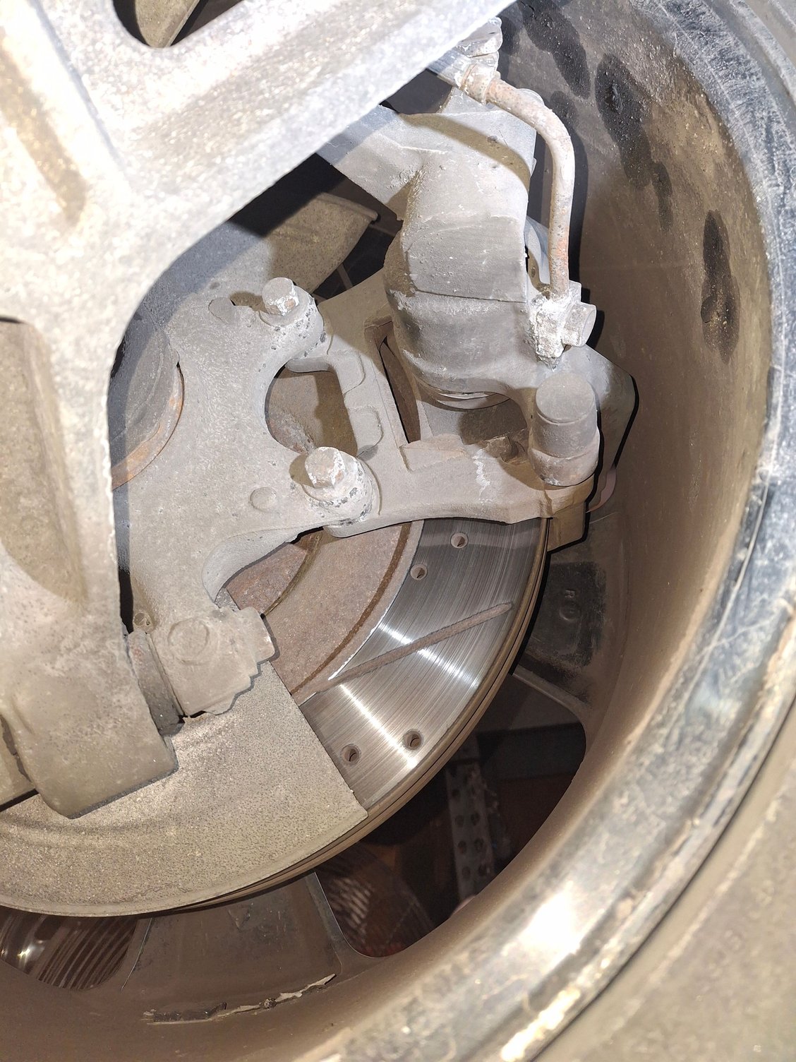

I have bought four calipers and I was at the brake mechanics and it turned out that the front ones are able to fit but the rear calipers have a completely different bolt location. Thanks for all the tips in advance.

Those calipers are the Brembo carbon ceramics from the F type. The fronts will fit straight up with no modification, but the rears will require a new knuckle as well as no rear park as the F type had an electronic rear Park brake.

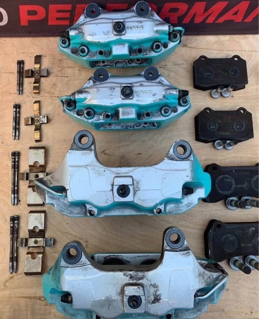

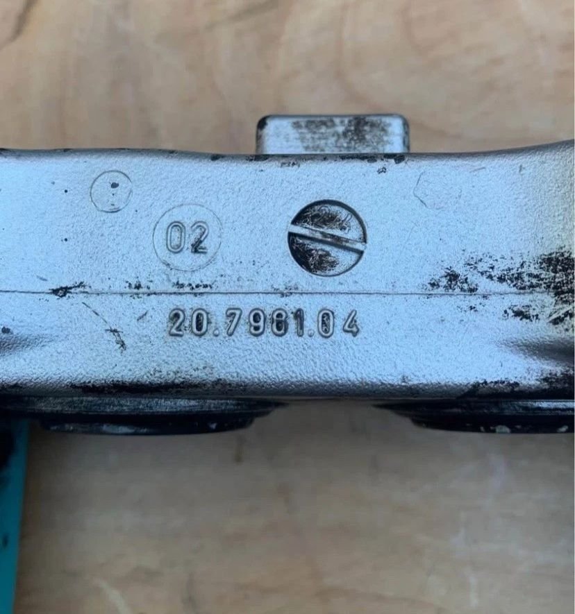

Hello, can anyone advise whether these Brembo brake calipers from the older model will fit the 2013 XKR?
