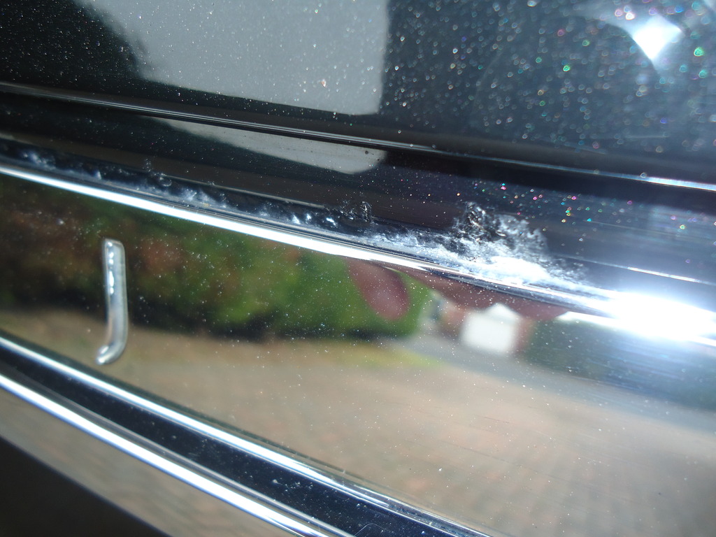

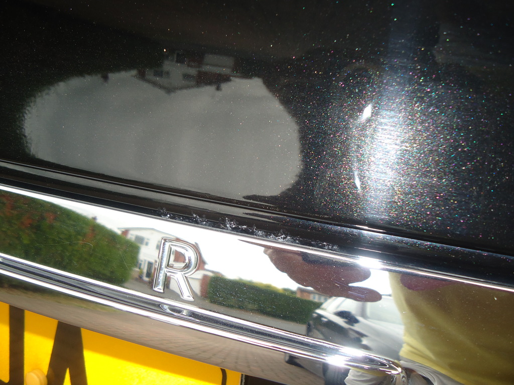

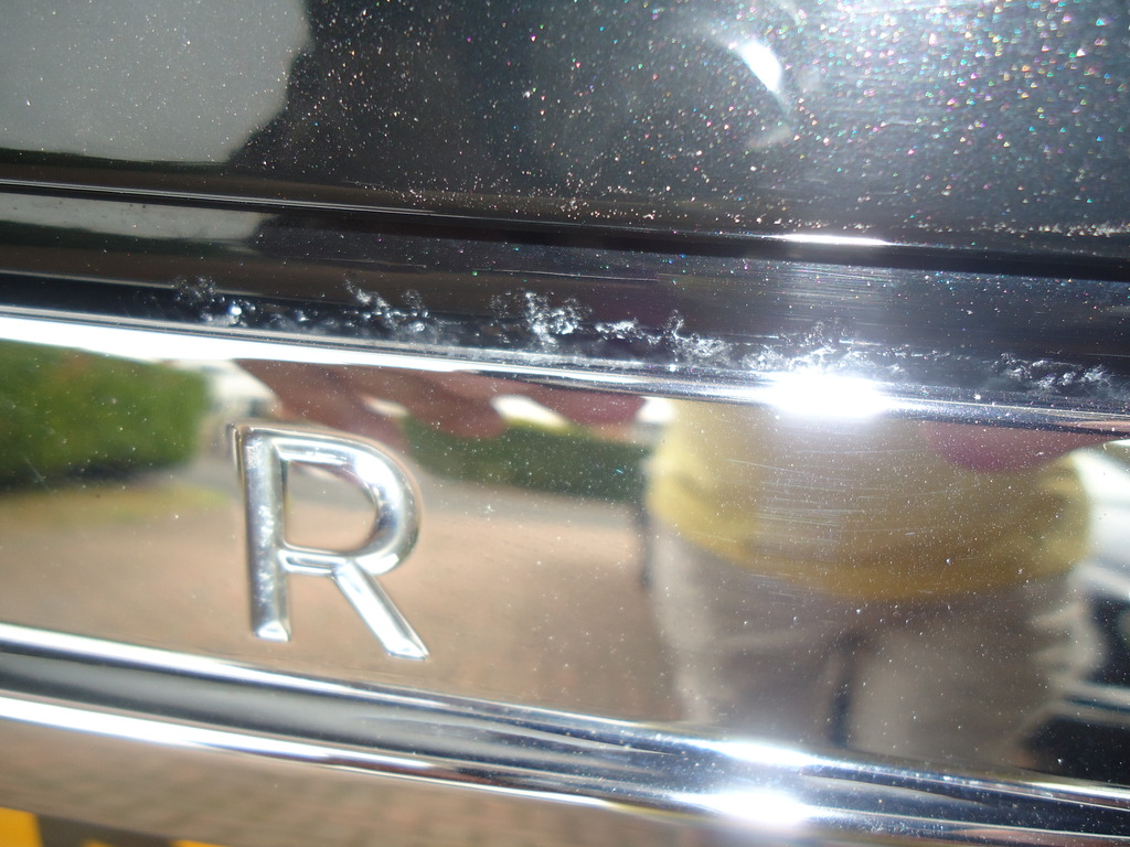

I bought my 2011 registered XKR (pre-face lift model) from a Jaguar dealer at the beginning of July. When I washed it two weeks later, I noticed bubbling of the paint on the boot/trunk lid just above the chrome 'Jaguar' strip. Apologies for some of the reflections in the photos below.

I complained to the dealer by e-mail with the photos requesting that it should be put right under warranty before it got any worse. I said that it was a known fault having been discussed on various Jaguar forums (in UK) relating to XF and XK models - they immediately asked me to take the car in so they could have a look for themselves. They agreed it was corrosion possibly caused by a bi-metallic reaction between the aluminium of the boot lid and the chrome strip, took their own photos to submit with a warranty claim to Jaguar and said they would get back to me. No doubt partly due to holidays etc. it was four weeks before I heard the good news that my claim had been accepted and Jaguar had authorised the body shop used by the dealer to carry out the remedial work. It took a further 3 weeks plus a bit of chasing by me to get a date fixed - the job was done last week. The result is perfect, as you can see.

In addition to removing the corrosion and re-painting, the fix includes putting a plastic strip between the two metals to prevent the reaction taking place so hopefully it won't come back to haunt me!
