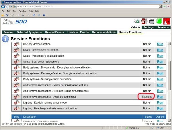

SDD v130 works offline. Here's the Jaguar technical bulletin providing the username and password to use it offline.

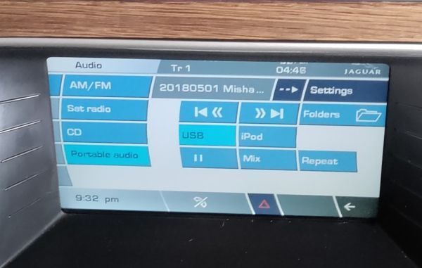

Just to close the loop on this… I successfully enabled AUX this past weekend using an Iota DLS-75 to maintain the required more than 12.5 volts, SDD v130 that had the necessary configuration file, and a Ford Rotunda VCM.
Here’s what the touchscreen looked like before and after enabling AUX.
Portable Audio Options – Before Enabling AUX
Portable Audio Options – After Enabling AUX
On a side note, I added a voltmeter to the Iota power supply so I could accurately dial in its potentiometer to the desired 13.4 volts on its nameplate.

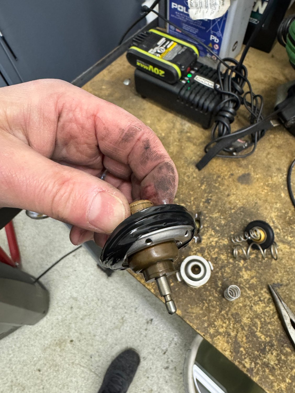

As spring is in sight we have had a few warm days so I’ve taken the opportunity to take the car out, only to get an engine warning light. On checking it’s a P0128 which generally is caused by a thermostat failure.
Drained just shy of 1 gallon from the cooling system and removed the thermostat, super easy job and there is a DIY on this forum. As expected my thermostat rubber had failed
My seal had not split, it just stretched allowing water to pass, not the best design. But the replacement was only $40. It takes longer to refill the cooling system than it does to replace the thermostat. More frustrated that I didn’t do it when I flushed the cooling system a few weeks ago.
So a tip to anyone doing a coolant flush, replace the thermostat at the same time as it will definitely fail with age

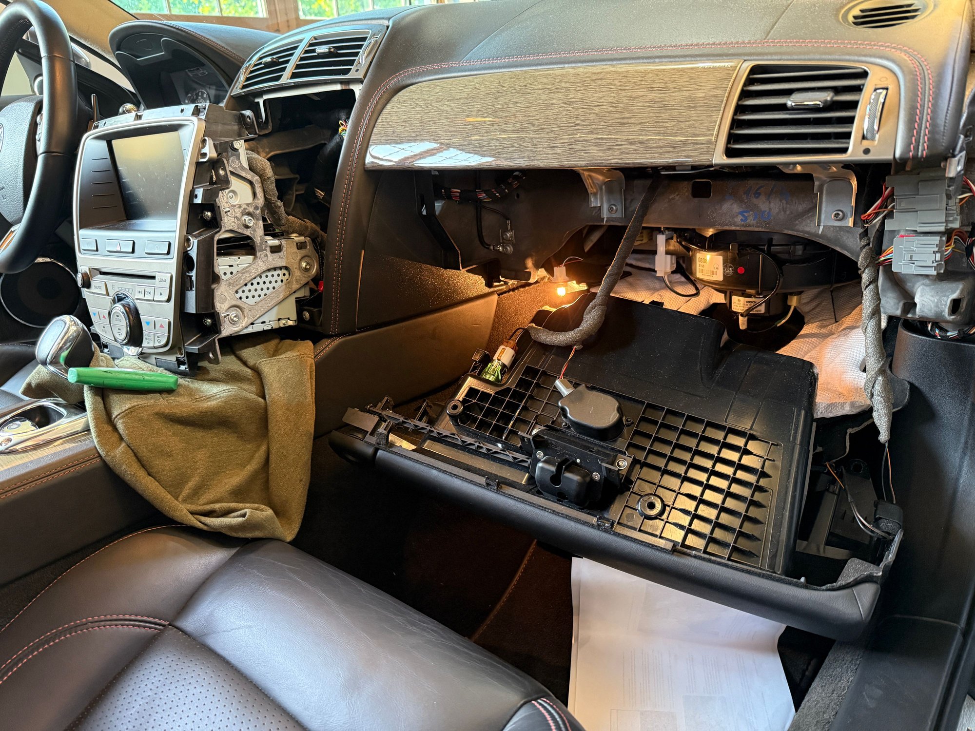

I purchased the Jag Wrangler Bluetooth system for my car, first of all a big thank you to @Sean W who enabled the AUX on my car.
Happy that I now have music streaming/podcasts.
Simple to fit with excellent instructions all
you need is a T20 and T30 torx and it plugs into the back of the touchscreen.

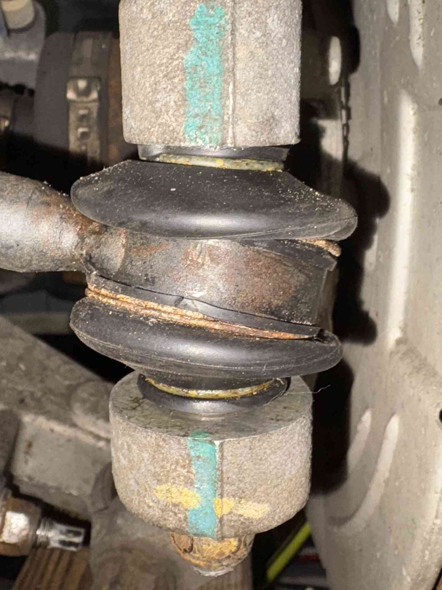

Removed the rear suspension arms from the drivers side today, every rubber boot was perished
@D6LC what did you use, or how did you refit the boot spring retaining clips. Currently struggling to get the clips back onto the new boots on mine.

I lockwired mine as replacing the was extremely difficult

Fortunately, the suspension parts in our cars (other than the boots) are quite robust. Owners have driven many miles before even discovering the boots are gone! It's quite a job to replace everything. I was quoted almost 3 years ago $7500 to replace all original Jaguar parts through Jaguar. I can't imagine what the number would be today.

Got my retaining clips installed - should have asked Google sooner. Found this you tube method that worked well
