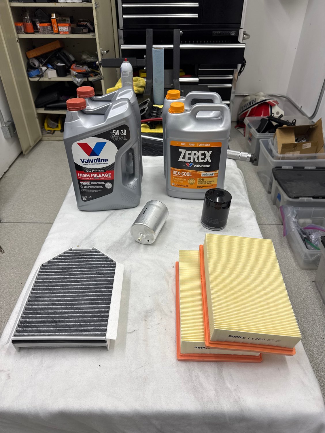

Service time, happy day in the garage prepping for spring, spark plugs on their way and need to pickup some brake fluid. Pretty shocking how cheap it is to service these cars

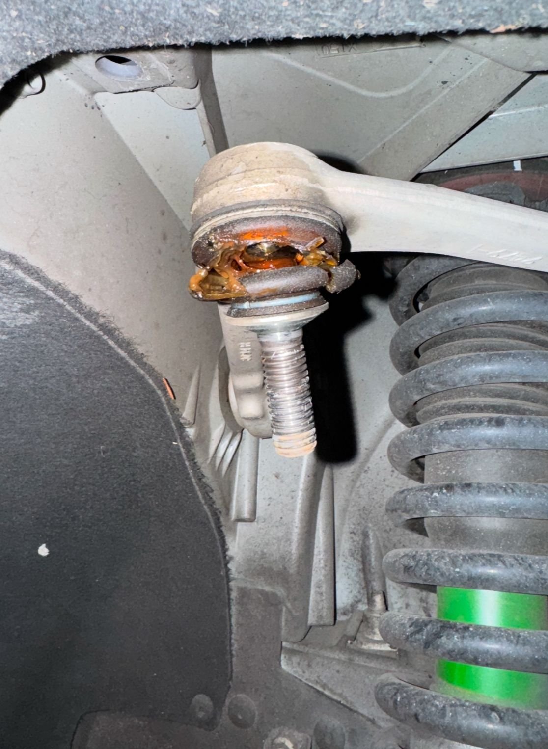

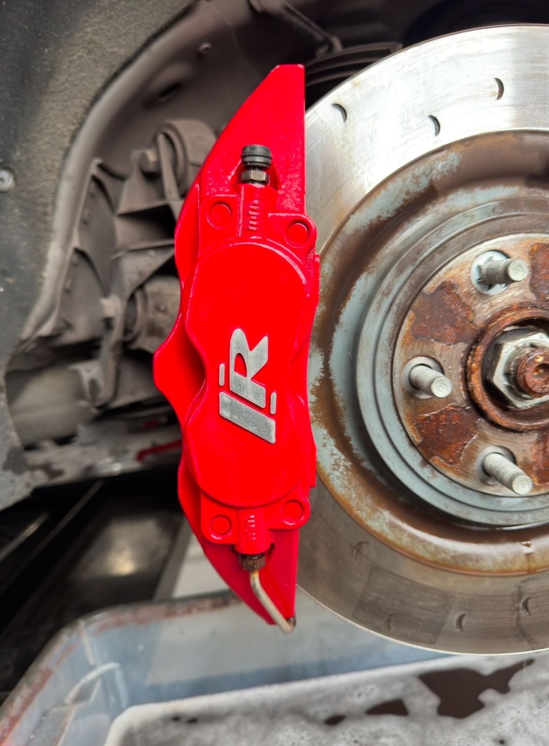

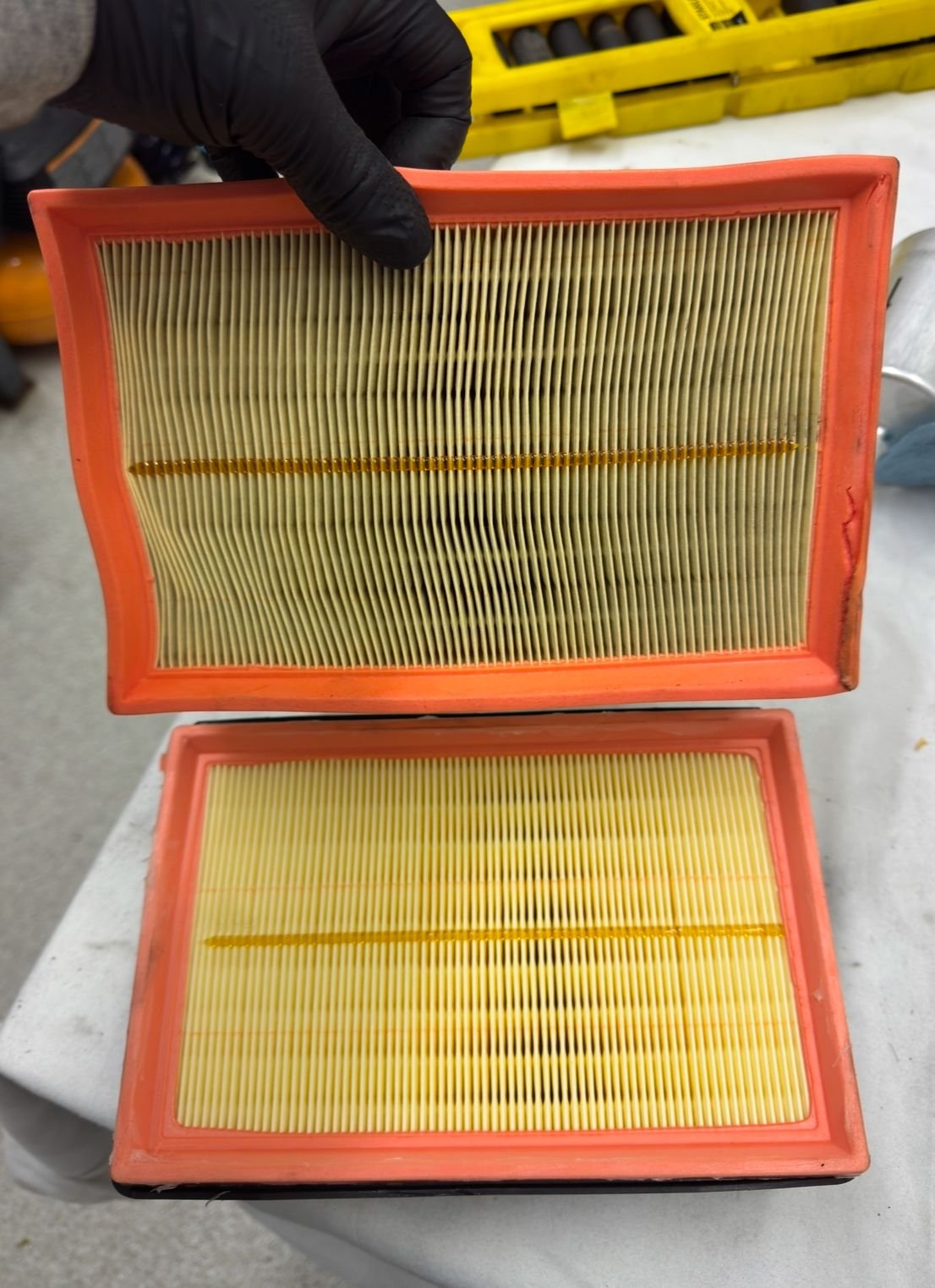

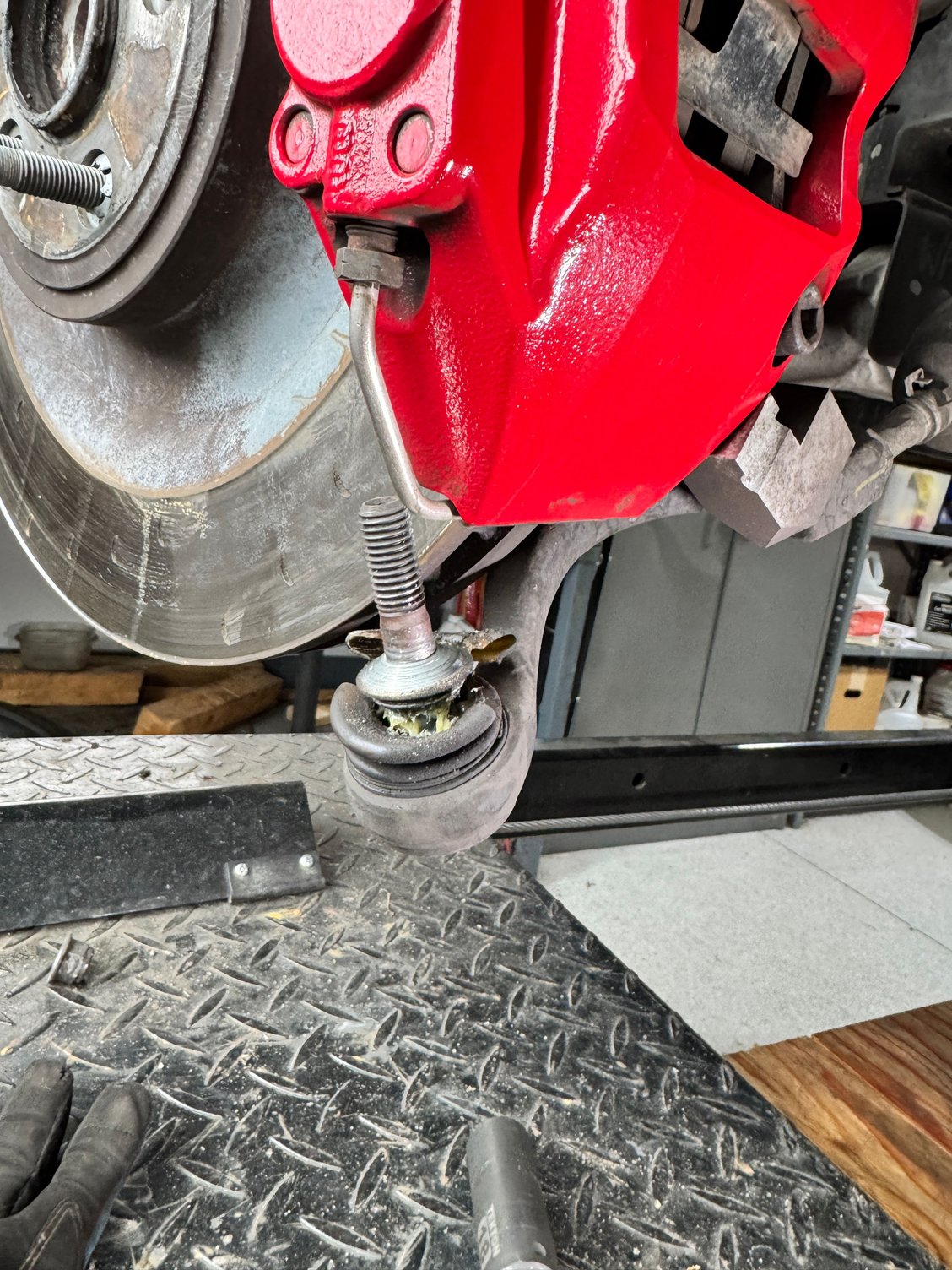

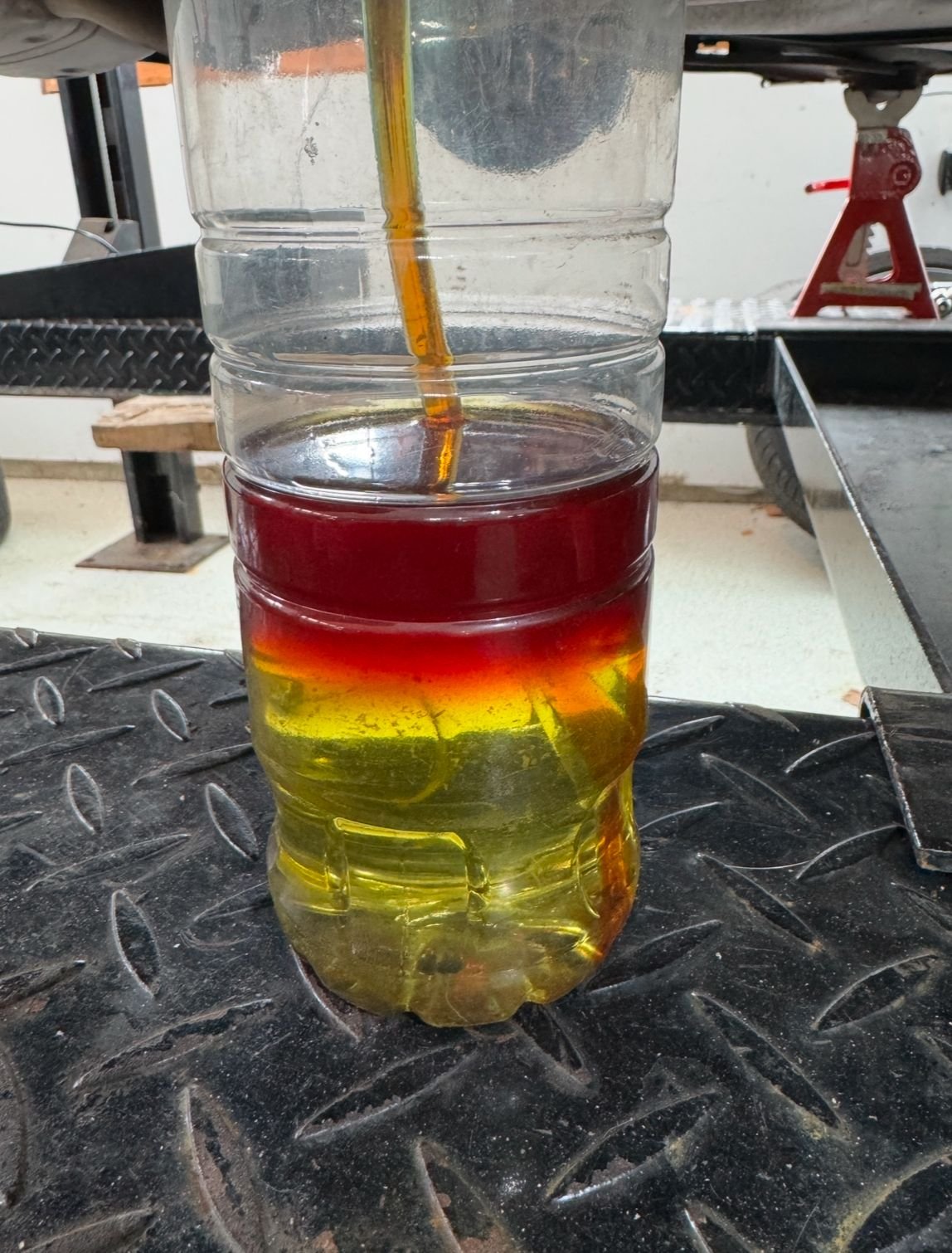

Good few hours on the car, oil and filter, cabin filter, spark plugs and air filters. It’s a nice car to work and and very easy to get around, as a simple tip if you change your air filters give the sealing lip a smearing vasaline to help refit it. All my filters were in great shape,

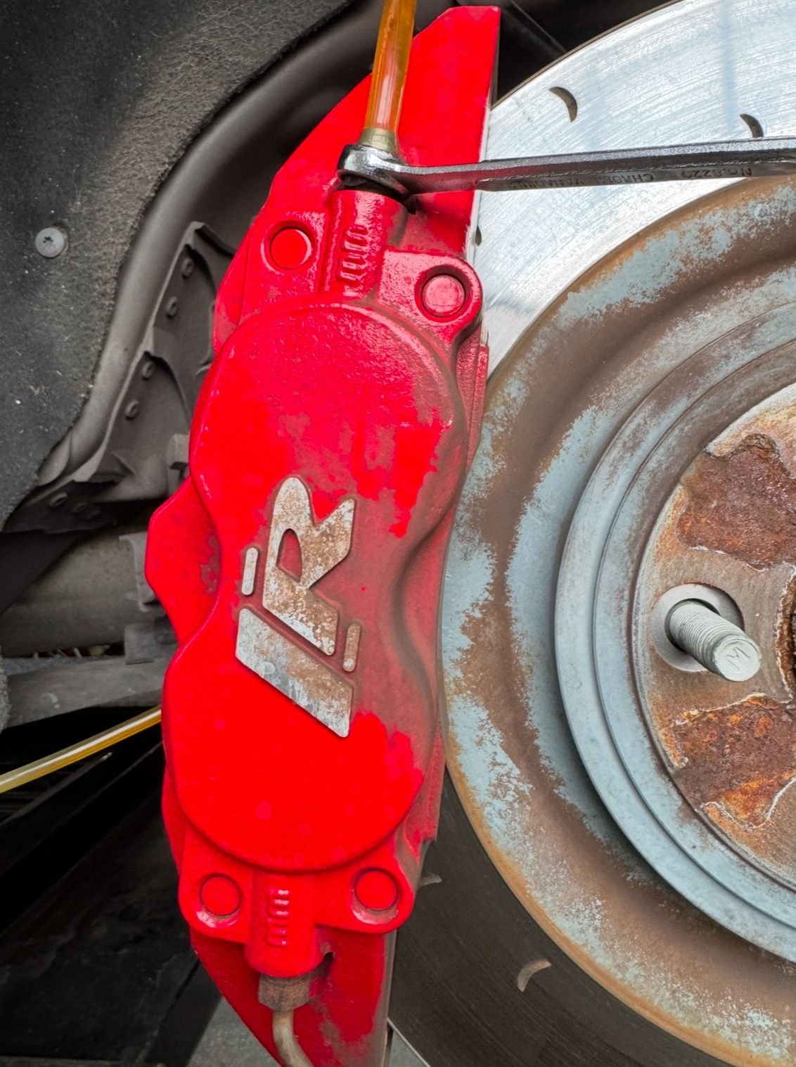

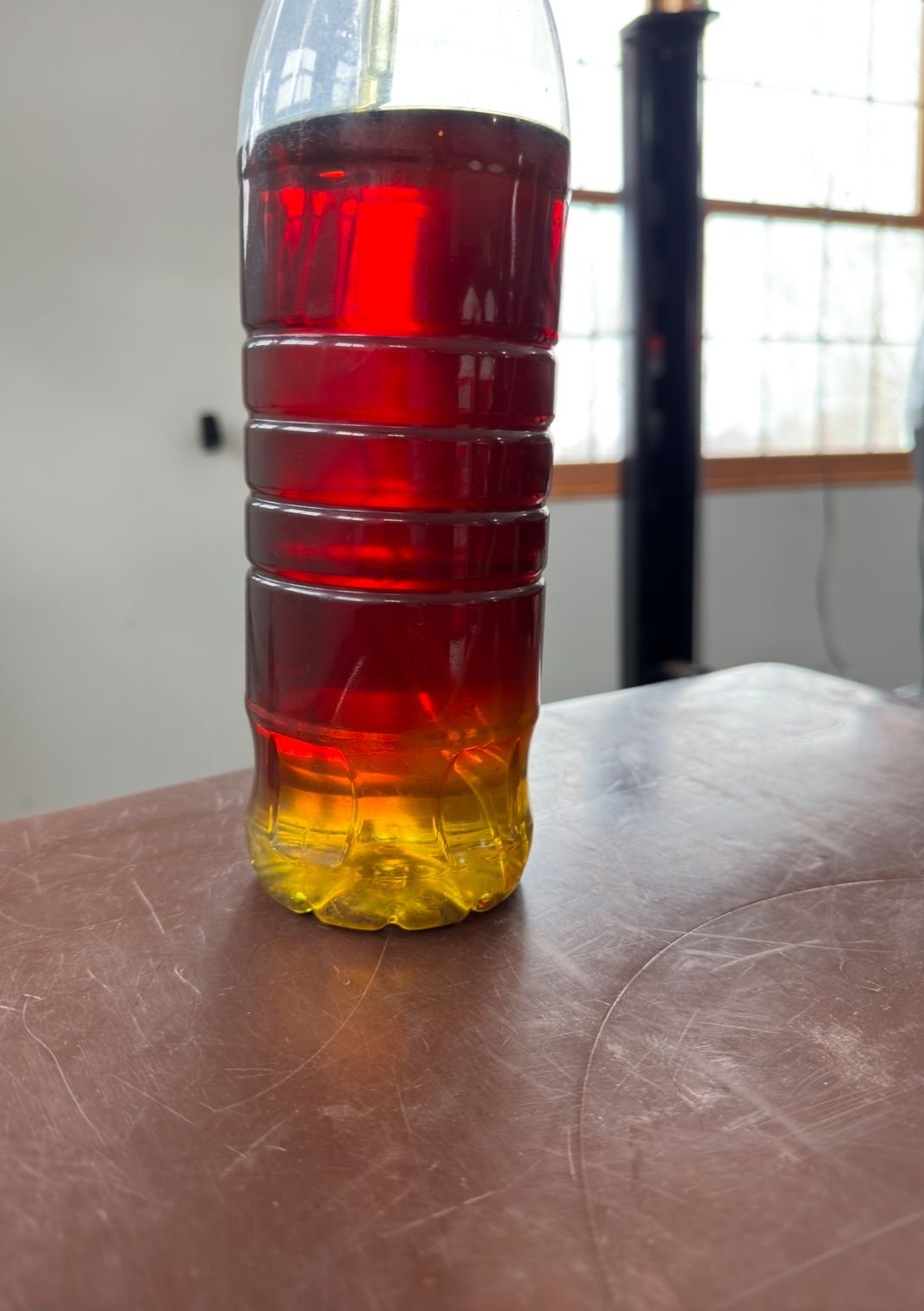

Also flushed the brake fluid, it’s very dirty, owners and garages offer leave the fluid so not completely surprised, brake should feel
alot better!!
Gave the calipers a quick clean and removed the corrosion from the R logo

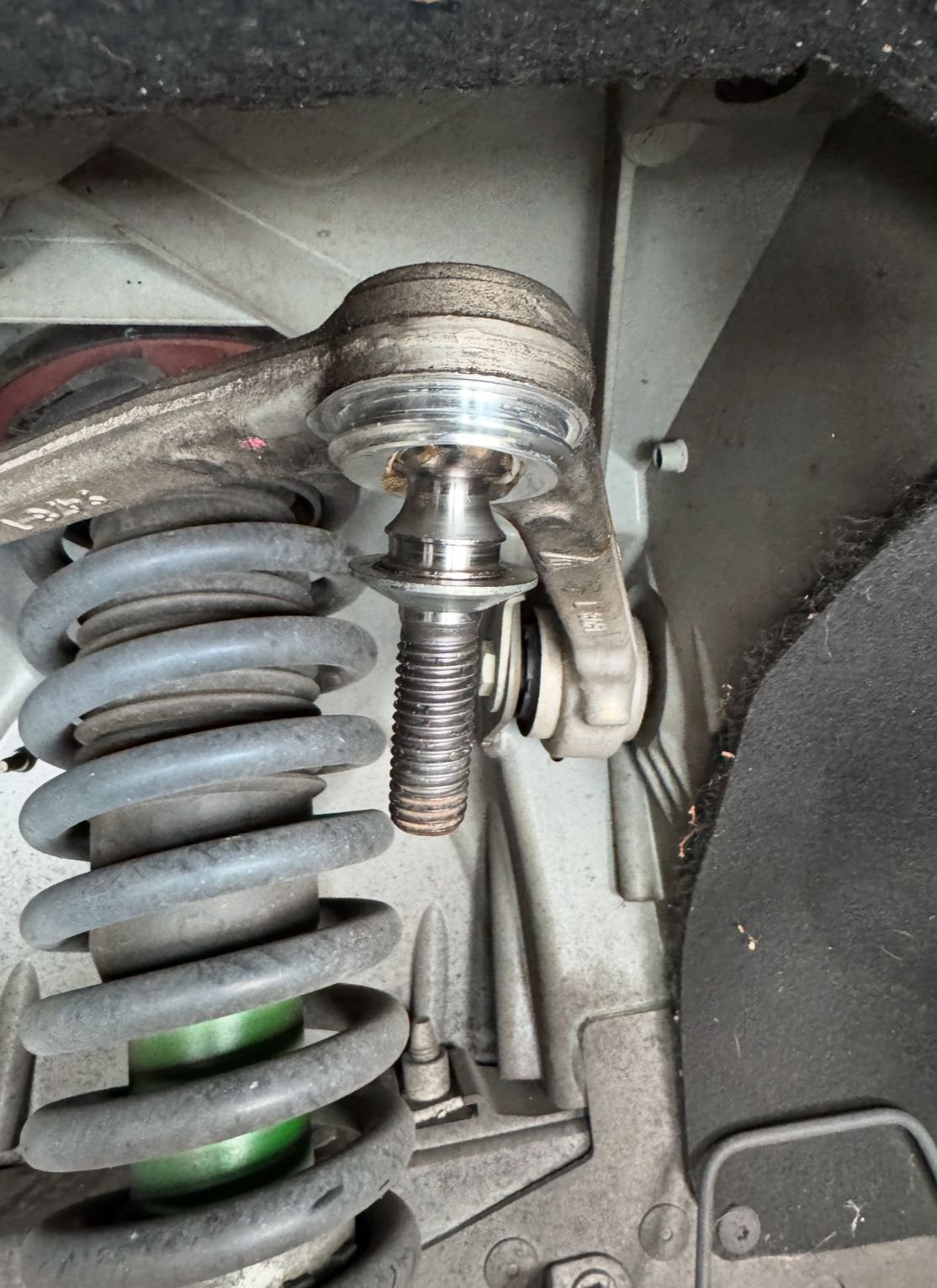

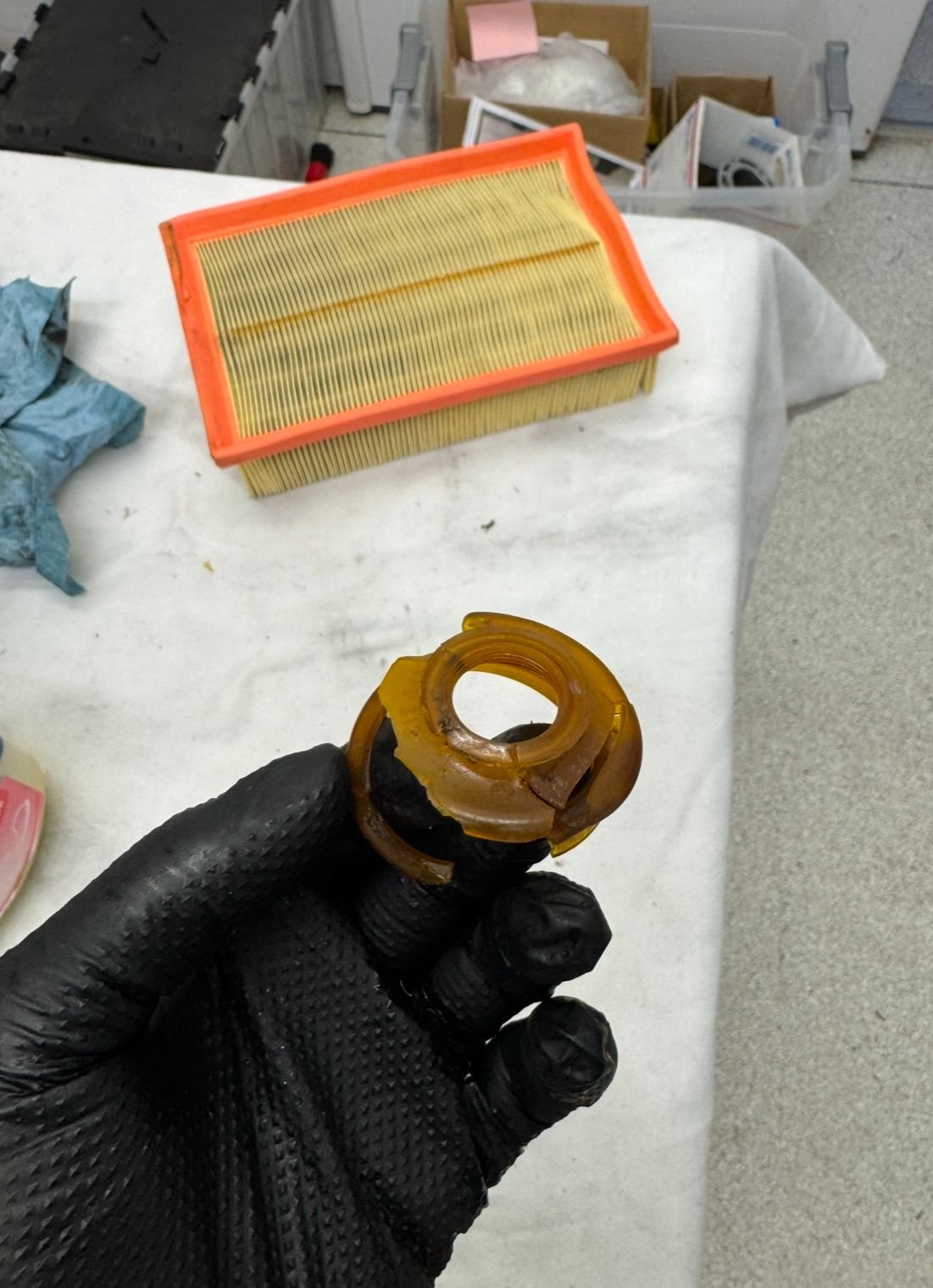

Need to replace some of the suspension boots, as expected at this age they are perished.
The ball joint itself is fine with no play, I’ll repack it with grease and replace the boot.
A little more work than expected replacing all the boots, but I have a few more months of snow to deal with.

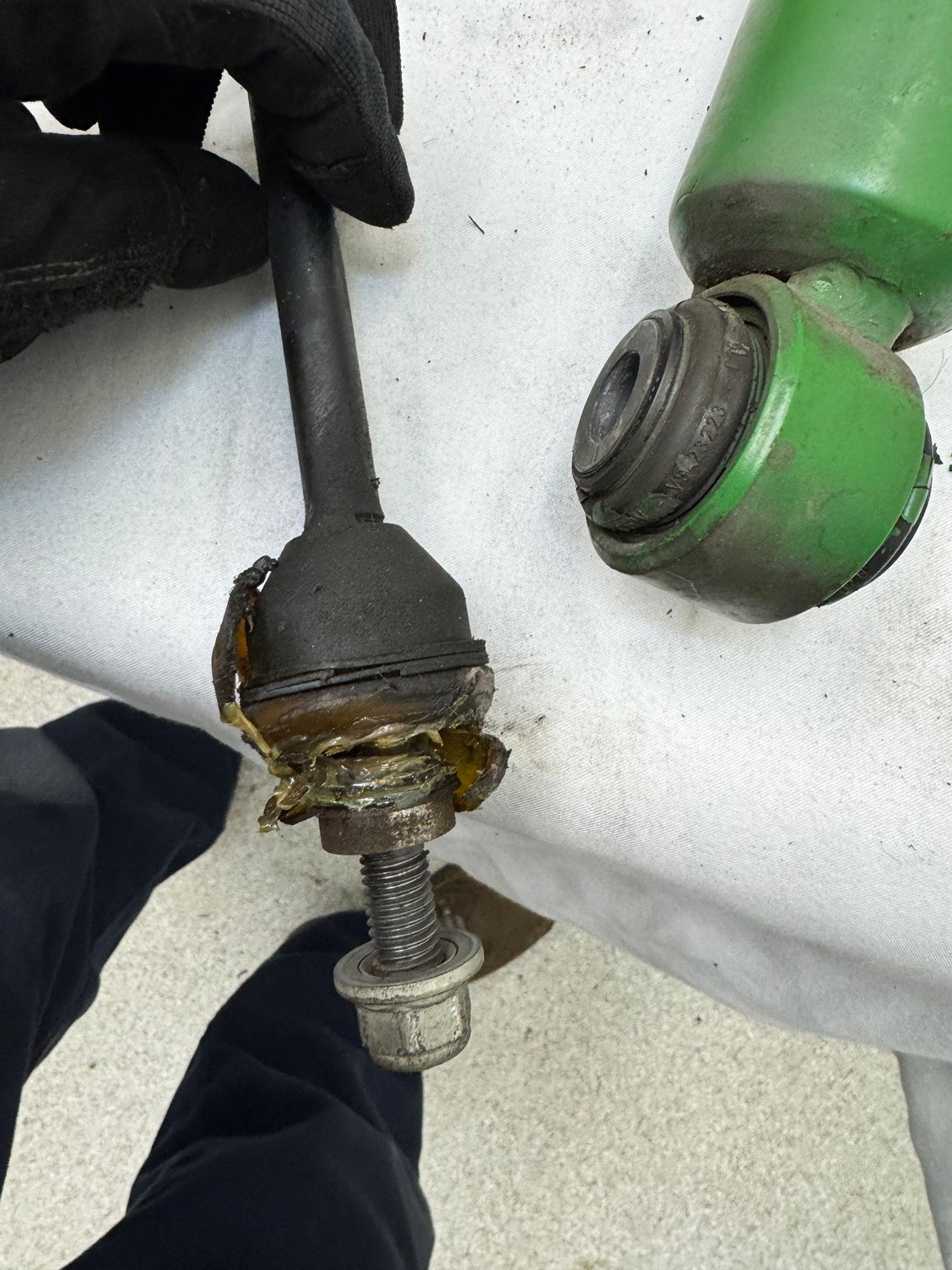

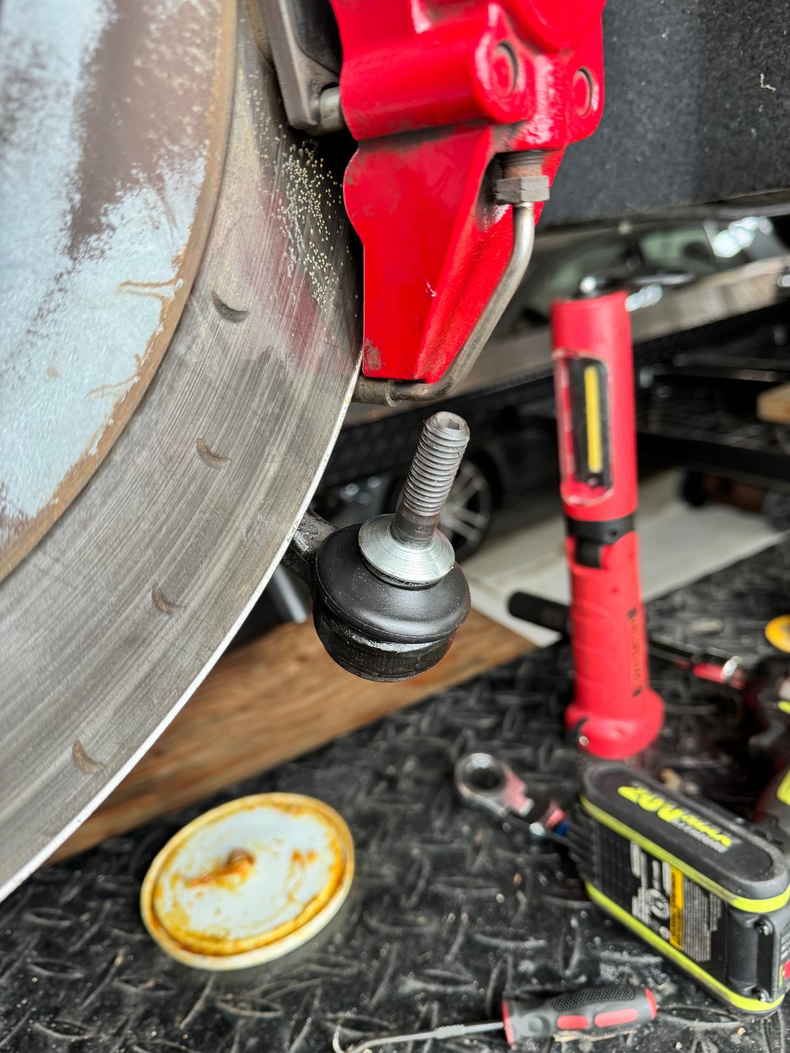

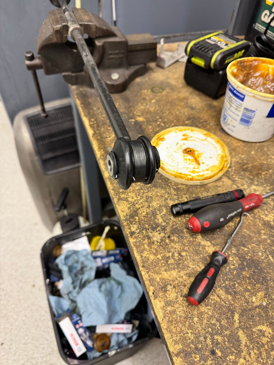

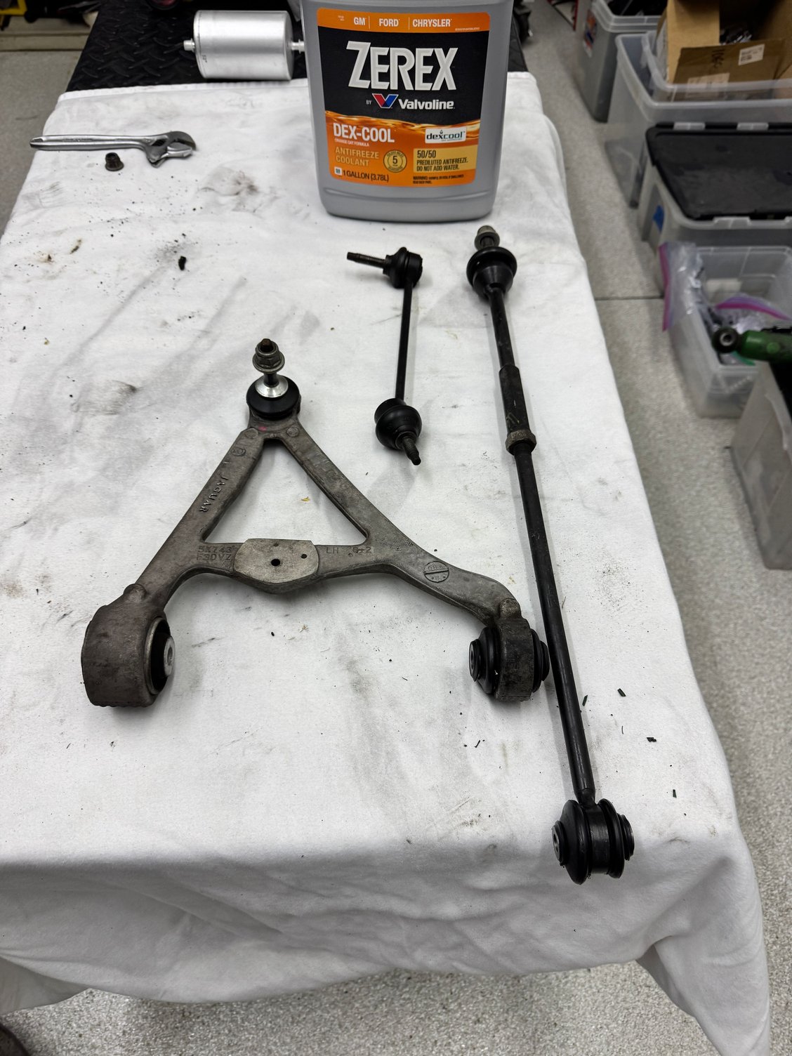

More work on the car today, as well as the upper mounts, the lower steering rod boots were split as well.
For around $8 got a bag of assorted tie boots off Amazon, cleaned re-greased and replaced. Fronts done now onto the rears
Hopefully tomorrow will be able to strip the rear suspension down and inspect the bushes as all the rear boots seem shot

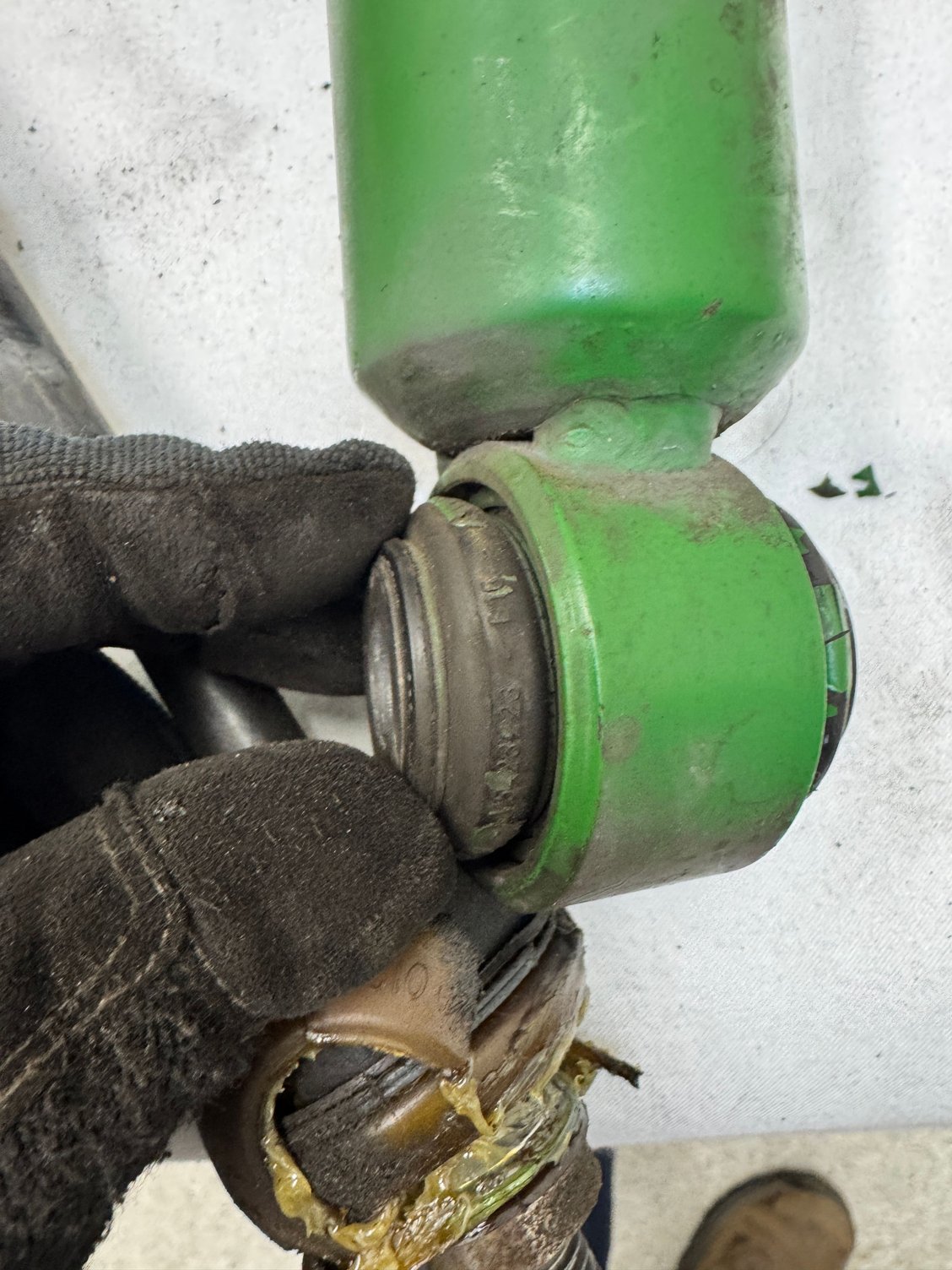

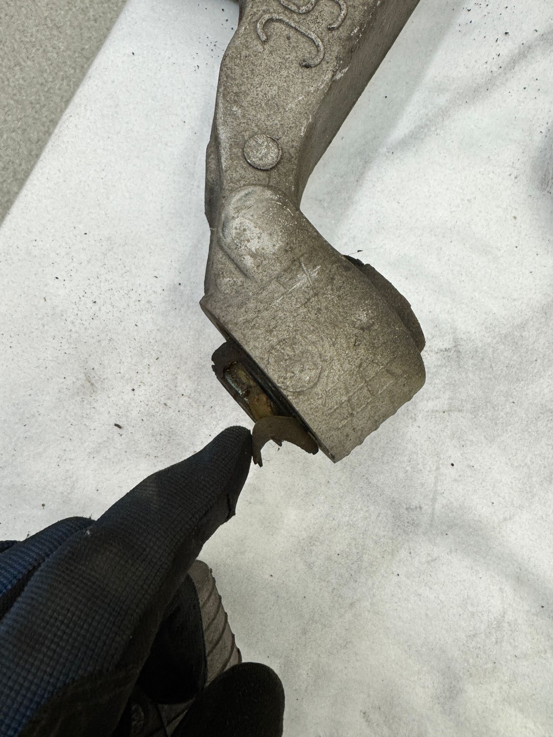

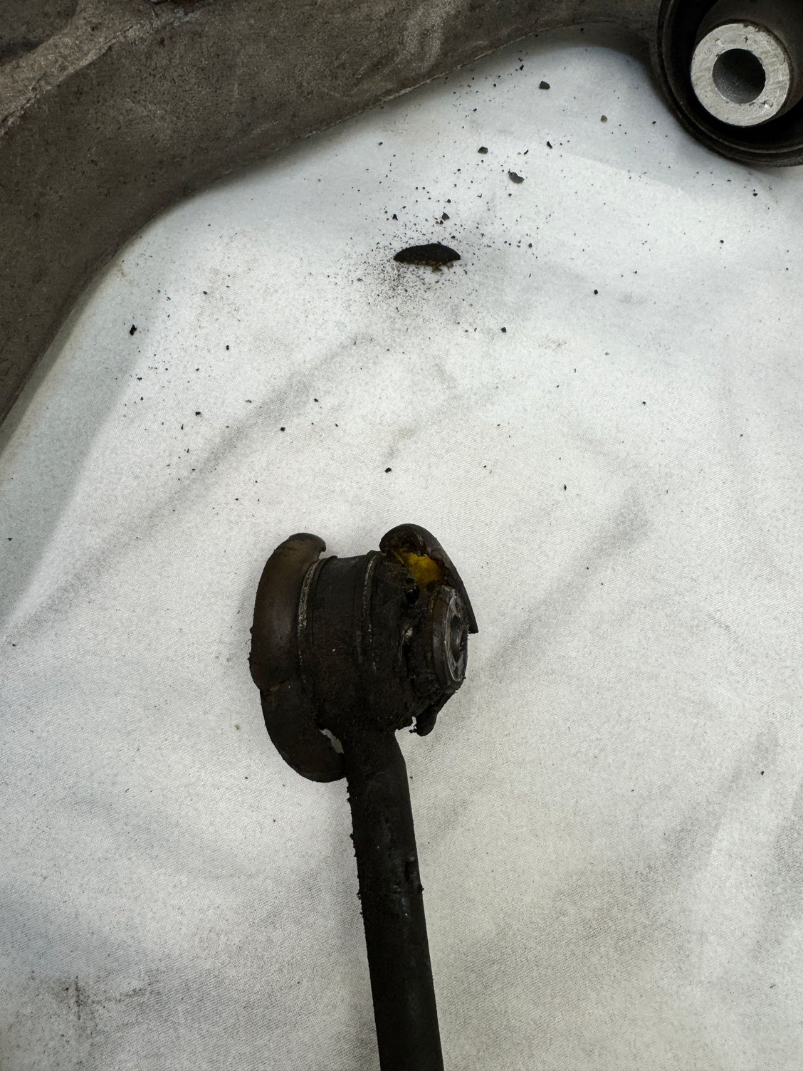

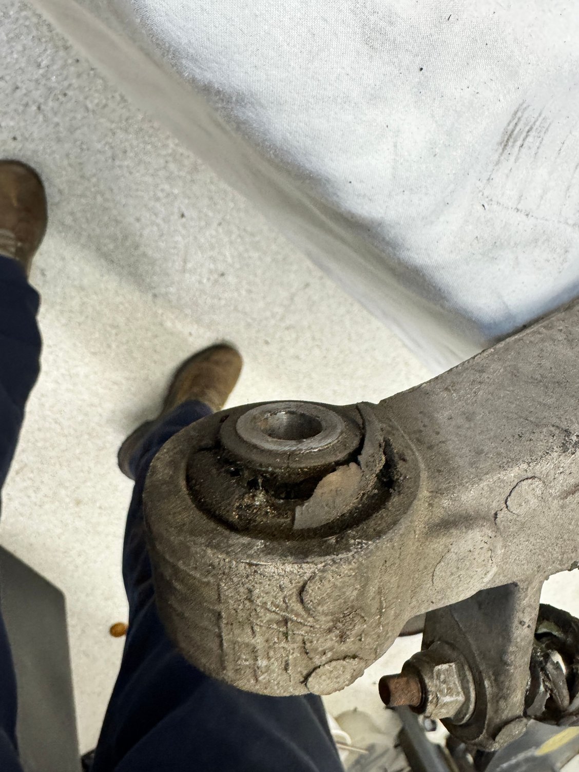

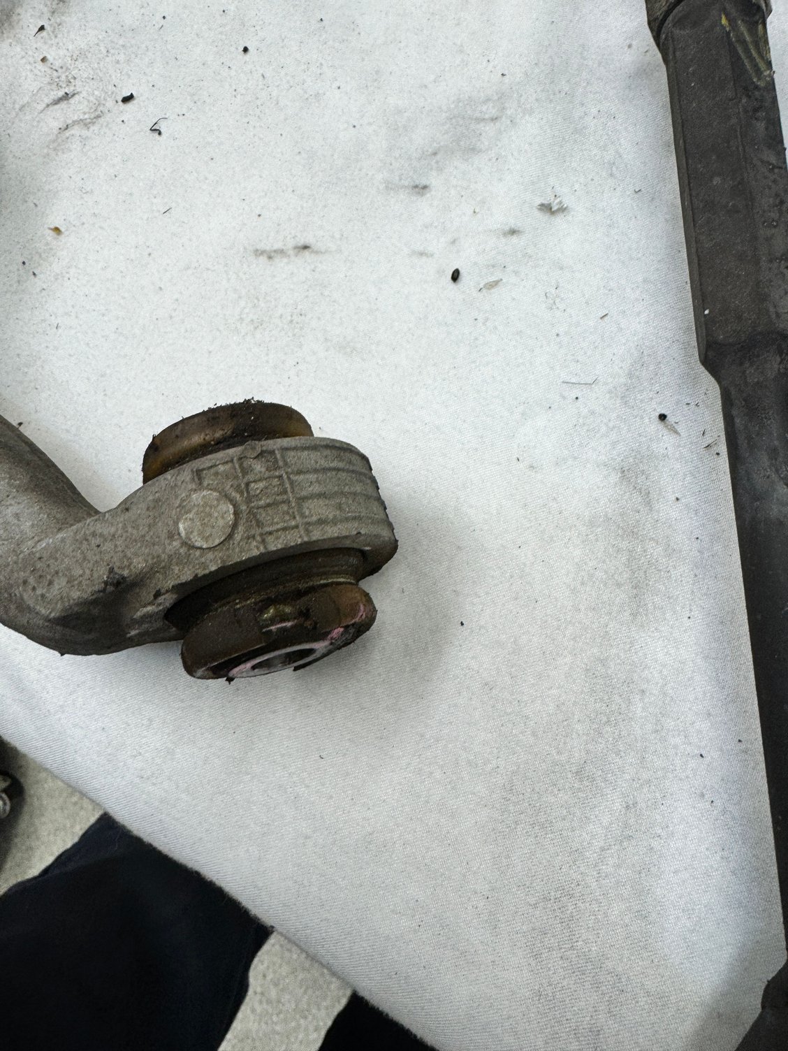

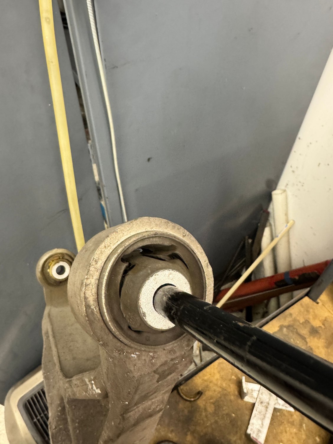

Removed the rear suspension arms from the drivers side today, every rubber boot was perished
As before the bushes are in good shape it’s just the rubber boots Jaguar sourced.
Cleaned them, regreased and new boots
Glad I took them off to inspect them all as the lower rubber bushing has split, the upper was fine
New UFO bushings part # C2C3958B $49 ordered, hopefully reasonably easy to press out and replace. Ordered a pair as I presume both side are in need of replacement.
The shock lower boots were fine, clearly a different supplier to the other parts
