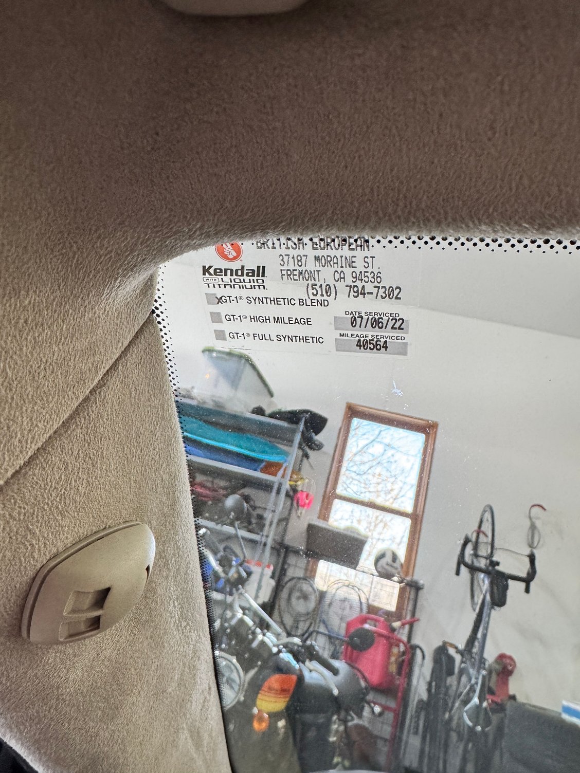

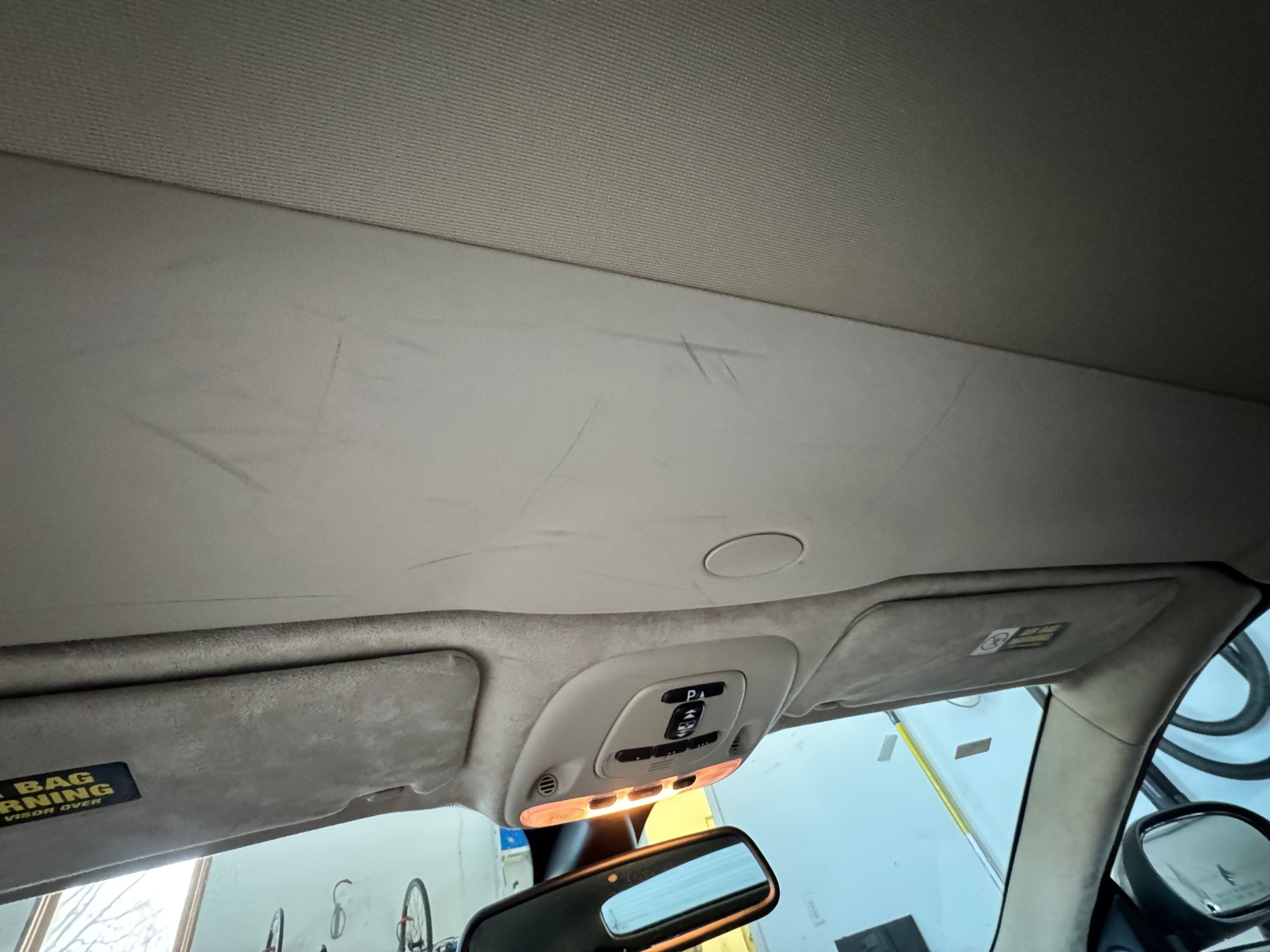

Counting down the days till I can enjoy my new car!
Decided to give the interior a clean, nothing makes a car feel your own until you’ve give a car a good clean.
A dash of brake cleaner got all the market off the roof, just take it easy.
All the window stickers removed including the service sticker, this car has hardly turned a wheel in the past few years.
