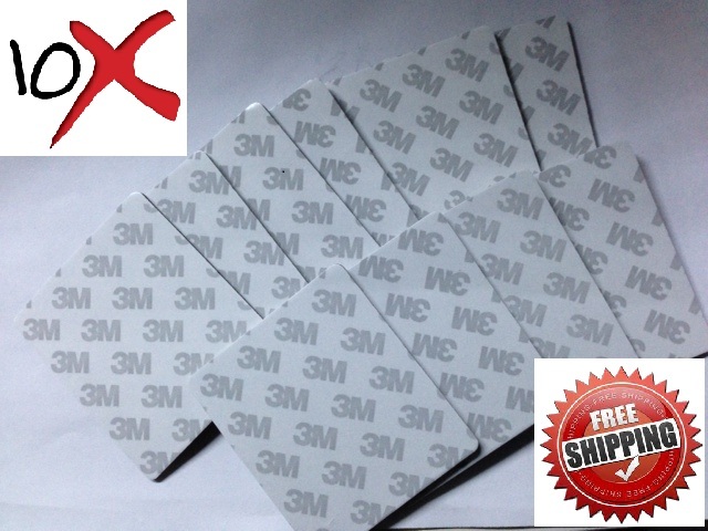

Hi Gents!
I would recommend 3M double sided adhesive sticky pads instead of drilling anything... They're extremely adhesive and heat resistant. They'll glue the slim ballast in place, and you'll have the option to remove them eventually once you're tired of it .
Below is a picture of the actual pad and link to an eBay auction should you be interested. My ...
Cheers!
3M double sided adhesive sticky pad eBay
