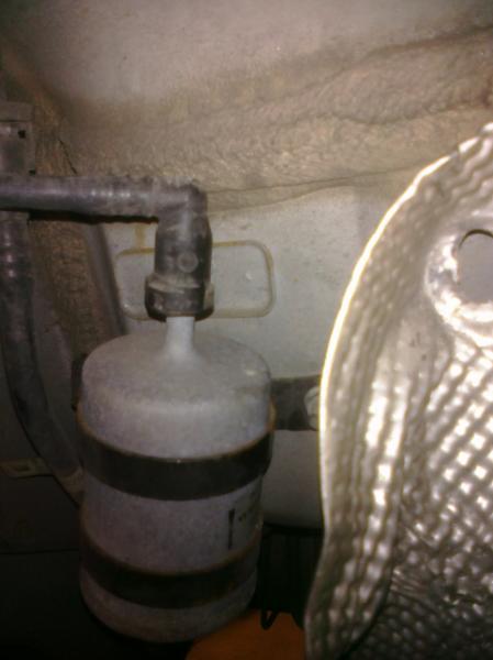

OK. Christmas is over - time to get back to work. Put Kitty on the lift and finally get to the filter. Problem is, it's not the one that was last recommended. If you look at the first photo the filter in the center is the one recommended (its box to its left. It has the bayonet fittings. The second photo is my installed filter (with the quick release connections).
Am I supposed to cut the plastic bayonet fittings off the filter I bought or is there yet "another" filter (the filter on the right is what all the auto parts stores list) that I'm supposed to find?
Also: I can barely get to the filter (heat shield & suspension), so I can't maneuver around it well. Is there a trick to releasing the quick release fittings easily?
One more thing: What Brain Surgeon put "that" heat shield in there?! (see third photo) Is there away to maneuver that thing out of the way without removing the exhaust system and differential? I really do not want to take the dremel out!
...... but I will (cringe).
Thanks Guys - Jim M
Thanks Guys - Jim M

Filter finally replaced. It was a PITA, but in the end it went just as MAXWDG said it would.
In addition to Purolator PN#F65217, my cross reference also turned up numbers FF677 / G6340 at Autozone (see my other photo). Yes: just pry off the plastic tabs and it's an exact fit. By the way, although on the side of the box it says "Luber Finer" (who the Hell are THEY?), on the bottom of the box it says "Champion Laboratories". A little research has lead me to believe this is a perfectly good filter. And to give you even more confidence: along with the word "Jaguar", the original filter also had written on it "Made in Poland". Poland has become a new source of quality auto parts! (Really?)
The filter is hidden beneath the heat/sound shield, inboard of the left tire and vertically oriented. The shield cannot be removed - it winds around and in between all the suspension/exhaust components and the sub-frame. All you can do is remove three 10mm retaining nuts and then just bend the crap out of the shield. Don't worry too much - it goes back perfectly afterward.
NOTE: Release the fuel connections before you unbolt the filter mount. Otherwise it will be very difficult to apply the force necessary to spring them free.
If you look closely at my photo of the old filter (still installed), and study the connector, you'll note a slightly lighter shade of plastic on the right side. That lighter piece is the release button. When dirty you might not see them, but if you wipe down the connectors they will be come obvious. The upper connector's button faces the passenger side of the car; the lower button faces aft. I found that it was easier to push the button if I first wriggled the connector until it twisted free of the filter pipe. Once I was able to depress the button at all, it wasn't long before the connector pulled free.
NOTE: Release the upper connector first, THEN the lower connector. I did the reverse, and the filter just kept dribbling trapped fuel on me (until it was finally empty) if you do the upper first, the filter will then empty completely after you release the lower.
I am lucky enough to have lifts available. If I had to do this on the ground it would have been a bit more difficult because of all the odd angles I had to maneuver my arms into. It would still be possible though, and although this replacement is a pain it still doesn't take too long. Even with the time it takes to figure where everything is and you're going to get to them, it shouldn't be more than a couple of hours at most.
My thanks to all who helped me here. (and MAXWDG's wife of course!)

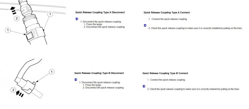

Just changed the fuel filter on my 2003! Did it on the ground (no hoist) and those tangs are very hard to see in part due to being very small and dirty and also because they were so close to my face I had trouble focusing my eyes on them.
I used a small flathead screwdriver to push in the tangs, the diagram above makes them look like buttons but mine were flush with the fittings.
Thanks for the Puralator PN to cross-reference from, I used a Fram filter (PN G7143) and finished off with a tank full of 94 octane! Old filter was a genuine Jag part (made in UK), no idea how old it was.
