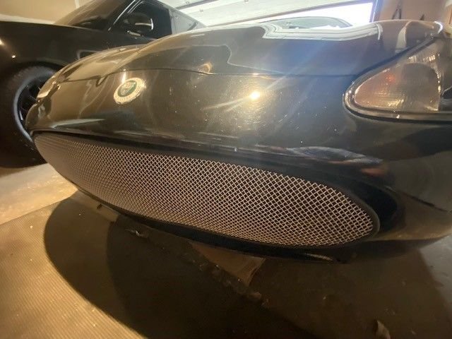

Default '06 XK8 front grill

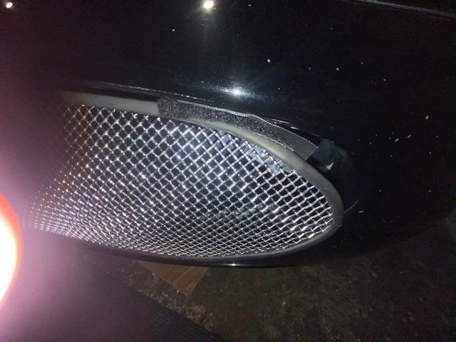

The previous owner replaced the original front grill with an XKR grill, the grill is velcroid to the bumper at the top on both sides, which seems odd to me. the velcro is slipping and now the front right side is jutting out some, would really like to fix "correctly" but not sure how to tackle. some pics below so you can see what i am talking about. any advice would be greatly appreciated. thanks

To judge from the rubber edge this is the type that fits "over " the hole from the front rather than from the inside .
I favour 4 black cable ties to replace the velcro

hmmm not sure how id do that w/o it looking obvious. push comes to shove i will just see if i can replace the velcro, given its held for quite some time prior to me picking up the vehicle.

This Grill doesn't seem to be damaged.....It's just installed incorrectly! It should be mounted to the inside not outside the opening.....I don't know where it came from but you need to contact the seller and determine how it was supposed to be mounted and what you need to install it correctly.....or "Rigg-it up" with something.....! Call that Guy in California that sells that stuff! Sorry! I can't remember his Company's name.....might be easier to just buy a new one with all the parts and toss what they've messed-up.................I think they are less than $250.00!
I'll have to admit, I kind'-a like it on the outside! But not enough....They've had to fill-in the ends with something in order to fill the hole that was left.......

Thanks for the input, ironically I was just looking on Mina Gallery’s website and I can get a mesh grill and parts for $130. I think that’s the route I’ll take and just install a new correctly. Based on what I’ve read should be a simple install w/o having to remove the front bumper.

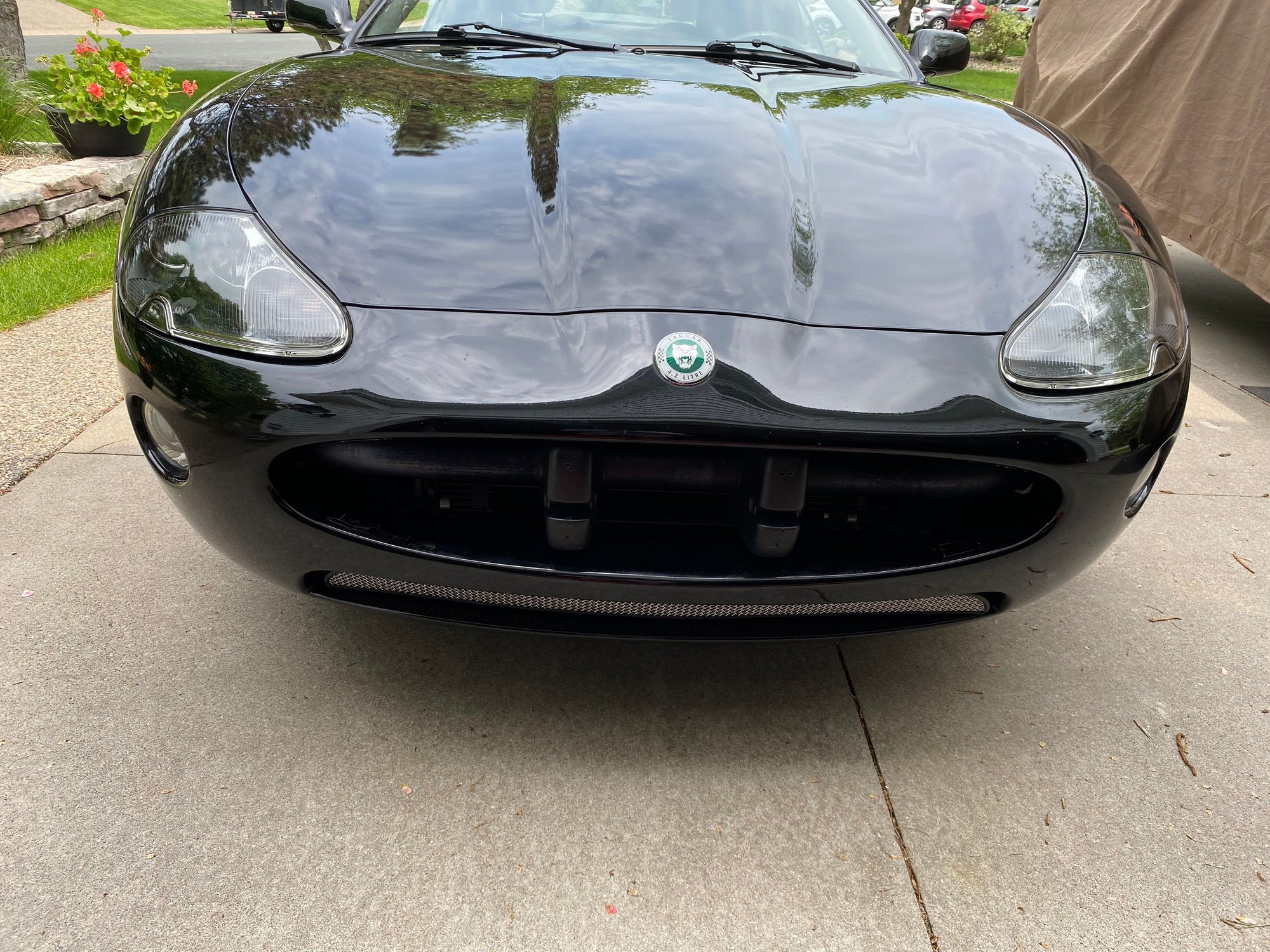

Befor and after pics; the instructions and wood screws that came with the Grill from Mina were somewhat worthless., after breaking two of the screws i finally went to the hardware store and picked up some self tapping screws. What’s I didn’t realize on the bumperette, they were a combo of both plastic and metal≥. Regardless happy with how it turned out, no more velcro and should be a heck of a lot more permanent .

Very Nice clean looking installation! Sure beats the hell out of Velcro. And yes, I do like the look when installed from the inside(not that realy matters). I HATE GNOMES!!! I had a plasic seemingly squashed one attatched to the grill of my pickup truck. Just sold the truck but kept the gnome. Molly my xk8 has no grill, something to think about. Thanks for the update, nice job..

NOW!!--- That looks more like it! Also, you have added the Lover Cover. The Lower Cover is an addition that was offered by some of the Company's such as Mina Galleries......The original XKR's didn't come with this feature. I have used the two outer opens for Daytime Driving Lights!

I installed mine by making angle brackets painted black. The lower grill is very important to prevent stone damage to the condenser.

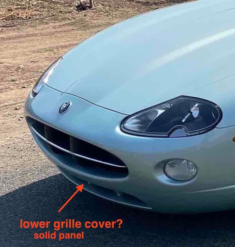

Looks great. Is the DTRL insert a panel? It looks solid in the photo. Who sells them? I like the side skirts on my 06 but mixed feelings about the restyled front end.

Just checked on that lower cover. Mina only shows mesh inserts.

The upper and Lower Grill pieces come separately from Mina....If your Jag has the convex upper Grill and someone has put in one of the bottom Grills, it can be removed and the Lights will fit into the lower outer grill Opening! My 2005 did not have a lower grill as it was not offered by Jaguar.
Go to either Osram or Philps Websites and you will see what they offer as DTRL's! The cost about $80.00 now....Philips offered a set last year like mine, which are all in one, whereas now they appear to have 6 to 8 Bulbs inside them....I Ilike the single bulb idea, personally! They fit into the outer Opening of the Lower Grill! ....

The 2004 - 2006 XKR's all came with Convex Mesh Grills but NO Lower Mesh Grill....You have to order the Lower Mesh Grill from someone like Mina Gallery's....I've never seen one here in Houston....The Front Nose Piece comes with the Convex Mesh Grill in the Top Opening but the Bottom Opening is divided into 4 individual Openings....If you wanted a Mesh Grill Cover for that Area, you could order one from Mina Gallery's and possibly some other Company like them!
My DTRL are made by Philips and they fit just fine in the Lower Outside Openings and are mounted to the Nose Piece itself with Screws......Wiring directions come with the Lights. They come on when you put the Key into the Ignition and Go off when removed! They Dim automatically when you turn on the Headlight's...
