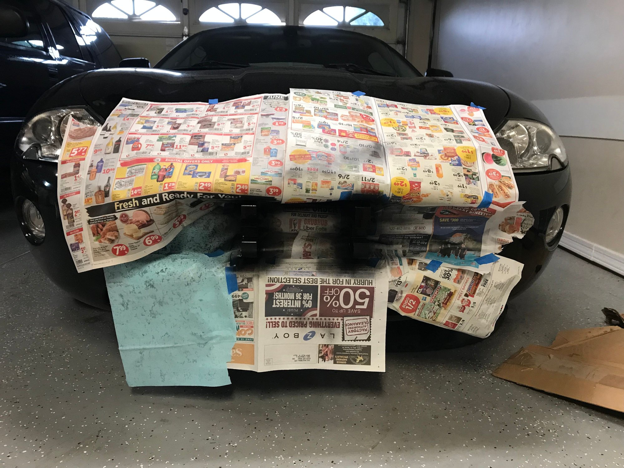

I figured-out how to get those plastic covers on the over riders off; I removed the bottom pan which provided just enough additional flexibility of the bumper cover to allow getting those covers off.
Step 2: paint the aluminum blocks.
Two coats of black.

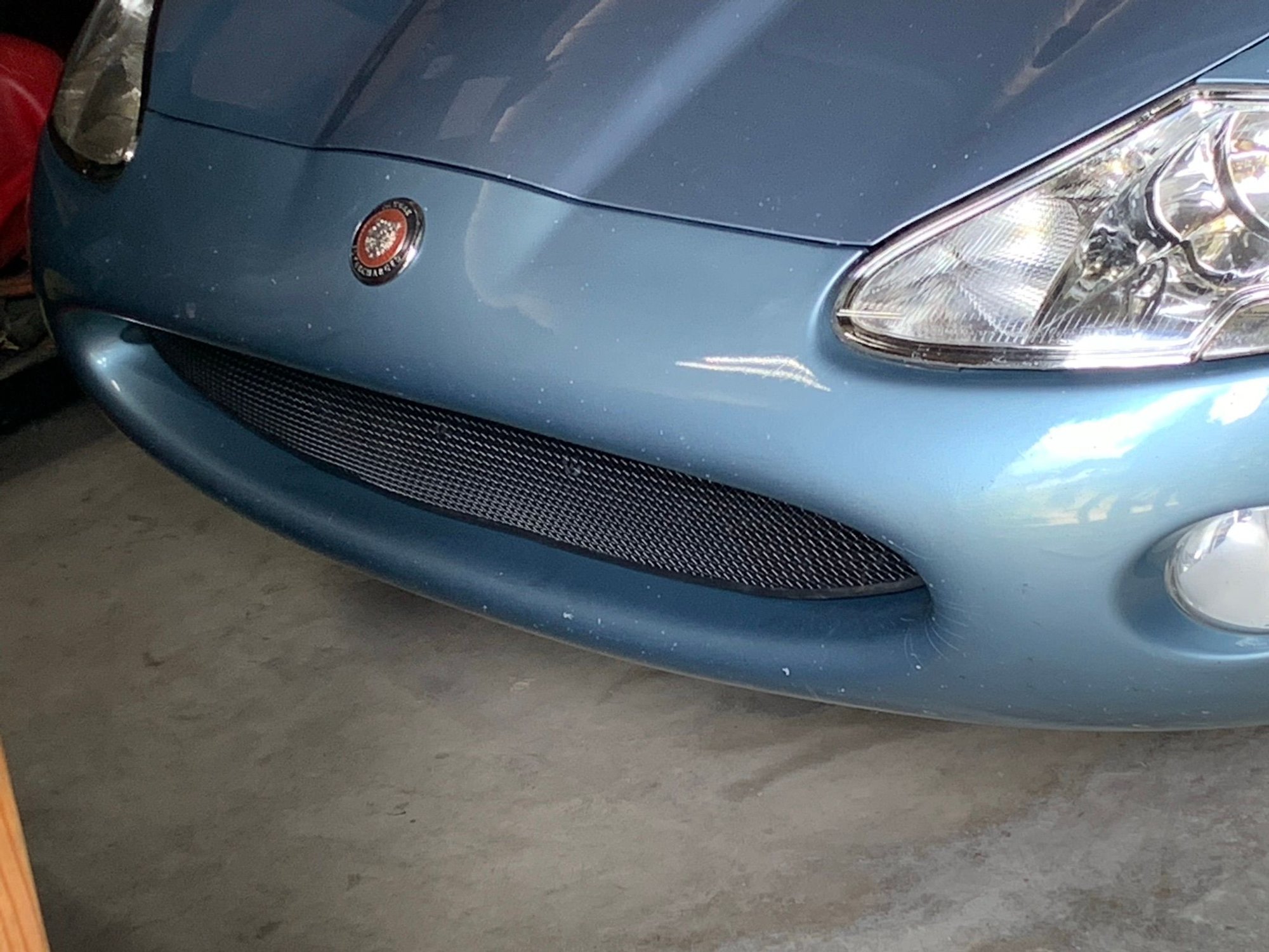

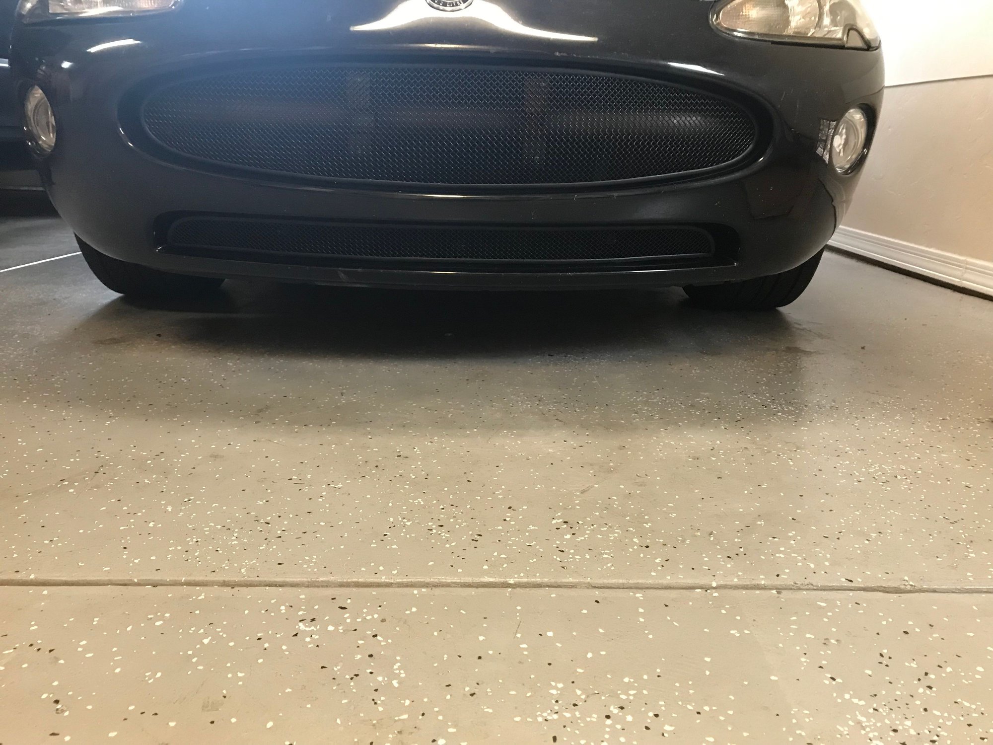

Finished getting the mesh grills installed; not too bad, not perfect by any means, but looks pretty good.
Mesh Grills Installed

Lannyl81,
It looks OK! Being Black as it is...No One will notice! It appears to be a little small for the area..... At least the Black Paint hid the Cross-Bar....
My XKR had a new Right Headlight, Grill and the Nose Piece re-placed during the last (2) Weeks due to someone hitting it in a Parking-Lot....Looks the same, your Grill is just Black...I can't tell if you used the Lower Grill or not but it looks a lot newer!
Good Luck!
Billy Clyde @ Cinco Ranch

The upper grill is a little small for the area; that is why I have the ends pushed in. The lower grill is there and is a perfect size/fit.
I had replaced the right headlight lens a few months due to the lens getting cracked (not by me). A few years ago, wife had a FedEx truck back into her and took out the right headlight. Must be "something" about those right headlights....

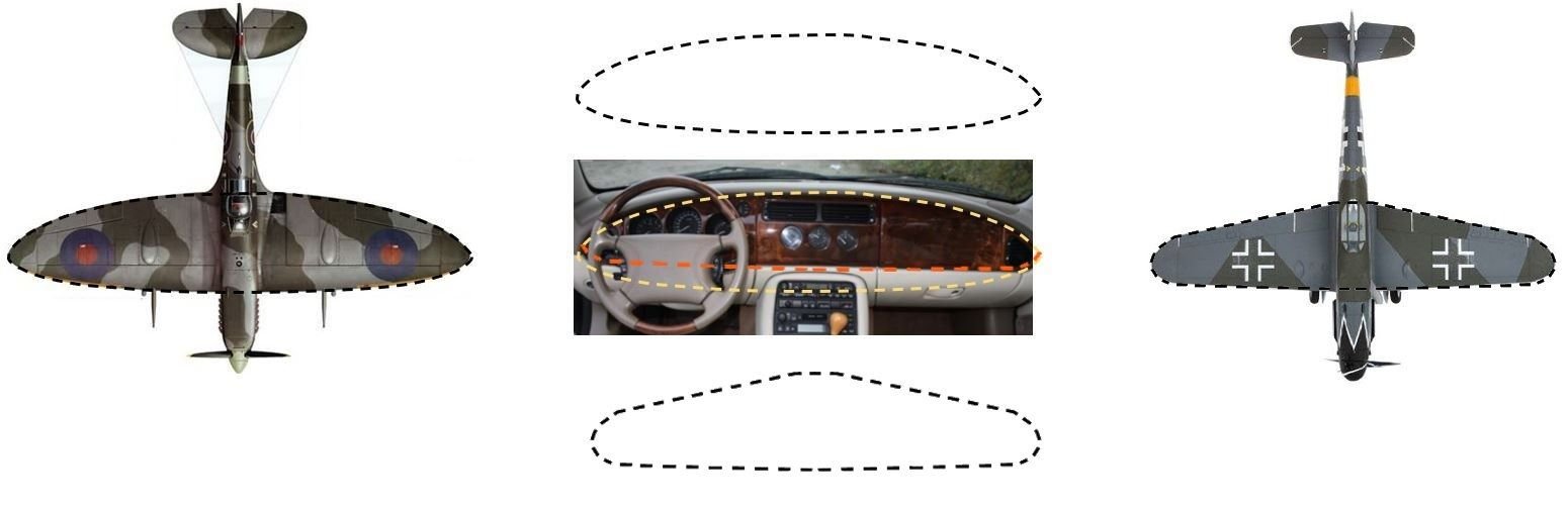

I only recently learnt about the XK's dashboard being shaped after (or having its shape named after) the Spitfire wing. Of course the lower portion had to deviate from the wing's outline due to packaging and ergonomic reasons (glove box, for one). Which suborns me to use my first post on this forum for some mischief and spread a little conspiracy theory:
I will show myself out now...

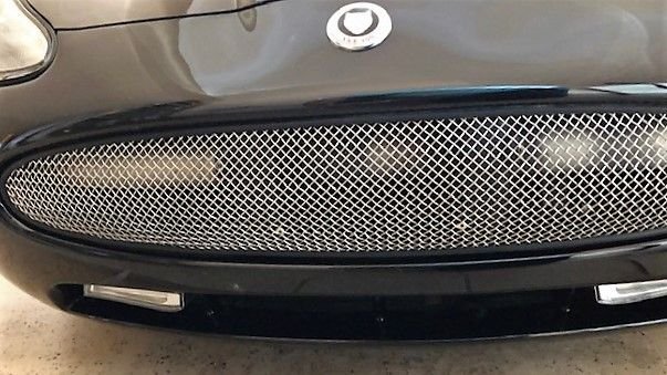

Thanks for the input, ironically I was just looking on Mina Gallery’s website and I can get a mesh grill and parts for $130. I think that’s the route I’ll take and just install a new correctly. Based on what I’ve read should be a simple install w/o having to remove the front bumper.
bcprice is correct, the Mina grill goes on the inside . Someone tried installing it haphazardly.
when installing my Mina grill I did need to remove the bumper covering and grind off the rivets holding on the metal under the “buck teeth” plastic covering. I don’t recall if removing the buck teeth was mandatory, but I wanted more air flow, so out they went.
what holds it in place are 3 or 4 nearly invisible black headed metal screws that attach into the 1/8”
holes that you drill into the metal bumper. Mina supplied those as well as some rubber sleeves which serve to space out the grill to the right depth. The black heads of the screws makes them blend in with the grill and they are unnoticeable unless you are really looking closely.
all in all, a fine product.
Z
PS: the hardware kit Mina supplies is different for the XK8 vs XKR, and likely different for the 4.2 L years too.
