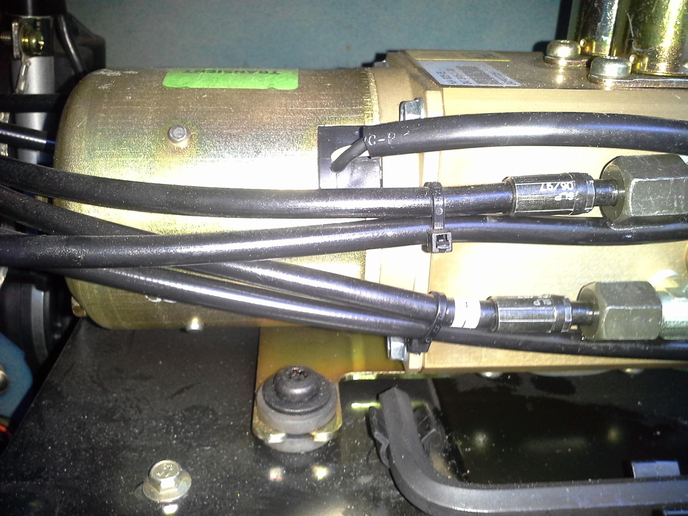

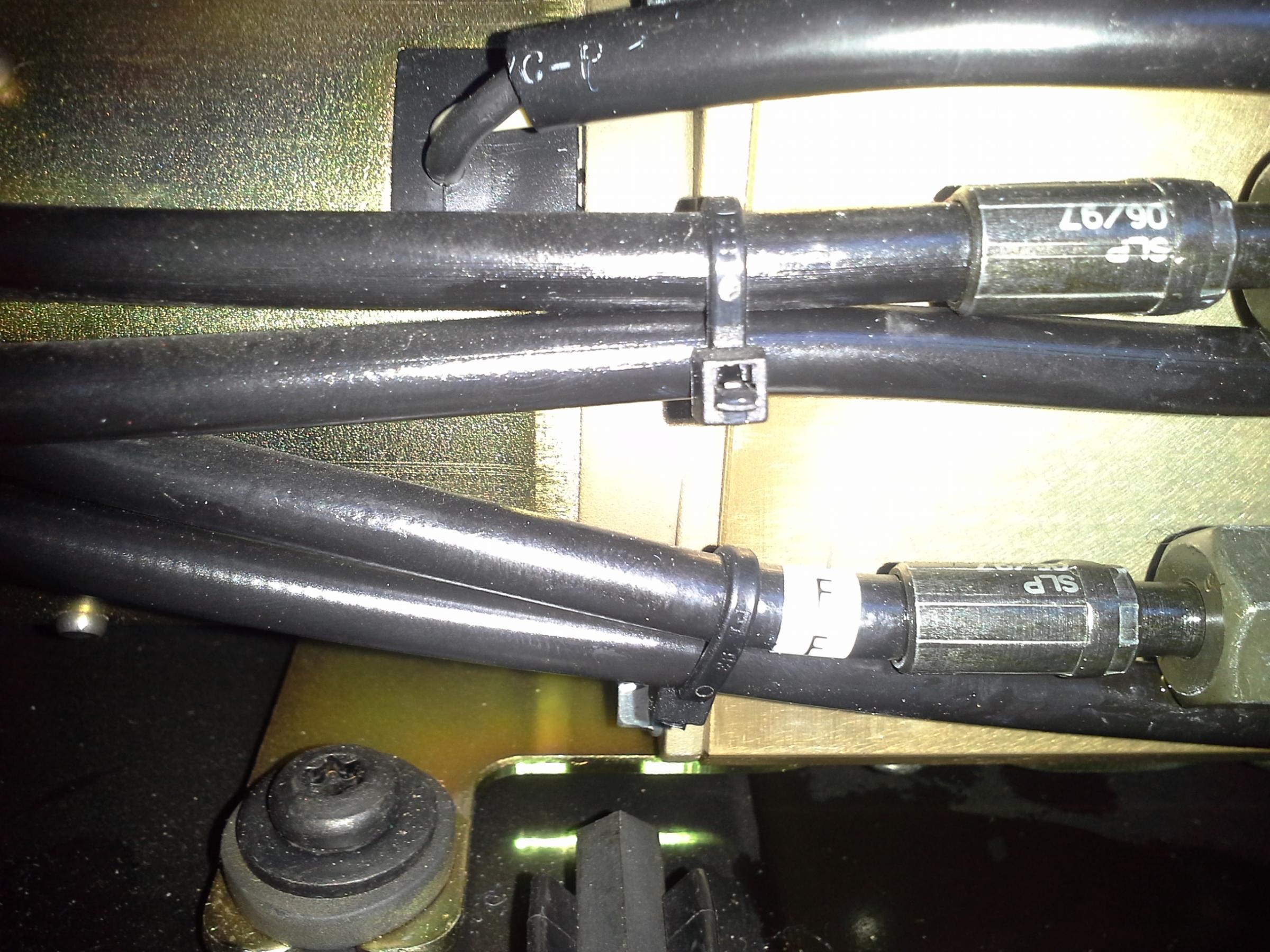

Originally Posted by oyster
Hi.
I have the "old" hoses in my -97, VIN 011XXX. No, knock wood, burst so far.
I have a 98 and had expected to install the hydraulic pressure relief valve, but reading this I was surprised that the '98 did not all have bad hoses. My build date is August 97 so I expect I am safe (knock on wood)....however my hoses seem to have no markings whatsoever...(pics attached)...can anyone tell for sure from the fittings (which have a 06/97 marking on them).
Merry Christmas to me! Thank you forum for this Christmas gift!
Second question: Has anyone with 97 or 98 XK had a problem with the latch seals? Wondering if it may still be worthwhile installing the PRV.
Attached Thumbnails 1999 XK8 Hydraulic Hoses-20131225_122637.jpg   1999 XK8 Hydraulic Hoses-20131225_122651.jpg

One question I had in the original post was whether I was reading the date code on the hoses correctly, they are 3-Q-07 and 3-Q-08 and after a bit more reading I've found these are 3rd quarter of 2007 and 3rd quarter of 2008 so they must have been replaced by the prior owner.
Unfortunately they are still the Polyflex 363 so they are just as susceptible to failure as the originals, later hoses appear to be the Polyflex 2000 series and the better replacement seems to be Coliflower kit.
