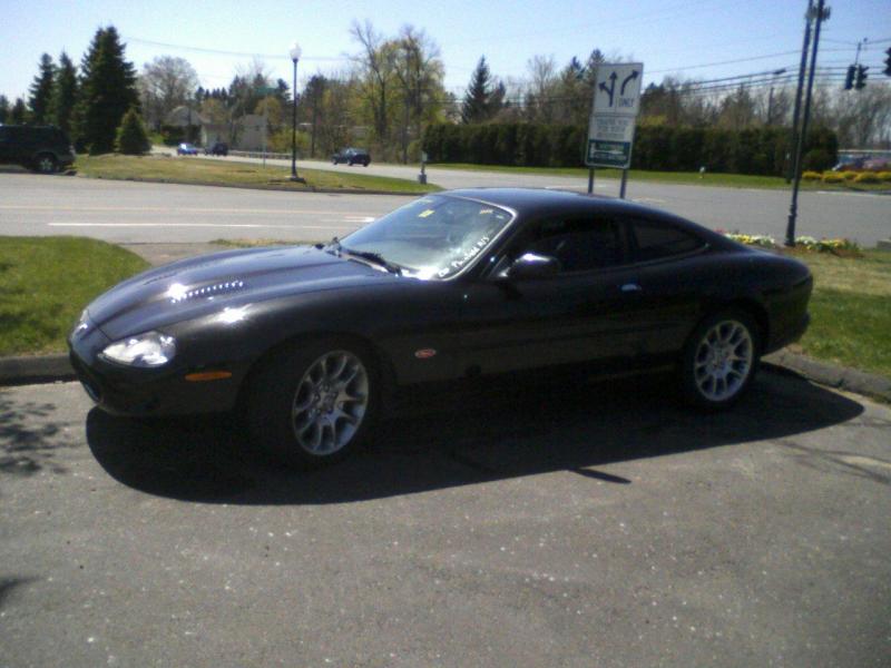

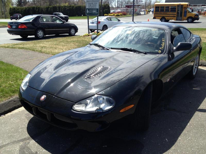

My brother owns a small dealership and I was with him at the dealer only auction today and I saw this beauty coming through. This price was low and I had to take a chance. I would love to get some input as to what you guys think this car is worth.
-2000 Jaguar XKR Coupe V8 Supercharged
-Black on Black
-122k miles
-Rebuilt Vermont Title (collision with a culvert, some kind of drain pipe)
-Runs and Drives great
-Shifts very smooth
-No major dings or anything I could find to exterior
-Headliner has been removed and is in the trunk
-Sunvisors are missing
-Suspension Fault appears
-No check engine lights
-AC/Heat work great
-Rims/tires in great shape
All I have been able to take are these two terrible phone images. With a good detail she will be glistening.
Thank you guys for any thoughts/input at all. Jaguars are somewhat foreign to me but after driving this one around, I'm an instant fan.

Give or take, about $10k to $13.5K, depends on the conditions of the car.

Oh how I wish that was true. I'm selling my 2000 XKR black coupe 110000 miles, clear title and no problems for $12,500.00 and will take less. I'd say around $5k, then a couple a grand to fix what you already know about and a couple more for what you don't know. Then when it's all done might be worth $8 or $9k. I wouldn't even touch the ebay car.

I think Jeff in Tucson said he paid $8600 for his 2000 XKR 'vert with 122k miles and no issues. This one has some known problems and a rebuilt title, so should be much less.
Hopefully you bought it right (under $5k) and the prior repairs were done right. If you intend to keep it, expect to spend several thousand more.
But once it's sorted out, you'll really love the car. When in good order, they become very reliable and are always a blast to drive.

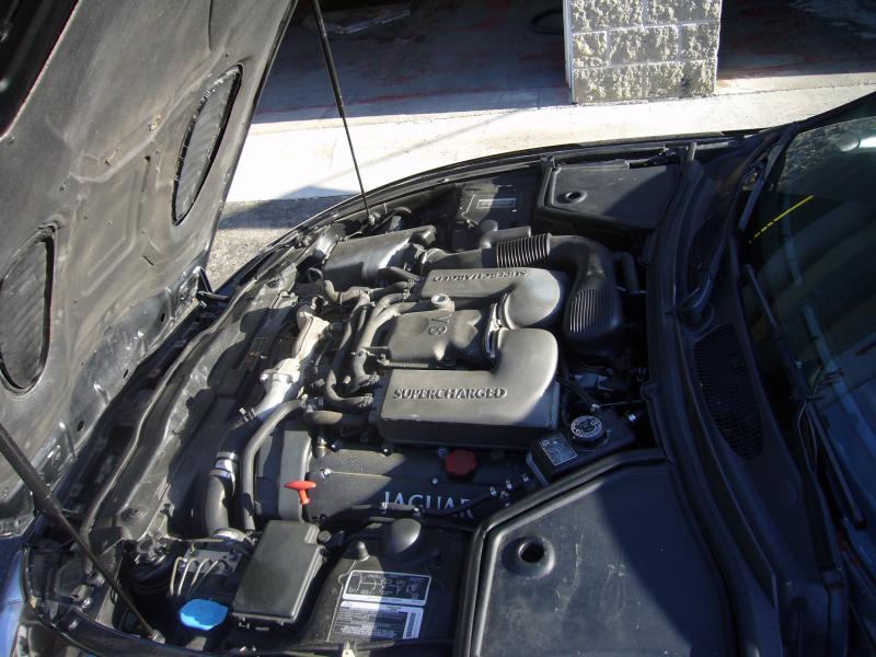

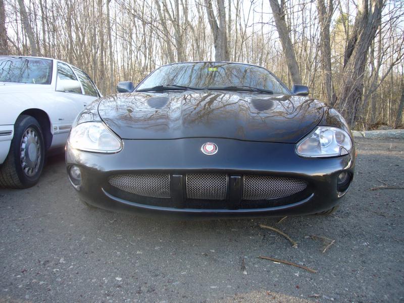

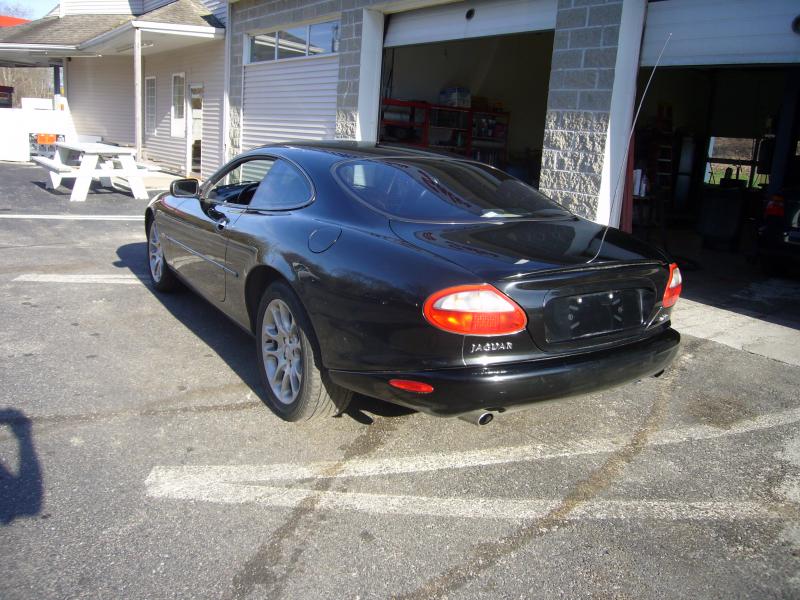

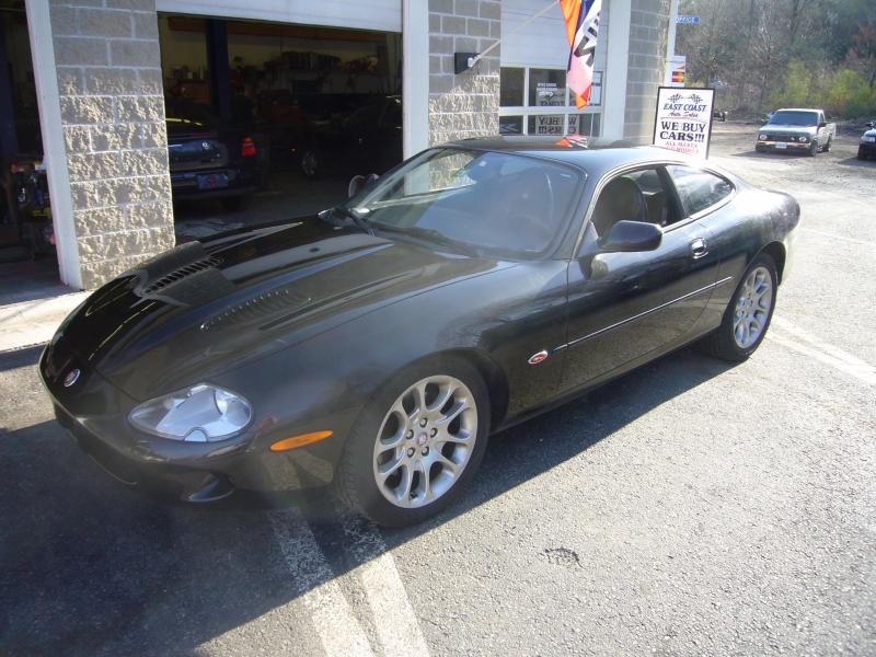

Got a chance to go down to the shop and check out the Jag again. Hooked up a scan tool and all the monitors are set and still no CEL's. There was a pending P1111 that I just looked up and found out that its just a Jaguar thing and that means that the readiness monitors are all properly set. So thats good, I will take it through emissions tomorrow.
I did notice now the Trac Not Working and ASC Not Working faults are appearing. I did some some searching around and the first thing I'm going to check is the battery. It was nearly dead when I saw the car at the auction but it came through and has started up for me fine ever since, but, perhaps its weak and dying. Other than that I saw a lot of info on the ABS module and how to resolder some pins, etc. which has corrected a lot of peoples similar issues.
I got to take it on the highway and give a few pulls and she hauls real good.
I still dont know what Im doing with her yet though! She is gorgeous but the original reason why I bought her was to sell her. I have a young family and making money is something I need to do rather than enjoy a beautiful car. lol!
I snapped a few more pictures while I was there with a better camera. Haven't had a chance to wash/wax her yet.

This is the coupe version of my XKR that I just bought! While mine doesn't have a rebuilt title, I did recently discover that the whole car had been repainted at some point, and not all that great, though the Carfax was clean FWIW. It has no serious body or mechanical issues, though the wheels are pretty chewed up and I plan to repair or replace them at my next tire interval. Interior is in good nick except for a worn driver's seat with a single small gash. But let's say they're about the same. Whatever the value difference is between the coupe and the convertible, consider the fact that I paid $8k for mine last Christmas. For this coupe, if it were me, no more than $7k due to the title. Disconnect the suspension module (CATS box, at the back of the spare wheel well), install the headliner, put in a new battery, pick up some sun visors off eBay or a parting out here, wash and wax it (though if you lay hands on it that much, you will fall in love and keep it), get all the fluids changed, and you may have a good solid car to enjoy as a daily driver so long as nothing else creeps up. No CELs and a good test drive go a long way to build confidence. But I wouldn't expect to make more than a grand if you try and flip it due to the title alone, even though you could present it better. And that would include any parts and labor you put into it to get it there. Though it would be fun to say you owned it... consider keeping it for a year.
And if you do keep it and it seems to be a solid car, reward it with H&R 20mm spacers all around, STAT! They do wonders for the look and balance of this car.
