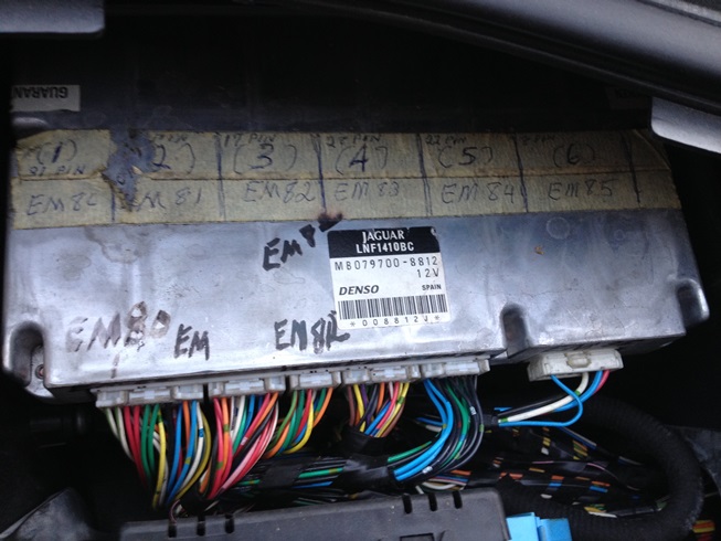

I started out with Tim's recommendation to reseat the connectors on the ECM. Based on the looks of that unit and a couple of missing bolts on the cover, it seemed apparent someone has already had their nose in there:

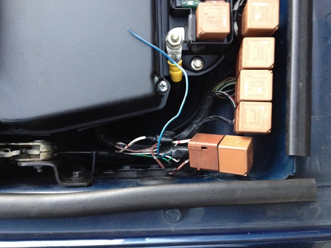

Then I moved on to the relays in that compartment. The first one I looked at had a spliced wire, although the spliced wire was cut:

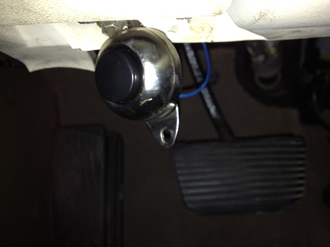

So ok, maybe someone hooked up a kill switch or something. Sure enough there was a momentary switch under the dash with the same wire attached to it:
So I removed the blue wires and taped up the splices. I would be interested if someone knew what that switch could have been used for,

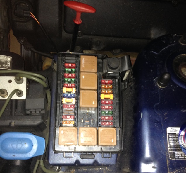

I finished cleaning and resetting the remainder of the relays in that area. Thinking that maybe I found the culprit, I started it and decided to go for a ride. As I was buttoning up, I went to put the cover on the under hood fusebox, and when it snapped into place, the car immediately shut down and went into failsafe mode:
Aha! I found a culprit. I did not take it completely apart to check it out, but only cleaned and reseated the main lug and relays.

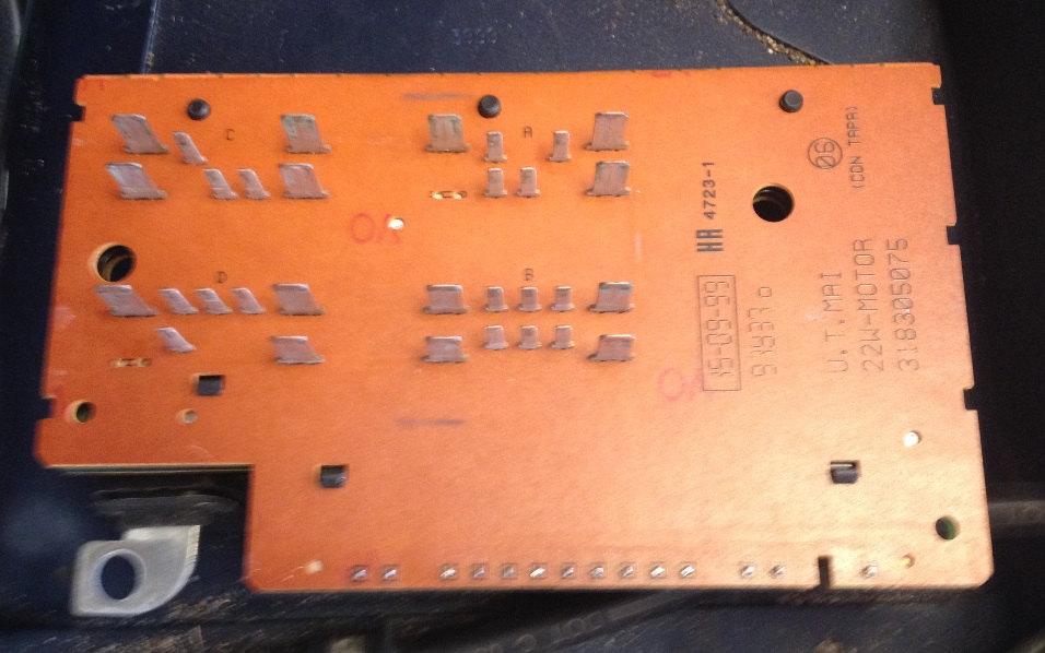

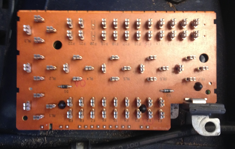

So I was still having some intermittent issues so I pulled the fuse box apart to see if I could find any loose connections:
I didn't see any loose connections, nor did I see how I might access the main lug connection. So I cleaned everything and put it back together and reinstalled it. The car has only gone into failsafe a couple of times since I put it back together. When it does, if I open the bonnet and tap the top of the fusebox, I hear a double click and it will be fine again. (My wife loves this procedure at the grocery store).
So I have 2 questions:
1. Has anyone have ever had a relay stick periodically, or does anyone think this could be the issue?
2. It appears that there is a relay missing (see first photo). Can someone tell me what is missing, or if it is missing?

Just to answer your question #1, yes relays can stick. They are all the same, swap two at a time and see if the problem moves.

A relay can stick. These relays are not sealed, so the contacts can and will corrode/degrade over time. A relay can also be intermittent for many reasons... including sticky contacts, corroded contacts, a break in the winding that creates a magnet (i.e. the magnet wire), and even due to the breaks in the wires that control the magnet or the circuit that is being controlled.
There should be 1 missing on some cars, including my 2000 XK8.
Since it seems sensitive to vibration, look for hairline cracks on the copper traces on the printed circuit board. A hairline crack will usually manifest itself as intermittent behavior that changes with vibration, shock, or even temperature as the metal expands and contracts. Use a magnifying glass.
Look for cold solder joints, especially where the power cable/strap solders to the PCB. But check them all. Use an ohm meter. The quality of a connection is impossible to know by looking. Test it! (although cold solder often shows a sign, its not a given) - use a magnifying glass.

Hi, I know this is an old post but I think that missing relay is for power headlight washers on my 2001 XK8.
