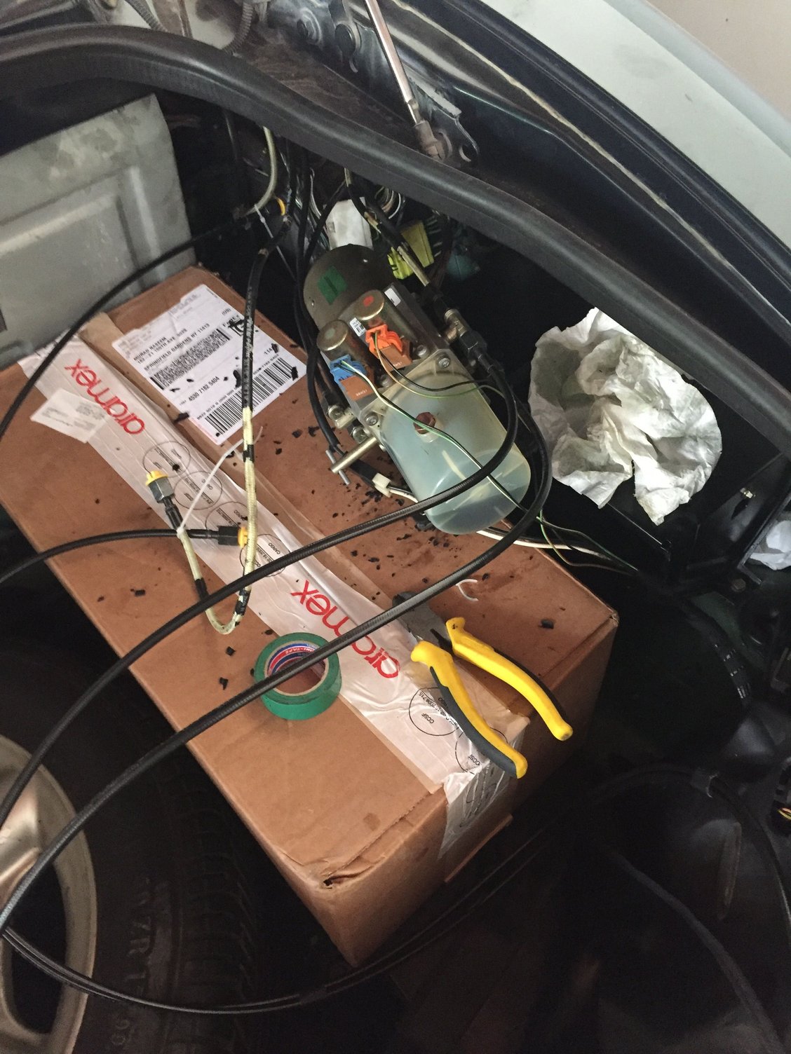

I tried to quick reply, but it looks like it needed moderator approval. There is definitely a leak near the latch, I feel hydraulic fluid in the lamp control. I’m going to take the car to my Jaguar mechanic on Monday, I don’t have time to mess with it now. I think he’s going to repair the hose, then I may replace it later.
EDIT: As far as I know the reservoir was almost empty when I bought it, there’s very little mess, not the “rain” others described. I just had 8 front bushings and all struts replaced, besides that the car is in great mechanical standing. : )
EDIT 2: I’ve attached a picture for those interested:

Glad you caught the leak early. Great photos in Frankc's link with the typically seen failure of a burst pipe at the fitting of the hydraulic line leading to the latch.
BTW did you get the quarter windows up? Skilimii mentioned jumping the circuitary (once you have the top up and fixed manually). See YouTube link below.
Two further things to consider
1. Quality of your mechanic's "patch" repair. If there's enough play in the pipe length, ask him if he's planning to cut the burst section off, and pulling on it to re-fit the threaded section onto a good bit of pipe. .
2. Alternatively if there's not enough play, he'll have to cut a length off and join with a new pipe. Worth noting that Jaguar did issue a TSB with a repair pipe "jointing" kit, but this was a failure and discontinued.
As Frankc rightly said, in the link he provided, it would be preferable to do a full replacement of the hydraulic lines to the overhead latch. Maybe worth considering that now as once the pipes start degrading, you're just asking for trouble. Maybe worth considering now just cleaning up the mess, which is DIY-able, and accepting that the hood is fixed until you get the replacement hydraulic lines. FWIW Maybe inspect all the pipes as you don't want to fix the latch lines, only to have the other pipes to the hydraulic rams burst later. If the pipes go at the pump, you'll have a green "wee" puddle on the floor at the rear right tyre, and for me the hydraulic fluid found it's way to all the stuff near the battery and made a real mess. Took ages to clean out, and caused all sorts of intermittent problems as the main battery ground is there too.
FYI There's a long term mitigation fix of putting a resistor on the pump's power supply lines, to moderate the pressure, to reduce the risk of blown lines. There's a YouTube video by the Rev. Sam. Link below. Looks simple enough but, to be fair, I haven't got round to that yet.
